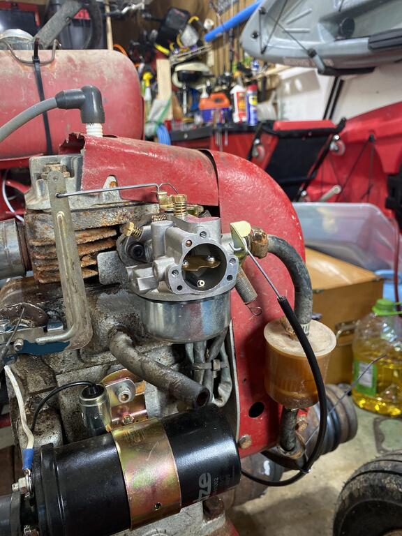

Sled Man 15 #1 Posted November 6, 2022 I replaced the carb on my K181 with a Carter #16 but the air filter housing doesn’t work. Any idea where I can get one to fit the new carb? If not I can make the old one work with some welding and drilling. 1 Share this post Link to post Share on other sites
Achto 32,106 #2 Posted November 6, 2022 That looks like the 3 screw pattern used on the big block carbs. Does your old base use the two hole mounting base with the extra mounting bracket off the back? Share this post Link to post Share on other sites

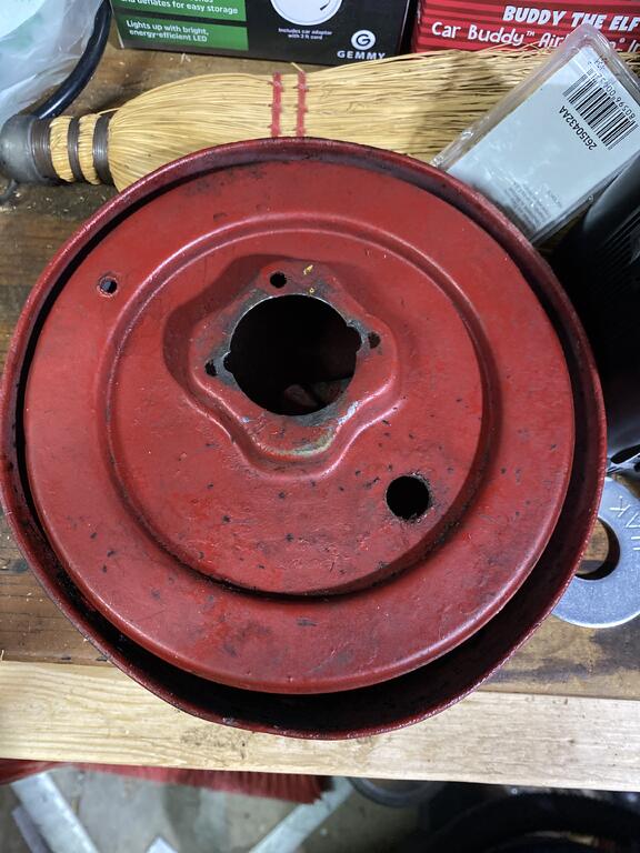

Sled Man 15 #3 Posted November 6, 2022 Here is the old housing. Basically the openning is too big so I found a washer I can use as a spacer/filler. Share this post Link to post Share on other sites

oliver2-44 11,632 #6 Posted November 7, 2022 (edited) 15 hours ago, Sled Man said: Here is the old housing. Basically the openning is too big so I found a washer I can use as a spacer/filler. That looks like a housing for the large block kohlers. You certainly can make it work with a spacer washer. i sugest you make a gasket for both sides of the washer to seal it. Also that larger hole in the lower left side of the plate is for a hose that some engines have going back to the breather cover (early emissions control) . If you are not using that hose I suggest you fill fill that hole as it would allow air to bypass the filter and allow dirty air to be sucked directly into the engine. Edited November 7, 2022 by oliver2-44 1 Share this post Link to post Share on other sites
