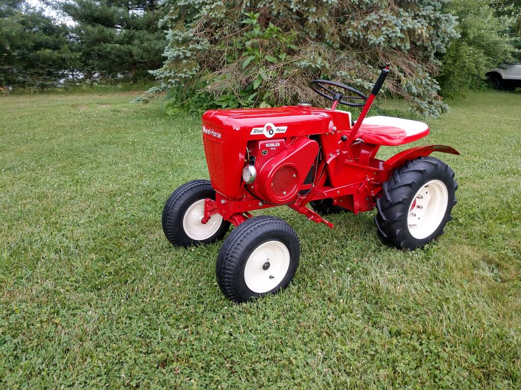

Darrenw85 745 #4 Posted November 6, 2022 I have some of my tractors powder coated. Usually frame, front axle, footrest, sometimes the engine tins, etc. The hood and other tractor tins are painted. The place that does my powder coating uses Ral 3003 for the red and Porcelain white from prismatic powders for the wheels. Posted is the paint code for the red paint I use. This color is very similar to IH red. The latest tractor I restored is posted for a reference for the colors. 1 1 1 Share this post Link to post Share on other sites
Dennis C. 142 #5 Posted November 7, 2022 Nice!!! Thanks for the info. Isn't the 1996 Toro Red a different shade than the rest of the model years? The only reason i want powder coat is that I get a good price on the application. I've stripped and painted a couple of Horses but I'm really not set up for a professional looking finish. Share this post Link to post Share on other sites
