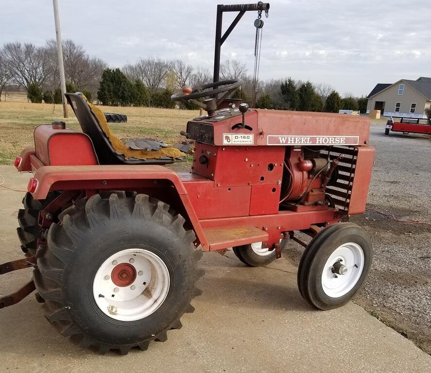

Pullstart 68,407 #4 Posted November 6, 2022 In similar fashion, I’ve adapted 5 lug hubs to a 953, originally with a heavy 4 lug hub. The tires on “Hot Wheels” are 27x10.50-12 Interco Interforce for a UTV. They look very classic for a tractor, but much deeper lugs. 2 Share this post Link to post Share on other sites

Pullstart 68,407 #6 Posted November 6, 2022 3 hours ago, BGH said: Those look great! Something similar to that is what I would like for the D200. These are simply C series 1-1/8” hubs and wheels, with the Interco tires on them. The axle keyway is 1/4” I believe and is cut straight through the hub. I’d imagine you can verify your axles are similar. 2 Share this post Link to post Share on other sites

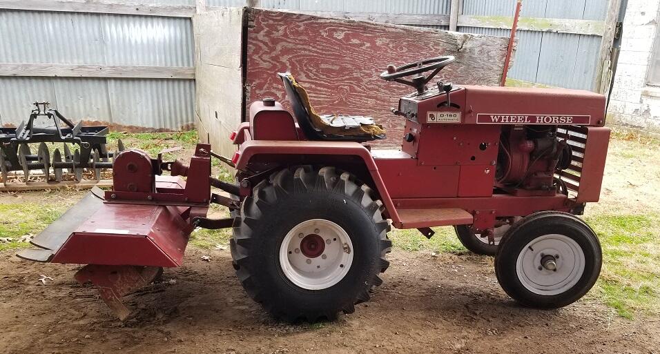

tractorhogg 612 #13 Posted November 8, 2022 I used cast iron dexter shorty hubs and put 3.75-12 steel wheels with 5.00-12 tri-ribs on the front and IntercoInterforce 30-10 x 12 rear AG tires 3 Share this post Link to post Share on other sites

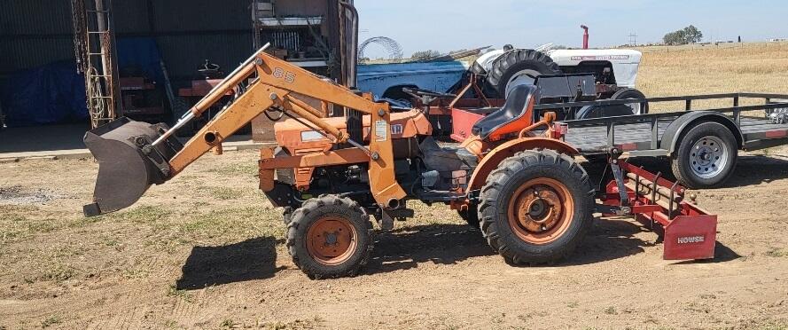

JoeM 9,064 #15 Posted November 8, 2022 13 hours ago, Pullstart said: The 520Xi is around the same weight and uses a 5 lug hub that would work fine. I had a D160 with a loader and it was nowhere near the power of any of my xi machines. Share this post Link to post Share on other sites
tractorhogg 612 #16 Posted November 8, 2022 6 hours ago, JoeM said: that would work fine. I had a D160 with a loader and it was nowhere near the power of any of my xi machines. Its why I got rid of my large frame Bolens 1886 with a loader, these loaders on garden tractors are just novelty toys. I still have my D series and 5-6 other big GTs but I for real work I picked up a Kubota B7100HST-D 4 x 4 with a loader and box blade Share this post Link to post Share on other sites
