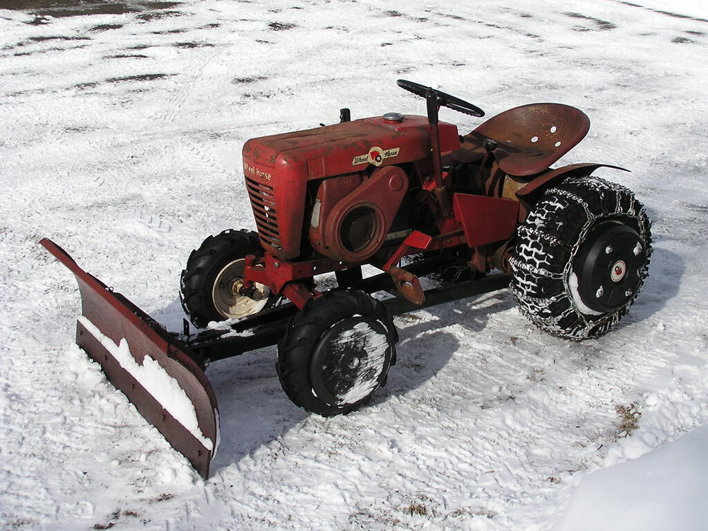

clueless 3,427 #1 Posted November 5, 2022 I have a 702 and a NOS Kohler M8 I'm thinking about putting it on the 702. I know the hood on the 702 needs to be longer and possibly higher. My question is will a 854 hood fit on the 702 without much modification? Share this post Link to post Share on other sites
kpinnc 18,741 #2 Posted November 6, 2022 I think the only consideration is the air cleaner. So how much different is the air cleaner for the K181? Share this post Link to post Share on other sites
ri702bill 12,475 #3 Posted November 6, 2022 (edited) I have run a 702 style hood on my 854 - to do so, you need to use the shorter 7HP air filter and cover. The three mounting points are the same, the 754 / 854 hood is 1 inch longer at the top to accomodate the 8HP air filter assembly. Edited November 6, 2022 by ri702bill 1 Share this post Link to post Share on other sites
clueless 3,427 #4 Posted November 6, 2022 3 hours ago, ri702bill said: I have run a 702 style hood on my 854 - to do so, you need to use the shorter 7HP air filter and cover. The three mounting points are the same, the 754 / 854 hood is 1 inch longer at the top to accomodate the 8HP air filter assembly. so the 753/854 will fit my 702 without any modifications? and if I put the 8 hp on it with the 702 hood I just need to put the shorter 7 hp air filter on it? 1 Share this post Link to post Share on other sites
ri702bill 12,475 #5 Posted November 6, 2022 (edited) That is correct....... Edited November 6, 2022 by ri702bill 2 Share this post Link to post Share on other sites
