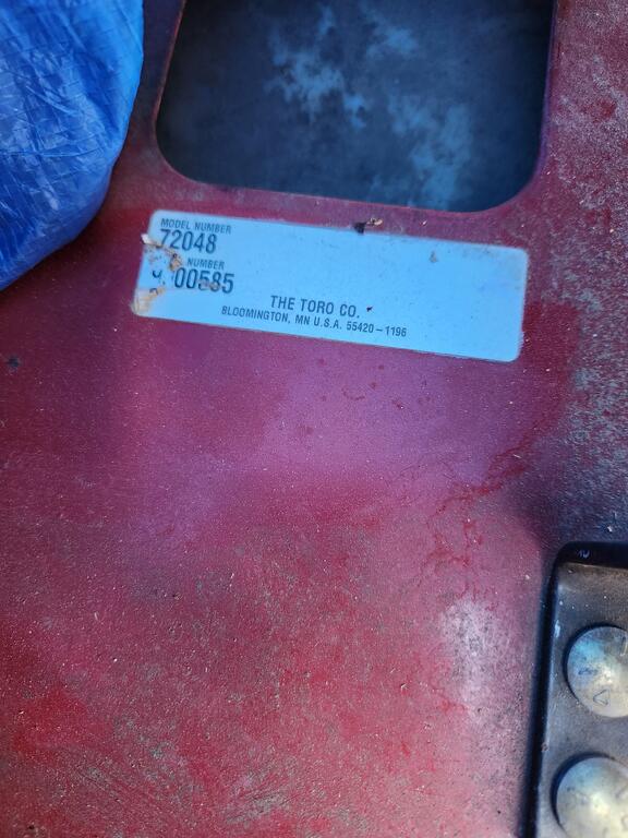

gwest_ca-(File Mod) 10,503 #2 Posted November 4, 2022 What is the model number and serial number of your tractor? 14 different 265-H's Share this post Link to post Share on other sites

gwest_ca-(File Mod) 10,503 #9 Posted November 4, 2022 The full serial number is 9900585 so record that for the future. Download these diagrams. Best to print out pages 2 and 3 so they can be placed side by side. The rest of the drawings are individual circuits making it easier to understand. Also realize these diagrams are only 1/2 of the circuit - the other half is the grounds and are required to complete the circuit.. 1 Share this post Link to post Share on other sites
