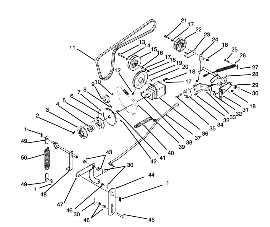

sttereve 30 #1 Posted November 3, 2022 Long time lurker, first time poster here. Recently got a 2 stage snowblower off a guy on craigslist. Picked it up partially disassembled so I figured there would be something missing, and now that I've got it hooked up it looks like I am missing the lift "pivot" (not sure what its called) that hooks up to front attachment point. Looks like I need 47 and 48 in the parts diagram (pn 117543 and 116906). Any ideas where to find these? Starting to figure I'll need to cobble something together... Anyone know the dimensions? 1 Share this post Link to post Share on other sites

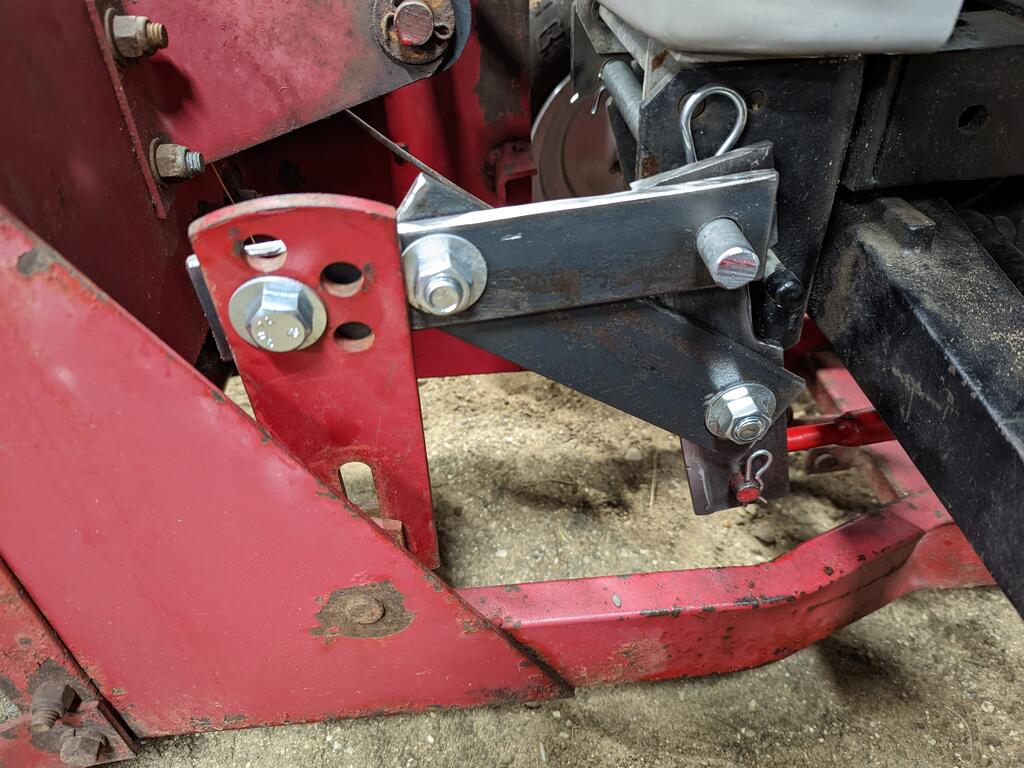

sttereve 30 #2 Posted November 6, 2022 Well I was able to cobble together something from some scraps I had around. I think this should work ok. One of these days I really need to get a welder... 3 Share this post Link to post Share on other sites
peter lena 10,090 #3 Posted November 6, 2022 @sttereve not that bad , go over all your intended movement points with red aerosol grease , for ease of application and tight spots , have someone else use the lift point so you can follow function and improve ease of use . did a 2 stage over a few years back , it was basically frozen with rust , went after every spot , till it moved with ease . pete Share this post Link to post Share on other sites
Crobson 20 #4 Posted November 11, 2022 (edited) I may have to copy that. Trying to fit a very similar blower onto my 520h, not entirely sure if the hydraulic cylinder is double acting. Weather went to crap before I could check it today. Edit: Did you attach the lift spring to the end of the rod? Edited November 11, 2022 by Crobson 1 Share this post Link to post Share on other sites
sttereve 30 #5 Posted November 12, 2022 This does seem to work decent. Would probably be helpful if you can get the original part dimensions. I did some approximation and got lucky. The attachment plate has 4 holes which gives you some flexibility after to adjust. I haven't done anything with the lift spring yet. What's the general consensus on needing it when using the hydraulic lift? I guess I feel like it's probably not necessary. 1 Share this post Link to post Share on other sites
Crobson 20 #6 Posted November 13, 2022 I'd not object to adding the spring, if only to partially balance the stresses on the hitch and frame. Ideally, I'd want a setup like truck plows use, where it lifts evenly from above by a single hydraulic cylinder. The OEM "spring assist lever" has an offset mount for the spring, so it can be easily slipped on and the lever moved to tension it. I'm unsure if the offset would lift the spring end higher than the hitch bar, or if i can just attach it the hard way to that bar. 1 Share this post Link to post Share on other sites
R Scheer 525 #7 Posted November 13, 2022 If I do not put the spring on, my blower lifts with a definite tilt. The left side will be about 2 inches higher than the right. I don't know if it matters, but I think the linkages might start to wear unnecessarily. Share this post Link to post Share on other sites
Red-Bovine 337 #8 Posted November 13, 2022 The lift spring definitely helps. We've had that blower since 1995 on our 520H. Nice job on the fabrication, BTW. 1 Share this post Link to post Share on other sites

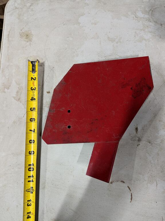

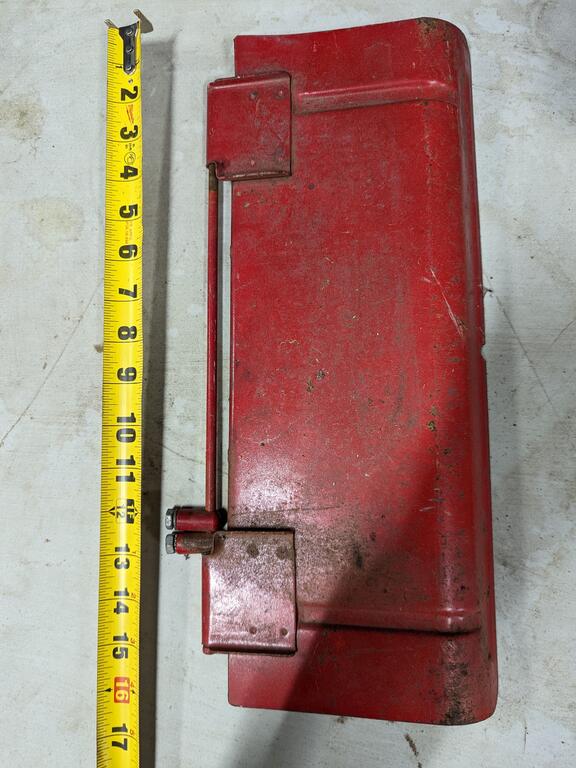

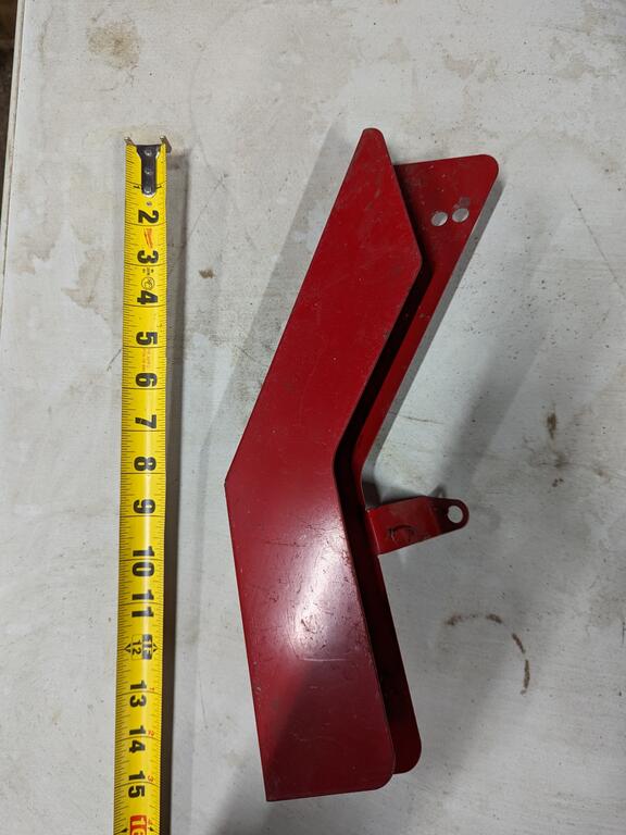

sttereve 30 #9 Posted November 13, 2022 Thanks for the info on the spring, I'll have to get that on there next time I hook this up. When I got this blower I also got some misc parts that I have no idea what they are for. Any ideas? I think one is a pulley cover for a tiller idler. But no idea on the others 1 Share this post Link to post Share on other sites

wallfish 20,663 #13 Posted November 16, 2022 Yes that spring #50 helps keep the lift of the blower even and supports that side. #40 spring probably isn't needed with hydraulic lift but I put it on anyway I should have my blower tractor out this weekend and can get you guys some pics and dimensions of those lift parts And @Crobson, don't under estimate those toothpicks! LoL Have a look see 1 Share this post Link to post Share on other sites

sttereve 30 #15 Posted November 18, 2022 (edited) Well western Michigan is giving me quite the opportunity to test this haha. Definitely needed the spring there to balance it out. even with the spring its a little lopsided. I think the factory setup has a tensioner that pulls the chain further. May need to do something for that... Also this thing is HEAVY, lots of tire slip where I never had issues with the single stage. I have ATV tires with weights but its not cutting it. Trying to decide if chains or more weight will help more? Edited November 18, 2022 by sttereve 1 Share this post Link to post Share on other sites

Crobson 20 #18 Posted November 19, 2022 I had one of those "flash of genius" moments that might just be gas. Summer project, tbh. One solution to the lifting force being lopsided is to manage to lift evenly from both sides. Option one is to get a second #44 lift link, and duplicate the #47 you made, and weld them both to the bolt shaft. They should both turn at the same time, evenly lifting. Option B is to replace both #44 and 47 with a cable system, with a pulley on each end of the rod, and both cables going to the lift crank arm. One or both would need a turnbuckle to adjust, or chain for the last foot or so. Side note for those who aren't listening to archives of Car Talk, "Option 1" and "Option B" are one of their inside jokes. 1 Share this post Link to post Share on other sites

Bow_Extreme 584 #22 Posted November 29, 2022 On 11/13/2022 at 2:00 PM, sttereve said: Thanks for the info on the spring, I'll have to get that on there next time I hook this up. When I got this blower I also got some misc parts that I have no idea what they are for. Any ideas? I think one is a pulley cover for a tiller idler. But no idea on the others Top 2 are for a tiller system. Top is pulley cover and middle is belt cover. Not sure what the 3rd is. Share this post Link to post Share on other sites
