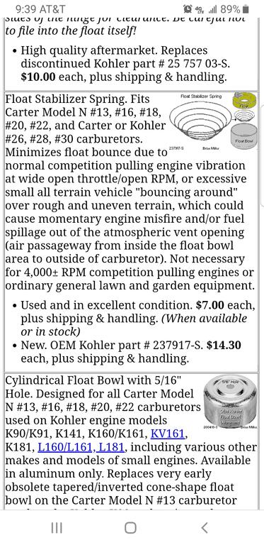

gt14rider 1,278 #2 Posted November 3, 2022 A-1 miller performance has a spring for the float Share this post Link to post Share on other sites
Jeff-C175 7,211 #3 Posted November 3, 2022 44 minutes ago, gt14rider said: A-1 miller performance has a spring for the float Thank you Sir! That EXACTLY describes the issue I'm having with this, actually 2 of these, engines! I'm going to try adjusting the float a little lower first, if that doesn't help, I guess I'll spring for the spring. 2 Share this post Link to post Share on other sites

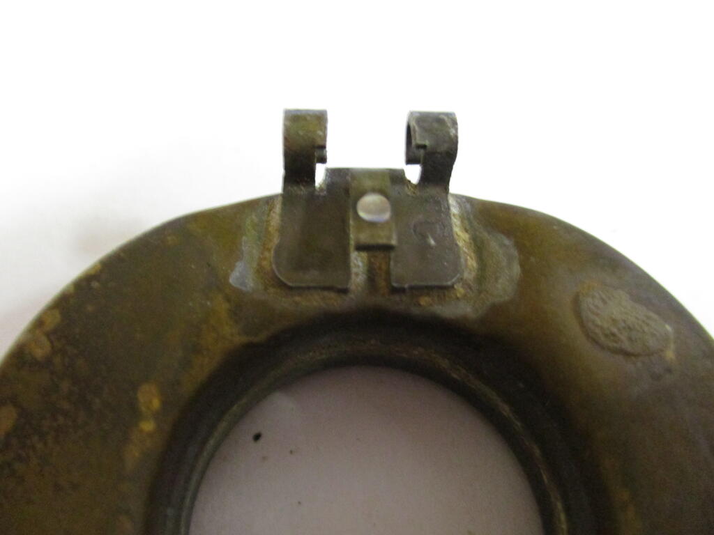

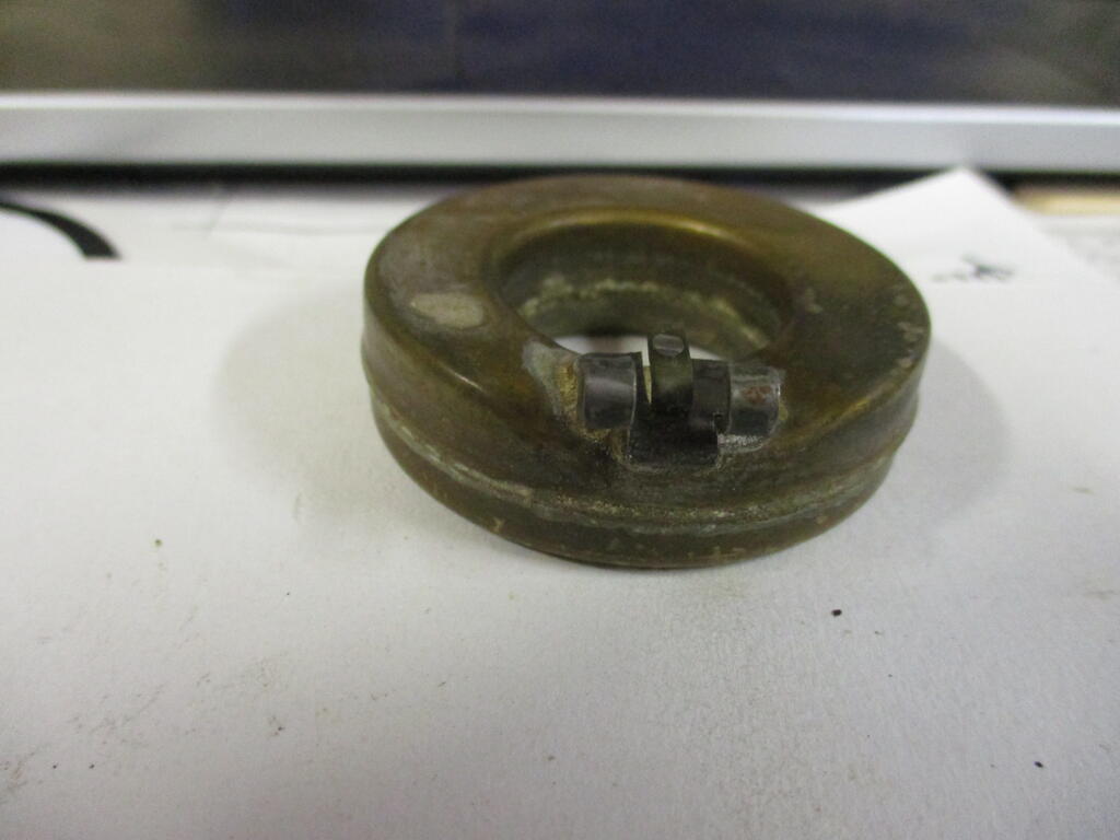

Jeff-C175 7,211 #10 Posted November 3, 2022 Do not all floats have the tab to adjust the 'drop' ? There is no such tab on this float, thought it may have been broken off, but there is no evidence it ever existed. 1 Share this post Link to post Share on other sites
pfrederi 21,051 #11 Posted November 3, 2022 Never seen a afloat with out the tab.. could explain your problem float level would have been my first check with this issue... 1 Share this post Link to post Share on other sites
Jeff-C175 7,211 #12 Posted November 3, 2022 8 minutes ago, pfrederi said: with out the tab.. could explain your problem There IS a tab to adjust the UPPER... the tab that seems to be non-existent is the one that the instruction calls for the DROP, or the LOWER limit. 1 Share this post Link to post Share on other sites
Snoopy11 5,731 #13 Posted November 3, 2022 Let me provide something. Jeff, this is a k-301 carb float... that has both tabs... I do know that some stens floats do not come with both tabs... some do not come with either!!! I have a place here in Indiana where I can pick up the correct float like the one above, if need be. Don 2 Share this post Link to post Share on other sites
pfrederi 21,051 #14 Posted November 3, 2022 (edited) just looked a at 2 #30 carbs on my bench neither one has the lower level drop tab Edited November 3, 2022 by pfrederi 1 Share this post Link to post Share on other sites
