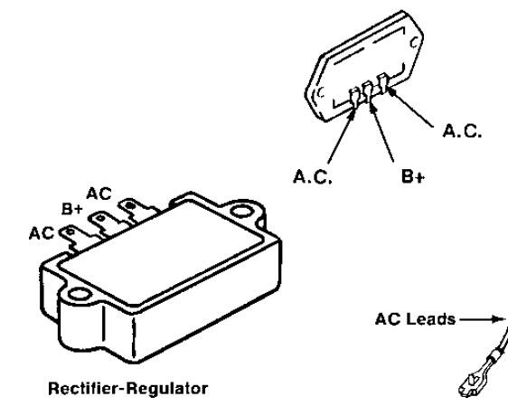

Toolmanbill 44 #1 Posted November 2, 2022 (edited) Still haven’t resolved the no spark issues yet but while trying every connection that I can find I had trouble with the connector that goes to the rectifier.when I unplugged it all the wires came out of the connector and I don’t know how they go back.can anyone shoot me a picture or tell me what order they go in?also if I have intermittent spark does that tell if it could be an ignition coil or a stator issue? model 73400 serial 4901795 Edited November 2, 2022 by Toolmanbill 1 Share this post Link to post Share on other sites

gwest_ca-(File Mod) 12,489 #3 Posted November 2, 2022 There is a tab on the back of each terminal that may need to be bent out to lock it in place. To remove a terminal from it's holder you collapse the tab. The AC stator leads are the same so no order required. Share this post Link to post Share on other sites
