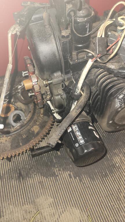

RED-Z06 2,720 #8 Posted November 6, 2022 (edited) Easiest way is to pull the pump, then pull the rear cylinder cover...its tedious but not impossible, then use long pliers to put the hose back into the pump....then attach the pump. Here's what you're dealing with under it all.. Edited November 6, 2022 by RED-Z06 1 Share this post Link to post Share on other sites
