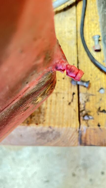

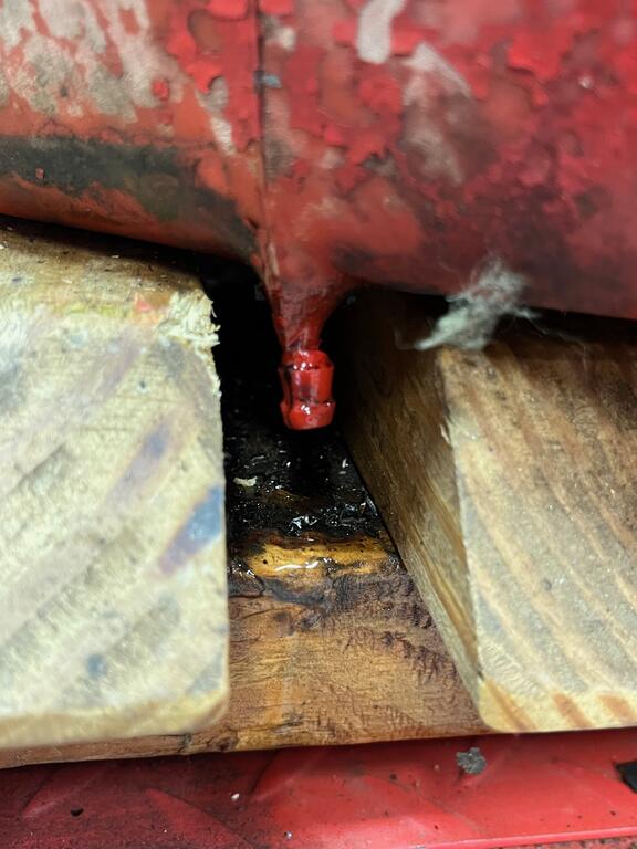

Kibbie01 28 #39 Posted December 10, 2022 Thanks guys. I cleaned and set the points. Fires up now. I did however take the last bolt off and dropped the grill and the gas tank. Now the gas tank “nozzle” has a crack in it right at the tank. Any suggestions on how to fix that? 1 Share this post Link to post Share on other sites

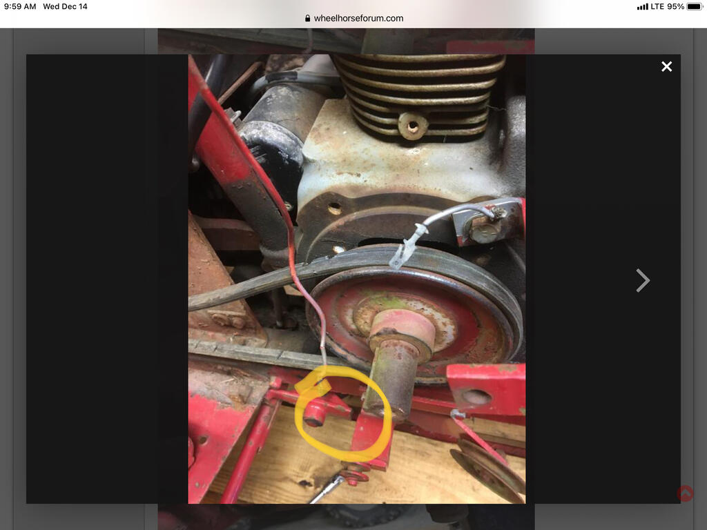

Kibbie01 28 #46 Posted December 14, 2022 You know of anyone that has an electric PTO clutch for the deck? I think I am missing a spindle or something as well. Looks like there is a shield that covers the deck belt that is also missing. 1 Share this post Link to post Share on other sites

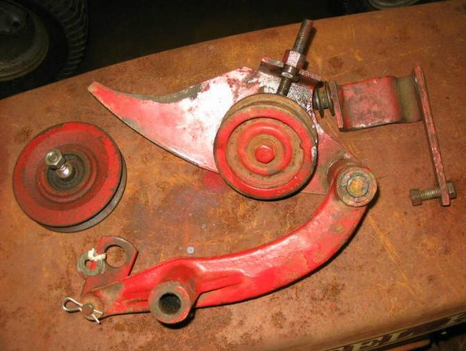

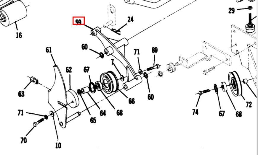

daveoman1966 3,883 #48 Posted December 14, 2022 I think thyis is the arm you need...PIVOT ARM 6725 I have one, but it was broken and has been BRAZE WELDED. It should work ok. $30 bux for it...shipped. This pic shows the side mule drive from an old Bronco 14... same part # 6725 for the GT-14. Share this post Link to post Share on other sites
