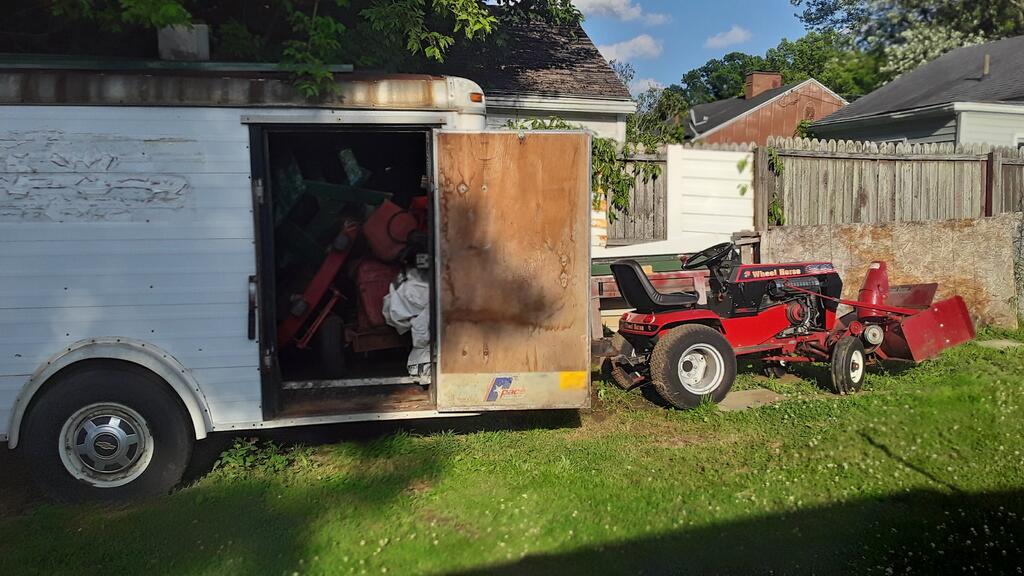

Duramax7man7 506 #1 Posted October 31, 2022 I have a 7x12 Cargo trailer I've been wanting to pull into the backyard on account of Dipstick city ordinances not allowing to be in the front of my property. Am trying to avoid using my diesel 2500 because of my Dipstick Neighbor claiming I'm trespassing by using 4-5 feet of their grass in between our houses to get a good angle going into the backyard. The Cargo trailer is tandem axle and weighs about 2200lbs with my Motocross bike and gear in it. I have a hitch bracket from Lowell (the Hitch Guy?) on the tractor now with a 6" drop hitch installed up-side-down. Anyone know the max towing capacity of the 520h? Obviously it's going to put stress on the transaxle the most, which is my primary source of concern. Andrew 1 1 Share this post Link to post Share on other sites

Duramax7man7 506 #18 Posted November 1, 2022 I'm sure it will be fine and I'm going to be recording everything in a few... I'll try and post it up to my youtube channel. Meanwhile... Feel free to poke around in it. Got quite a few playlists including repair and operation wheel horse videos and a bunch of Powersports, Sledding (Both Repairs and Restores & Upnorth Trips) and Motocross riding from this season and last season. Yes including my wrecks. ha ha. https://www.youtube.com/c/AndrewCrocker-Fixin2Ride/playlists Share this post Link to post Share on other sites

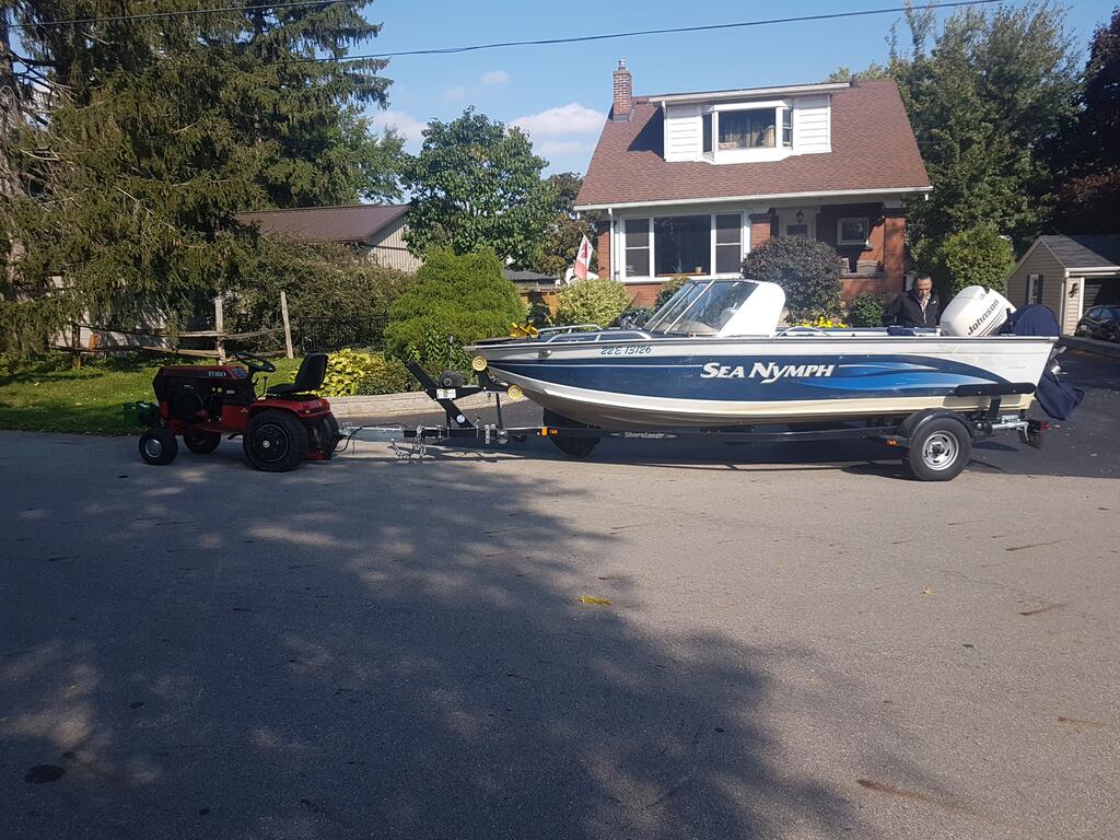

R Scheer 524 #20 Posted November 2, 2022 The only thing I can add is to wait until you have a dry spell before pulling the trailer over the grass. Soft soil really adds a lot of drag, you can hear the extra work the hydro has to do. Going to Mobil 1 also seemed to help. Here's my 312H, (same hydro as yours), pulling my brothers 19' outboard. I'm guessing the boat weighs in about 3000 lbs. 1 Share this post Link to post Share on other sites

Duramax7man7 506 #22 Posted November 2, 2022 Not a long video but you can see the job done... Share this post Link to post Share on other sites

WHGuy413 2,859 #25 Posted November 3, 2022 Certainly looks like it handled it with no problems at all. 1 Share this post Link to post Share on other sites
