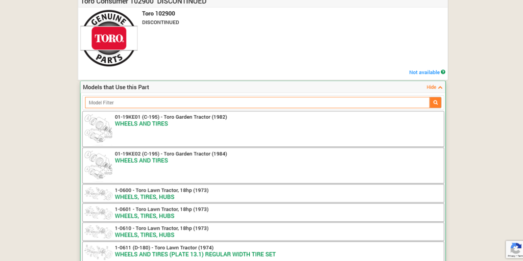

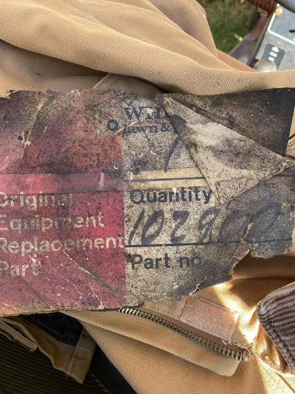

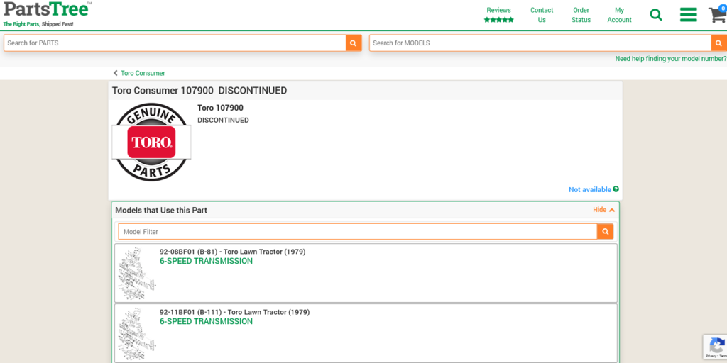

1995 520H+96+97 939 #3 Posted October 30, 2022 (edited) 107900 is a idler, 102900 is a wheel. Edited October 30, 2022 by 1995 520H+96+97 Share this post Link to post Share on other sites

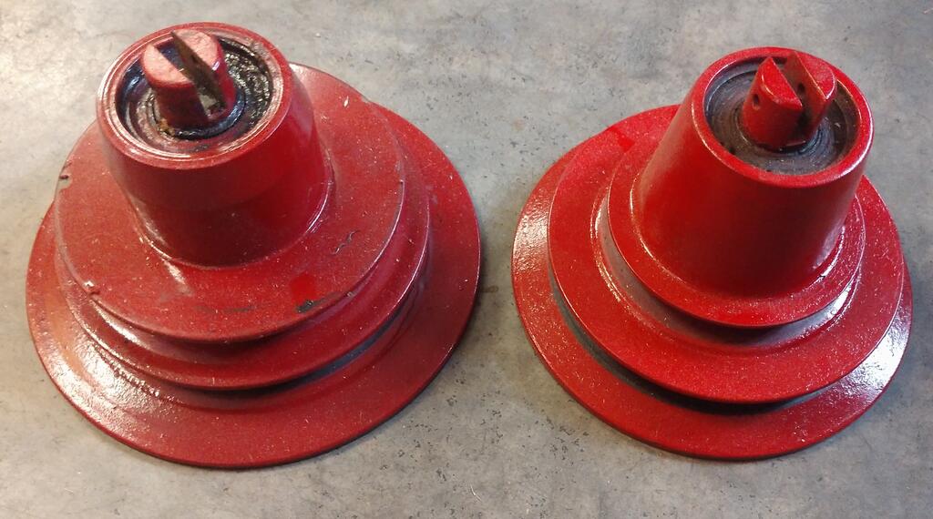

kpinnc 18,740 #4 Posted October 30, 2022 Seems like the "old style" PTO clutch face. I don't know the exact year range, but the older (maybe 1960-ish to 1973?) used a smaller diameter PTO. I may be wrong, but I think everything after C-series used 6 and 1/4 inch. 2 1 Share this post Link to post Share on other sites
Sparky-(Admin) 25,934 #5 Posted October 30, 2022 50 minutes ago, kpinnc said: Seems like the "old style" PTO clutch face. I don't know the exact year range, but the older (maybe 1960-ish to 1973?) used a smaller diameter PTO. I may be wrong, but I think everything after C-series used 6 and 1/4 inch. Maybe it’s for the 8HP units? B-80’s and the like. Smaller HP = smaller clutch face?? Share this post Link to post Share on other sites

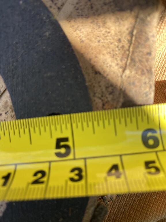

elcamino/wheelhorse 9,363 #6 Posted October 30, 2022 Just got a replacement clutch face for a 1972 Commando 800 (8 HP ) and it measures 6 inches . Share this post Link to post Share on other sites
kpinnc 18,740 #7 Posted October 30, 2022 (edited) 37 minutes ago, Sparky said: Maybe it’s for the 8HP units? B-80’s and the like. Smaller HP = smaller clutch face?? Yes but the early PTOs were smaller in general. Old style on the right below. Both my Bronco and a couple Chargers I've had came with these on them- I assume as replacements for the electric PTOs by a previous owner. This is also the size that was on the older PTO kit from the 60s. Edited October 30, 2022 by kpinnc 2 Share this post Link to post Share on other sites

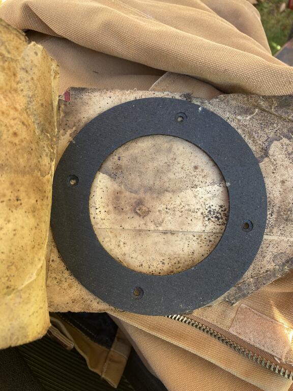

gwest_ca-(File Mod) 12,346 #8 Posted October 31, 2022 Looks like the early 4365 has 6 rivets https://www.partstree.com/parts/toro-4365/ Share this post Link to post Share on other sites
