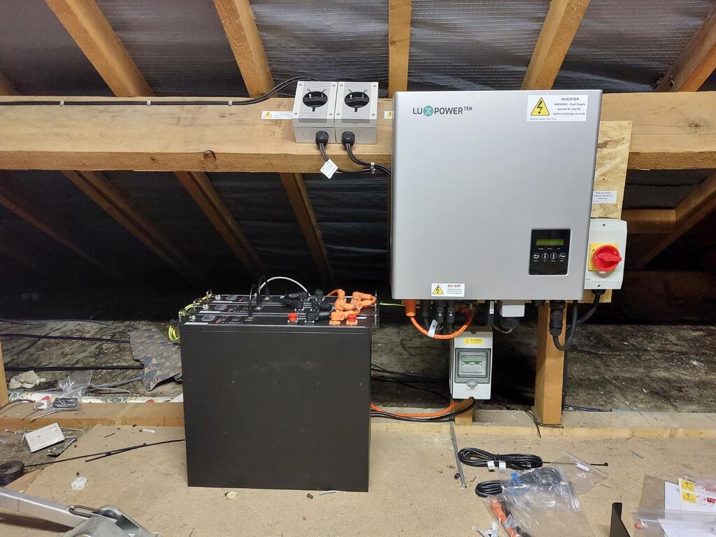

Mickwhitt 5,259 #9 Posted November 1, 2022 This is the electrical equipment in my loft space for our new solar panel array. The inverter turns the DC into AC and feeds it to the house or batteries. we have 20 panels each producing 320 kW. So its a pretty big system all in all . no idea how it works, but it does. 2 1 Share this post Link to post Share on other sites
Sailman 1,307 #10 Posted November 5, 2022 Have been doing some experimenting and research on the solar charging. I have the HF 100 watt panel with its own controller that's connected to a simple 12 volt marine battery (deep cycle). Panel keeps the battery topped up (charging at 13+ volts). Then I connect additional supplied connector to keep my 2 tractors and dirt bike batteries charged (move from one to the next periodically). Battery also runs a 12 volt light set so I can use the barn after dark. Works great for small system. The bigger systems like mickwhitt take a much more sophisticated set up but still basic parts are; 1. Solar panels 2. Controller between panels and batteries (moderate charge to batteries, limit overcharge and draw down) 3. Batteries (need multiple lithium or other high amp storage capacity batteries....$$$ 4. Inverter that takes the battery DC and coverts it back to AC for household outlet use. 5. Multiple solar panels and multiple batteries can be configured in series AND parallel to increase efficiency and reduce the size of wire needed. ( Do your own research on this one....) Things to keep in mind; Your electrical consumption will be limited by the amount of power stored in the batteries. The solar panels simply keep the batteries charged. Bigger batteries, more usable power to your AC outlets and bigger $$$. Couple other things; Monocrystalline Solar Panel cost more and typically have higher output but have reduced output in less than full sun. Amorphous Solar Panel costs less and has lower output but they amazingly work in low light situations too. Bottom line is Solar is affordable for small applications like charging batteries, power outage backup for a few essential electric appliances, etc but trying to power lots of house appliances can run into big bucks for the system. The newest option I highly recommend for small applications (portable AC power, camping, etc) are the Jackery Portable Power Stations. Great because they combine the battery, controller and inverter all in one package. Just add solar panels for charging (other charging options included) and its a small self contained unit. Hope this adds some insight for folks. 4 Share this post Link to post Share on other sites
