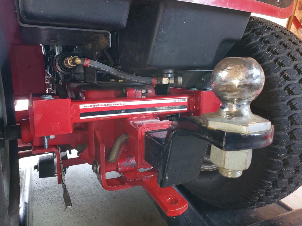

Racinbob 13,286 #6 Posted October 30, 2022 An electric pump is great especially with the tank under the seat models. Mr Gasket #42s 2-3.5 psi, 28 gpm. Mounted as close to the tank as practical for minimum draw and maximum push. It's ben flawless. 2 1 Share this post Link to post Share on other sites
Lane Ranger 12,161 #7 Posted October 30, 2022 14 minutes ago, Racinbob said: An electric pump is great especially with the tank under the seat models. Mr Gasket #42s 2-3.5 psi, 28 gpm. Mounted as close to the tank as practical for minimum draw and maximum push. It's ben flawless. Bob. Did you remove the original fuel pump first when doing this? And how did you wire up the pump? I have a 314 hydro that seems to loose prime in the gas line (my fuel pump may be weak). And I have been thinking about putting an electric fuel pump on. Share this post Link to post Share on other sites
Wvtroutbum81 327 #8 Posted October 30, 2022 25 minutes ago, Racinbob said: An electric pump is great especially with the tank under the seat models. Mr Gasket #42s 2-3.5 psi, 28 gpm. Mounted as close to the tank as practical for minimum draw and maximum push. It's ben flawless. Where did you get that hitch? Share this post Link to post Share on other sites
Racinbob 13,286 #9 Posted October 30, 2022 (edited) 28 minutes ago, Lane Ranger said: Bob. Did you remove the original fuel pump first when doing this? And how did you wire up the pump? I have a 314 hydro that seems to loose prime in the gas line (my fuel pump may be weak). And I have been thinking about putting an electric fuel pump on. I did not remove the original pump Lane. My thought process was that it would help control the fuel flow and pressure to what the engine was designed for. Then it was suggested to me to bypass the original pump because the electric pump might blow the diaphragm on and pump fuel directly into the engine. I guess that's possible It's been on there for over 3 years now so I might be on borrowed time. My biggest issue was that if the tractor sat for a few days the tank is so low it took some time to get the fuel back. As far as wiring the mow in reverse keyswitch on the side of the seat seems to have fallen off . There was a wire right there that was hot when the ignition was on and fused under the hood. Perfect. 19 minutes ago, Wvtroutbum81 said: Where did you get that hitch? Wheelhorse Parts and More - RedSquare Wheel Horse Forum I have one on my 76 and this 2005. I love them. Edited October 30, 2022 by Racinbob 1 Share this post Link to post Share on other sites
