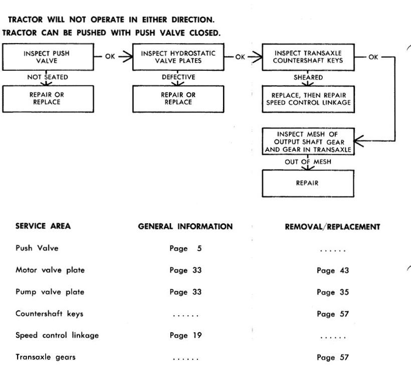

pfrederi 21,172 #6 Posted October 28, 2022 Download the sunstrand manual here I am betting on sheared key in transaxle ... 1 Share this post Link to post Share on other sites
JSW 9 #7 Posted October 28, 2022 Thanks pfrederi,great manual! I think you are right on about a sheared key---looks like a complete tear down of the trans axle in order to find out for sure or is there any tests i can make without a tear down?. I'll let you know what i find. Thanks again! JSW 1 Share this post Link to post Share on other sites
953 nut 69,476 #8 Posted October 28, 2022 8 hours ago, JSW said: is there any tests i can make without a tear down? Begin with the axle to hub keyways. Mark the end of the axle and the hub on each side with chalk, paint or whatever you have on hand. Start the engine, put it in gear for a few seconds and then take a look at the marks you made. If a key is broken the line will no longer be aligned. 2 Share this post Link to post Share on other sites
