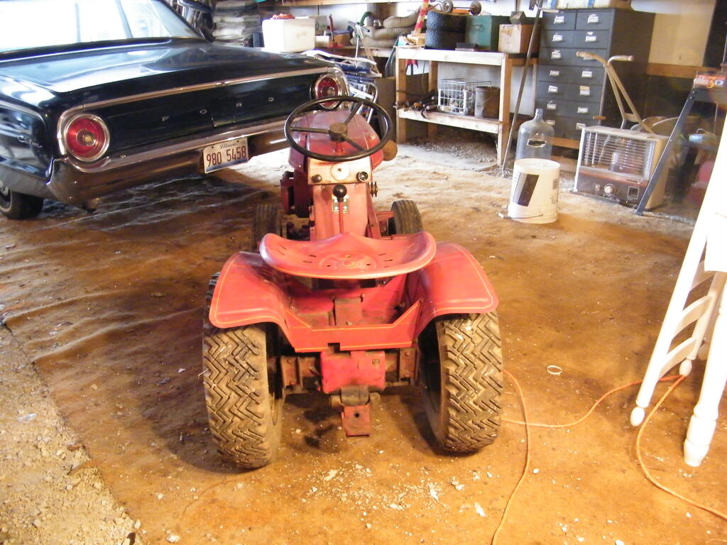

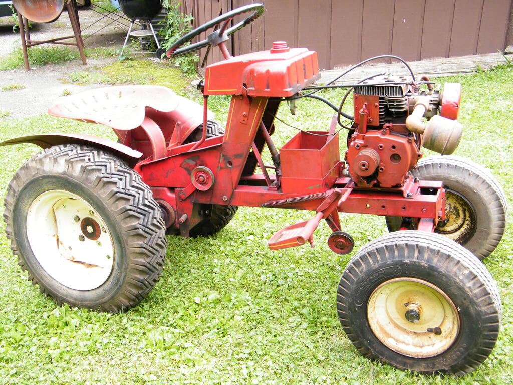

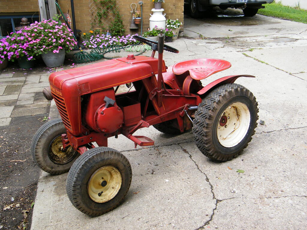

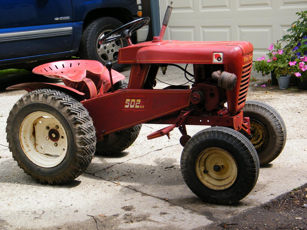

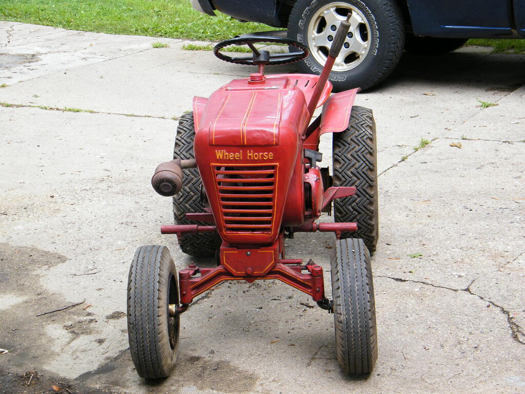

stevasaurus 23,742 #28 Posted October 25, 2022 (edited) This is an original 502. It was my Dad's. One piece tank, 13 hole round seat (the square seat was on the 702), no battery, but came with the rare tool tray where a battery would go, these are the original tires and the engine was a HT55C-3088P recoil 5.5 HP, had the 5025 transmission. The serial # on this is 62-18107. I'm not picking Jim's apart, it's hard to find the HT44C-3088P engine anymore and that tool tray is rare. Just saying what is original if Jim is going to try to make it original again. Edited October 25, 2022 by stevasaurus 3 6 Share this post Link to post Share on other sites

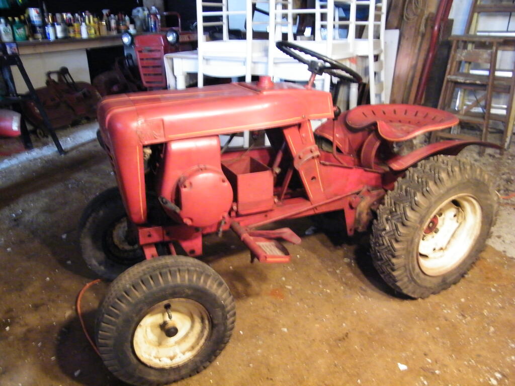

Achto 32,095 #34 Posted October 26, 2022 (edited) 5 hours ago, stevasaurus said: Looks like the tool box clamped into the battery tray. Would I be correct to guess that all the 62 models came with the battery tray welded in place and the tool box was an option for the pull start models? Edited October 26, 2022 by Achto 1 Share this post Link to post Share on other sites
WHX?? 57,384 #35 Posted October 26, 2022 Me thinks that is a PO thing Dan??? Share this post Link to post Share on other sites
Handy Don 16,942 #36 Posted October 26, 2022 1 hour ago, Achto said: Looks like the tool box clamped into the battery tray. Would I be correct to guess that all the 62 models came with the battery tray welded in place and the tool box was an option for the pull start models? I've heard that here and it sure makes sense to make it seem like a benefit instead of an afterthought, right? 1 Share this post Link to post Share on other sites

stevasaurus 23,742 #41 Posted October 26, 2022 @Achto, yes, the part that holds the battery was welded, the tool tray came with the 502. Remember, the 502, 552 and the 702 had the same frame, steering, tires. Two came with batteries, one had the tool tray. It would be easy to make one. @gwest_ca would know more about the Serial Numbers of the horses from that year. I think somedays they did 502's, some days they did 702's, and the same for the 552's. About the seat...I could swear I have seen a Manual for the 502,552,and 702 that showed the 502 with the round seat and the 702 with the square seat on the front, and the parts list reflected that. I can't find that Manual showing that now. Maybe, I am mistaken about that and you could order either seat. One thing though, a good 13 hole round seat is getting hard to find. @joebob may know more about an original 502?? 3 Share this post Link to post Share on other sites
WHX?? 57,384 #42 Posted October 27, 2022 On 10/26/2022 at 10:17 AM, stevasaurus said: @joebob may know more about an original 502? He looked it over and said he thought it was all orginal. Share this post Link to post Share on other sites
joebob 52 #43 Posted October 27, 2022 4 minutes ago, WHX?? said: He looked it over and said he thought it was all orginal. Except for the teccy, would have to have a lauson with a oil pump sump, you can see it in steves photos under the pto 1 1 Share this post Link to post Share on other sites

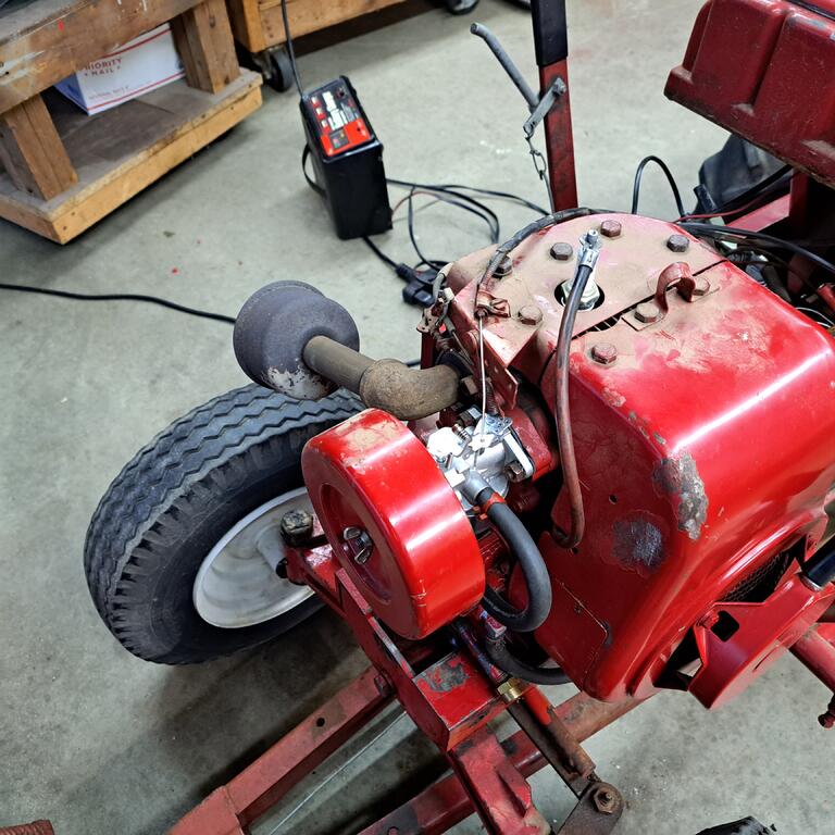

WHX?? 57,384 #44 Posted November 4, 2022 (edited) Ordered and put on a 12 clam fleabay carb today. Once I got her dialed in runs sweet. Best running Tecky I got! Say what you want about the cheapy Chinese knock offs but this is the second one I got. First one was for a 12 Kohler and good luck with that too. Don't go by the manual on the settings tho ... sweet spots were 3 turns out on idle and only maybe one full turn on the main. Really plug & play tho once I got that fingered out. Some new charging diodes and this one is ready to run. Edited November 5, 2022 by WHX?? 2 3 Share this post Link to post Share on other sites
