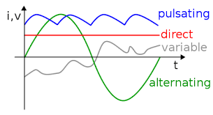

953 nut 66,058 #28 Posted October 24, 2022 9 hours ago, Snoopy11 said: That is really the basis of my question... what is the voltage range at regulator output terminal? What should we be looking for? What we all call a voltage regulator is in reality a rectifier, it converts alternating current into pulsating direct current. The AC from your stator is variable with engine RPMs and the DC reading will be directly proportional to the AC voltage. There are two diodes in the rectifier, one will pass the positive pulse of the AC and the other will convert the negative pulse into positive pulsation giving you pulsating DC. These pulsations occur so rapidly that they are undetectable without the use of an oscilloscope. The DC voltage will be an average of the highest and lowest points of the pulsations. Since the stator produces about 36 volts AC and more than half is lost in the process of rectification you can expect to see no more than 15 no-load volts reading on the DC output. https://en.wikipedia.org/wiki/Rectifier 3 Share this post Link to post Share on other sites

lynnmor 8,827 #32 Posted October 24, 2022 1 hour ago, 953 nut said: What we all call a voltage regulator is in reality a rectifier, it converts alternating current into pulsating direct current. The AC from your stator is variable with engine RPMs and the DC reading will be directly proportional to the AC voltage. There are two diodes in the rectifier, one will pass the positive pulse of the AC and the other will convert the negative pulse into positive pulsation giving you pulsating DC. These pulsations occur so rapidly that they are undetectable without the use of an oscilloscope. The DC voltage will be an average of the highest and lowest points of the pulsations. Since the stator produces about 36 volts AC and more than half is lost in the process of rectification you can expect to see no more than 15 no-load volts reading on the DC output. https://en.wikipedia.org/wiki/Rectifier I think you will find that the regulator rectifier actually regulates the voltage and is not just a simple bridge rectifier. Until someone does an autopsy on a failed one we don't know for sure. You might find that the excess current is shunted to ground to maintain the proper voltage. 3 Share this post Link to post Share on other sites

Handy Don 16,595 #35 Posted October 24, 2022 (edited) 3 hours ago, 953 nut said: more than half is lost in the process of rectification The regulator is more than a pair of diodes, of course. Its circuitry also compares the "charging" voltage to the "battery" voltage and prevents "over voltage" to the battery (this effort soaks up some current which becomes heat--that's where part of the "half lost" is going and is why the VR needs those cooling fins). Edited October 24, 2022 by Handy Don 1 Share this post Link to post Share on other sites
