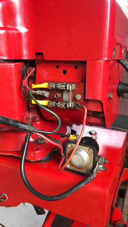

Lman 14 #1 Posted October 22, 2022 (edited) I'm trying to restore my first lawn tractor, it's a 1975 A-80-E with a Tecumseh VM80 engine. Starter motor works, engine turns over but does not fire. New spark plug gets wet, but does not appear to spark. I downloaded everything useful I could find, but I don't have all the tools. Before I take the flywheel off to check the points, what other things should I try? Is there an ignition cut-off wire I can try and disconnect? I have a hard time understanding the wiring in the picture below. What does it all do and where is (+) and (-)? Edited October 22, 2022 by Lman Share this post Link to post Share on other sites
ri702bill 11,545 #2 Posted October 22, 2022 I believe that is the diode setup for the charging system.... 1 Share this post Link to post Share on other sites

Lman 14 #4 Posted October 22, 2022 (edited) Thank you very much, so that's the battery charger. Much obliged for the wiring diagram, that's gold! Dad and I used this mower for years without a battery. If only we knew we should have removed the diodes. Could not doing this have caused damage? Edited October 22, 2022 by Lman Share this post Link to post Share on other sites
