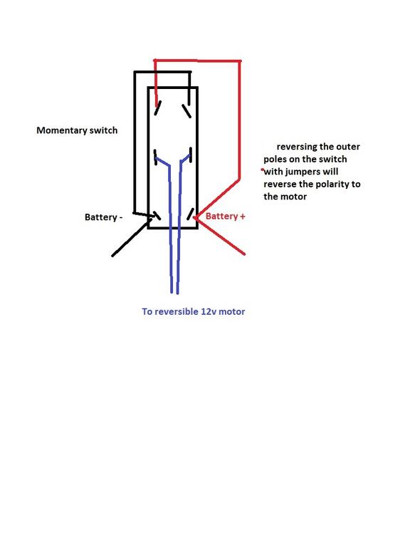

ri702bill 12,803 #2 Posted October 22, 2022 Interesting idea. The toggle switch would need to be a 3-position style - OFF in the middle, right to rotate to the right, left for the opposite. Momentary return to center like a car power window switch?? 2 Share this post Link to post Share on other sites

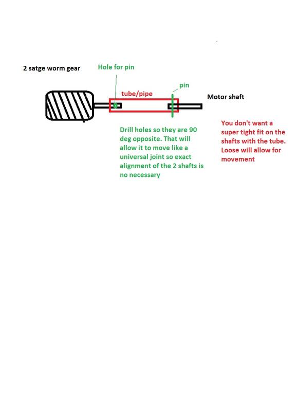

wallfish 20,509 #5 Posted October 22, 2022 Since you will need to make a mount for any motor either way ( Which is the most time consuming part} it seems like all the extra work is trying to find something to fit the chute. The existing 2 stage worm gear has a connection between it and the long handle so adapting a gear motor to that is the simple part. That worm gear has a small shaft on it with a hole for a cotter pin. Make a simple connection to a motor shaft with a piece of tube or pipe. 1/2" copper pipe or whatever. Dill holes near the ends at 90 deg, drill a hole through motor shaft if there isn't one. Wire to switch and done Walkbehind chute motors must be something new, never saw one but never searched either. All of mine over the years were hand rotated or a Toro stick control For information purposes https://www.amazon.com/Makermotor-Shaft-Reversible-Electric-Motor/dp/B0765KZ3TJ/ref=sr_1_2?adgrpid=1330409642054800&hvadid=83150841204345&hvbmt=be&hvdev=c&hvlocint=4087&hvlocphy=135813&hvnetw=o&hvqmt=e&hvtargid=kwd-83150966407384%3Aloc-190&hydadcr=25401_13486878&keywords=dc+gear+motor+100+rpm&qid=1666449420&qu=eyJxc2MiOiIxLjUzIiwicXNhIjoiMS41MCIsInFzcCI6IjAuMDAifQ%3D%3D&sr=8-2 https://www.surpluscenter.com/Electrical/Switches/Toggle-Switches/DPDT-CO-20-Amp-Momentary-Toggle-Switch-66-1851-11-3259.axd 1 Share this post Link to post Share on other sites

Jeff-C175 7,211 #8 Posted October 22, 2022 9 minutes ago, wallfish said: linked earlie https://www.amazon.com/dp/B07WH39VJ5/ This appears to be a suitable reversing switch, pre-wired. Share this post Link to post Share on other sites
