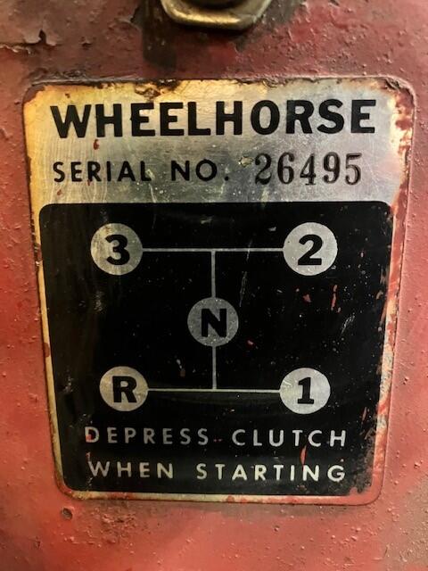

twisted metal 49 #1 Posted October 20, 2022 I have a round hood tractor that has no identification on it other than the serial number and I can't seem to find a list of serial numbers. The serial # is 26495. Any help would be greatly appreciated. 2 Share this post Link to post Share on other sites

Pullstart 70,030 #9 Posted October 20, 2022 Could it be 62495 instead of 26495? That would say it’s a ‘62 I think. 2 Share this post Link to post Share on other sites
twisted metal 49 #10 Posted October 20, 2022 I will double check to be sure. 2 Share this post Link to post Share on other sites

953 nut 66,350 #13 Posted October 21, 2022 (edited) Serial Number 26495 would make it a 1960 Suburban model 400 or 550 depending on the engine size. Click on the picture to open the manual. Edited October 21, 2022 by 953 nut 1 1 Share this post Link to post Share on other sites

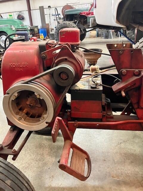

The Freightliner Guy 1,363 #15 Posted October 24, 2022 (edited) Hey is that a Chevy Apache back there? Edited October 24, 2022 by The Freightliner Guy 1 Share this post Link to post Share on other sites
twisted metal 49 #16 Posted October 24, 2022 It's a 1951 3800 1 1 Share this post Link to post Share on other sites

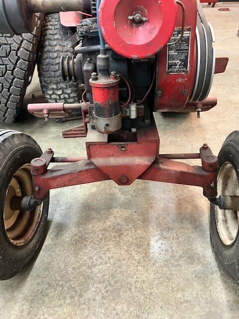

Pullstart 70,030 #17 Posted October 24, 2022 That double pulley SCREAMS 701! 1 4 Share this post Link to post Share on other sites
twisted metal 49 #18 Posted October 24, 2022 Yeah I'm pretty sure I have A hybrid. I am just curious to know what it was originally and I think that's probably what it was. 2 Share this post Link to post Share on other sites
kpinnc 18,308 #19 Posted October 24, 2022 Double pulley says 701. Stirrup footrests and front axle says 62 and newer. Welcome to the joy of collecting Wheel Horses!!! 1 1 Share this post Link to post Share on other sites

wallfish 20,002 #21 Posted October 24, 2022 Front axle is 63 or later. Definitely not a 701 2 Share this post Link to post Share on other sites
953 nut 66,350 #22 Posted October 24, 2022 You have a "Fromall", it has parts from all kinds of Wheel Horses! 1 1 1 Share this post Link to post Share on other sites
