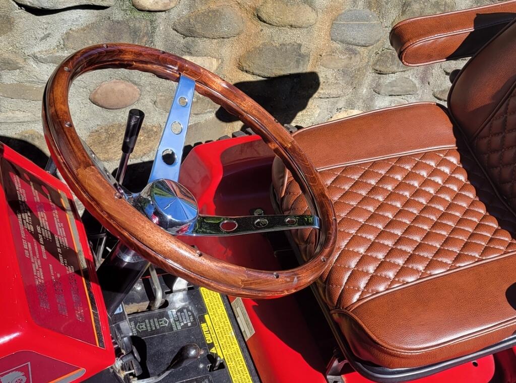

AMC RULES 37,260 #9 Posted October 20, 2022 Last thing I did was one single coat to seal this steering wheel after staining it to match the seat. 1 5 1 Share this post Link to post Share on other sites

Jeff-C175 7,211 #11 Posted October 20, 2022 2 minutes ago, AMC RULES said: the seat. Wow! Sweet seet! Share this post Link to post Share on other sites

varosd 1,185 #25 Posted October 20, 2022 16 hours ago, AMC RULES said: Last thing I did was one single coat to seal this steering wheel after staining it to match the seat. Wow Craig! I didn't think you could have a genuine 'imitation' Naugahyde seat From a Gremlin or Pacer on a WH! 2 Share this post Link to post Share on other sites
