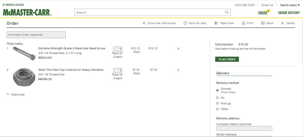

"Manic-Mechanic" 1,266 #1 Posted October 19, 2022 I know the original bolts are 3/8-16 3-1/4, I want to upgrade to a 9, however, they are 3-1/2. My question then, will I need to cut the extra 1/4 off these bolts? 1 Share this post Link to post Share on other sites

Jeff-C175 7,206 #4 Posted October 19, 2022 (edited) Do they need to be Grade 9 ? Are the originals Grade 8 ? Because those are available in 3-1/4" Plus, you get qty 10 for $2 less than qty 5 of the G9. Edited October 19, 2022 by Jeff-C175 1 Share this post Link to post Share on other sites
"Manic-Mechanic" 1,266 #5 Posted October 19, 2022 (edited) 9 minutes ago, Jeff-C175 said: Do they need to be Grade 9 ? Are the originals Grade 8 ? Because those are available in 3-1/4" Plus, you get qty 10 for $2 less than qty 5 of the G9. I have grade 9, but not sure if the extra 1/4" is too long? I'll know soon enough as I will put the assembly in the case and dry fit Edited October 19, 2022 by "Manic-Mechanic" 2 Share this post Link to post Share on other sites
