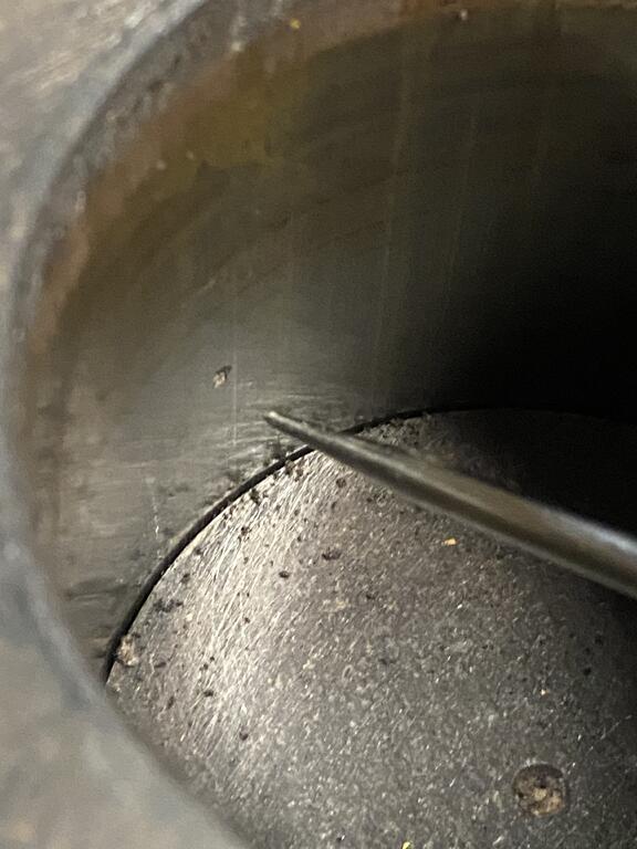

Heatingman 971 #1 Posted October 19, 2022 Are these the same block size? I just bought a k161 for cheap to get a pulley I need for another. Guy I bought it from said he pulled it off a parts tractor that was sitting outdoors for years, and the motor was siezed. He was able to free it up with a long term oil soak, then decided he did not need it. I dont really need it either, but Im gonna scavenge what I can. But I got to looking at it, and their is a very small nick in the cylinder wall, mid way up. Thinking maybe thats were the seize happened. If left as is and attempted to run, maybe it would. But Im sure in time, that nick would cause a problem. If the nick is deeper then 30 thou, wondering if the motor could be bored out for a k-181 piston. Then fixed up to have a good spare block for the future. Share this post Link to post Share on other sites
Pullstart 68,182 #3 Posted October 19, 2022 I just read on here the other day ( @ri702bill? ) that the k181 deck height is taller? Share this post Link to post Share on other sites
stevasaurus 23,455 #4 Posted October 19, 2022 I believe the block is the same. The bore is different, the stroke is different, the cam shaft is different, but it is the same block. You being from the Chicago area...there is a very good small engine guy in St. Charles. If you want a good opinion, take it to him and let him look at it. I had him do 2 of my K181S blocks 2 years ago. PM me and I will give you his name and address and phone #. He was excellent to work with. he was a Kohler Dealer in the past. 2 Share this post Link to post Share on other sites

Heatingman 971 #10 Posted October 19, 2022 (edited) So a little research. K161 bore is around 2 7/8 and the k-181 bore is around 2 15/16 stroke on the k161 is 2.5” stroke on the k181 is 2.75 so I reckon if I have it bored over use the k181 piston, I’ll create a k171 … LOL but if I swap the cam and the crank with a future k181 that may have a jacked up bore, then I’ll get a k-181 I’ll ask the small engine guy about it when I pick up the block Im having worked on. Edited October 19, 2022 by Heatingman 1 Share this post Link to post Share on other sites
Achto 29,857 #11 Posted October 19, 2022 (edited) If you bore a K161 out to the size of a K181 you will most likely not be able to use the K161 crank and connecting rod. I don't have every thing in my hand to measure but I would assume that the piston deck height ( distance from the wrist pin to the top of the piston ) is different from one engine to the other to accommodate for the length of the stroke. Looking at the numbers, a K181 piston on a K161 crank and rod may not reach all the way to the top of the cylinder at TDC. This would result in low compression. All the above is just theory that would need to be proved out with the proper measuring tools. Edited October 19, 2022 by Achto 4 Share this post Link to post Share on other sites

squonk 44,629 #14 Posted October 19, 2022 That nick will tear up a ring probably. Blocks the same. Internals and bore change the size. 2 Share this post Link to post Share on other sites
