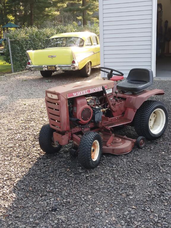

matt monte 232 #1 Posted October 15, 2022 i brought a wheel horse back from the dead. sitting in elements for 5 plus years. replaced everything u would suspect would be bad for being idle outside for years. Got it running. impressed but not surprised. i sharpened blades and everything spun freely. Unfortunately deck is way to loud and deck belt shakes alot more than a 312-8 i have with similar 36in RD deck. any thoughts? assuming a spindle is worn out. i pulled inspection cover and noticed no zerk fitting. how do u lube? deck is surprisingly in excellent condition.zero rust. so weird! Lastly there is no grey area to clutch. everytime i come off pedal im pulling front wheels! Is this an adjustment? hoping both are easy fixes. Any input would be greatly appreciated. 1 1 Share this post Link to post Share on other sites

8ntruck 9,338 #5 Posted October 16, 2022 My 1973 vintage 42" deck has zerk fittings on the spindle housings on the blade side of the deck. That is a nice 57 in the background. Is that 6 cylinder trim on the trunk lid part of a 'sleeper' vibe on the car? Share this post Link to post Share on other sites

matt monte 232 #8 Posted October 16, 2022 haha 57 is 350/4-speed, she goes. no zerk fittings however noticed a wobble in center drive pully that was horrible, no idea why. i pulled deck and retro fitted spare deck from my 312-8 for the B80. thought all attact o matic stuff was interchangable, not exactly the case as i found out. seemed to work. the b80 is only a backup to my 308-8. now that that is situated, i can now attach snowblower attachment i scored over summer to the 312-8. that way im ready and not screwing around mounting it in freezing weather the night before a storm only to find out there is an issue, thank you everyone for your quick responses. Share this post Link to post Share on other sites
