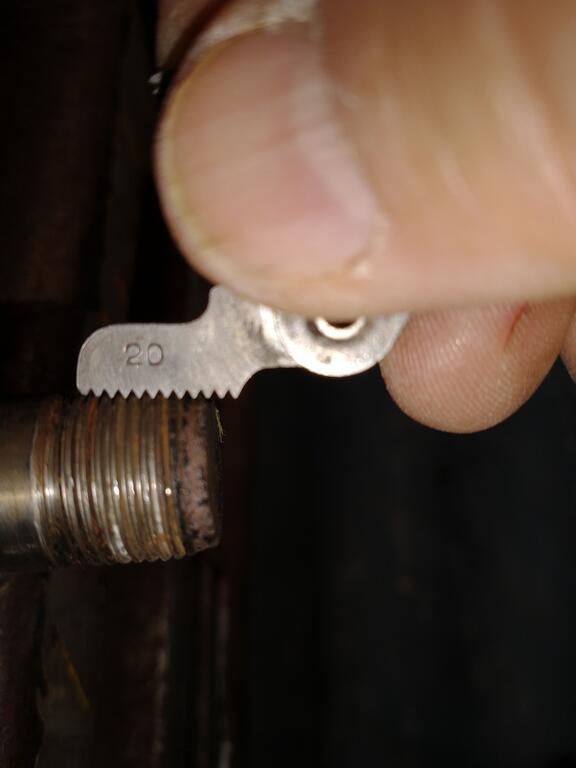

squonk 47,262 #4 Posted October 14, 2022 (edited) 5/8" 20 USS thread! Thin nut also. 1/4" thick Edited October 14, 2022 by squonk 2 1 Share this post Link to post Share on other sites

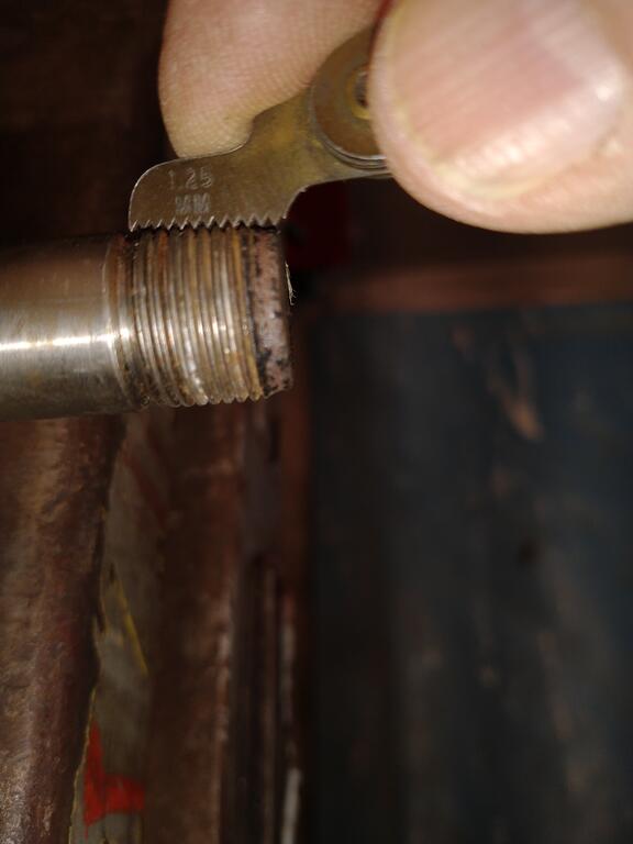

squonk 47,262 #10 Posted October 14, 2022 (edited) I just measured the threads with my metric thread gauge. 1.25 it is. Looks like you need 17mm X 1.25 thread about 6.5mm thick. Learn something new every day. My Grandmother would say you stop learning things once you're dead! Edited October 14, 2022 by squonk 2 1 Share this post Link to post Share on other sites

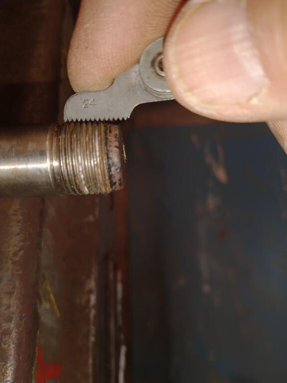

WHX?? 57,274 #15 Posted October 15, 2022 (edited) They are 5/8-24.. I got some from McMaster. Think they were in the jam nut isle. I might have a extra one one I could send you Bob since I am a SG freak. .. haveta look. I had some that had messed up threads and didn’t want to chance messing up the threads on a armature. Tractor buddy of Dan and mine say they are some kinda weird machinist thread. I did find those post nuts in the Hillman drawers once Dan. They were even 7teenths wrench size...I crs what store tho... Kinda like those SS jam nuts in 1/2-13 for the top of 701/702 steering pins I found once ... I gotta start writing this crap down... Edited October 15, 2022 by WHX?? 1 Share this post Link to post Share on other sites

squonk 47,262 #17 Posted October 15, 2022 (edited) This has been bugging me. If you look up Delco generator pulley nuts E bay lists them as 17MM X1.25 so I went out with my thread gauge. The shaft measures.65" or 21/32" . 65 is 16.6MM. My eyes aren't the best but to me 20 threads US and 1.25 metric fit better than US 24. Gen shaft is out of a 702 Edited October 15, 2022 by squonk 1 1 Share this post Link to post Share on other sites

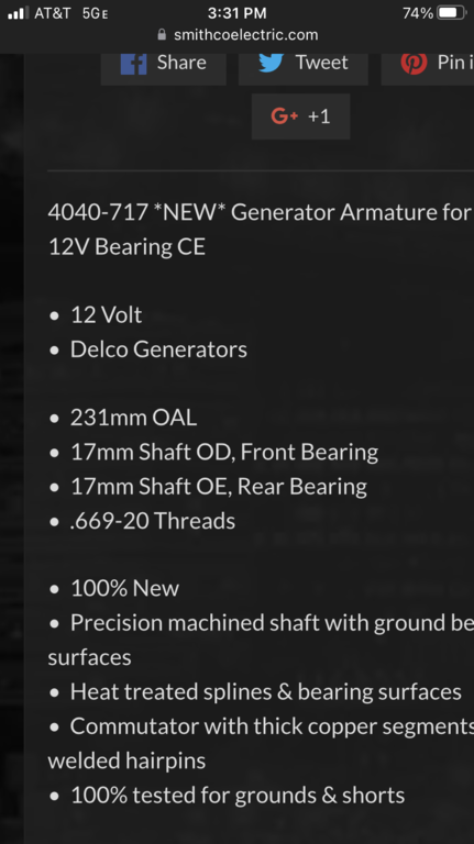

dclarke 4,270 #18 Posted October 15, 2022 From looking around the internet I’ve see these specs for the shaft thread size. 1 Share this post Link to post Share on other sites
