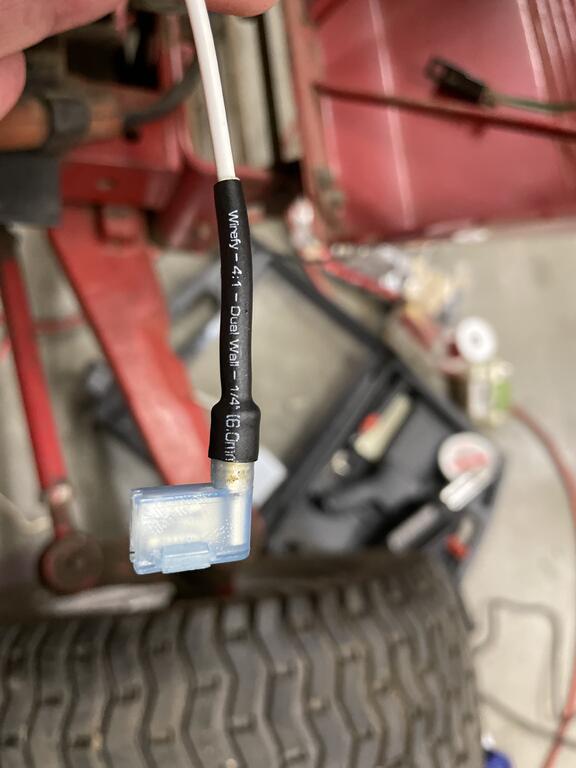

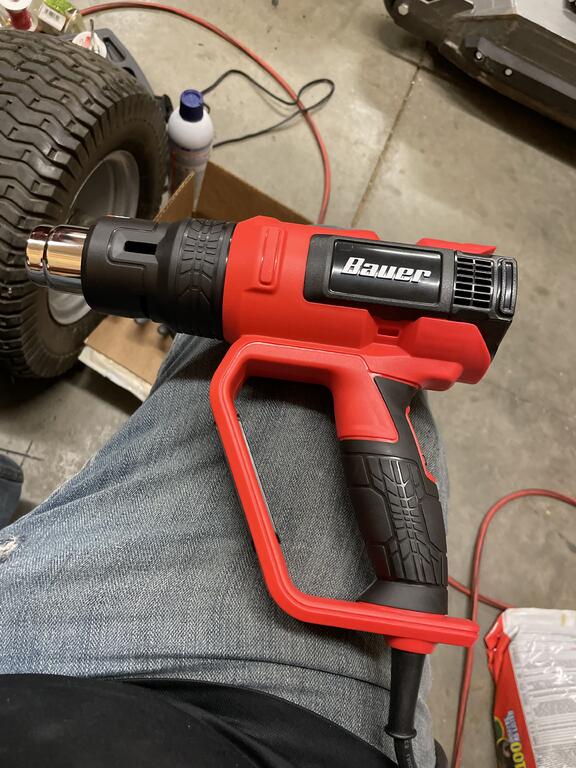

Bow_Extreme 583 #1 Posted October 11, 2022 Coming along! Harbor Freight, Bauer Heat Gun & Wirefly 4:1, sealant lined, shrink wrap. Nice and clean. 1 4 Share this post Link to post Share on other sites

Bow_Extreme 583 #8 Posted October 12, 2022 (edited) 1 hour ago, ebinmaine said: Not sure I knew those existed until now. It would be some handy behind a gas tank on the ignition switch of a C series or older stuff There’s a fair amount of older stuff out there that has this. The big problem with these was usually water and elements penetration at the crimp. With the sealed shrink wrap and the connector packed with di-electric grease, that should no longer be an issue. Edited October 12, 2022 by Bow_Extreme 2 1 1 Share this post Link to post Share on other sites
ebinmaine 80,081 #9 Posted October 12, 2022 26 minutes ago, Bow_Extreme said: With the sealed shrink wrap and the connector packer with di-electric grease, that should no longer be an issue. Agreed. That's how I build all my own harnesses too. Nice to see somebody doing it right. I hear @WHX?? Has a good quality love-hate relationship with Scotchlocs. 4 Share this post Link to post Share on other sites

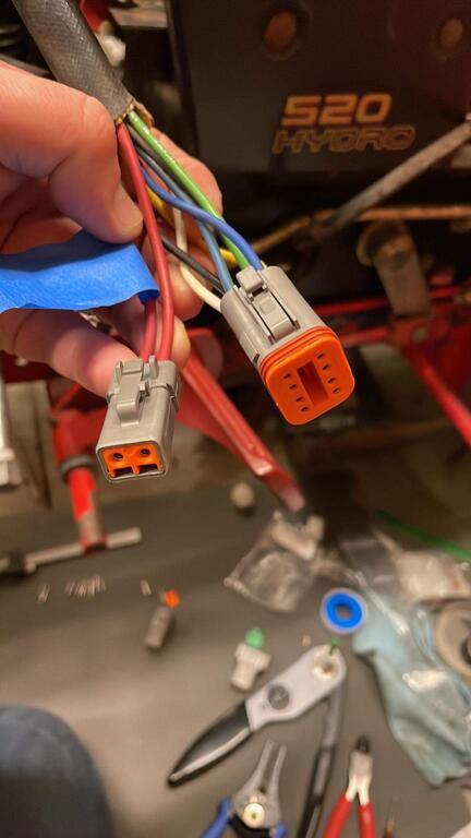

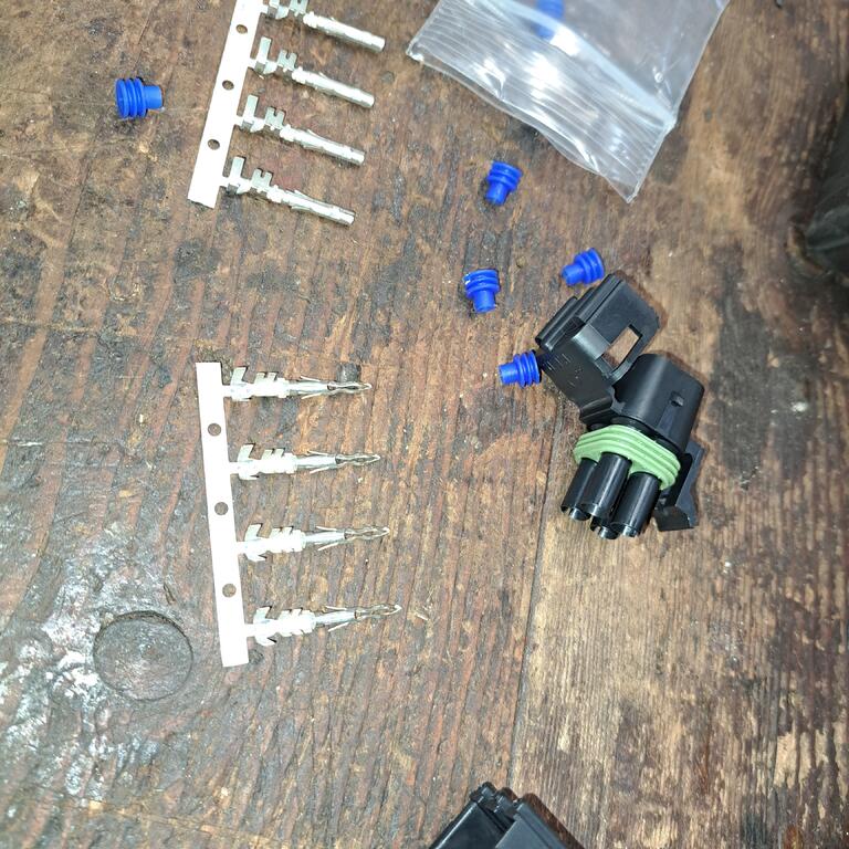

Bow_Extreme 583 #12 Posted October 12, 2022 9 minutes ago, 953 nut said: Delphi Packard 56 terminals will make a superior connection and are worth the extra expense on anything you plan to keep. They also fit into the terminal blocks used 100% agreed. I use them in original restorations only or where that’s all that will work. I prefer Deutsch connectors as they are weather tight and heavy duty. Share this post Link to post Share on other sites

ebinmaine 80,081 #14 Posted October 12, 2022 5 minutes ago, Bow_Extreme said: Deutsch connectors Matt can you show a picture of that? Share this post Link to post Share on other sites

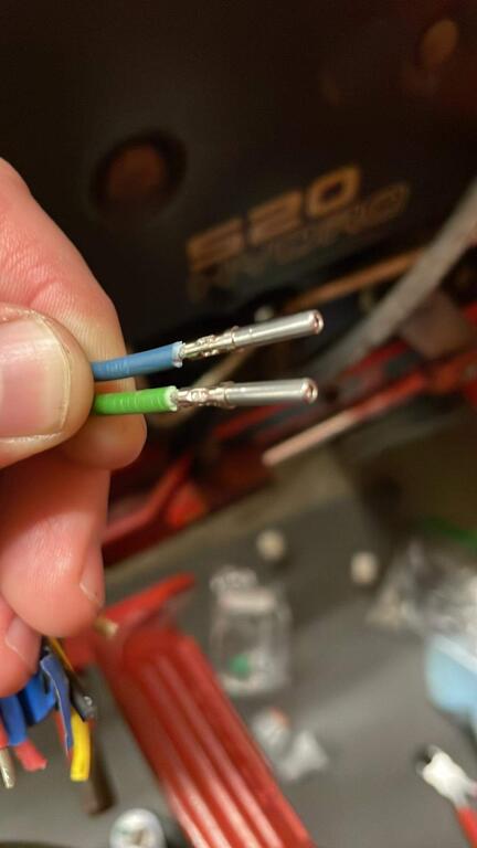

Bow_Extreme 583 #20 Posted October 12, 2022 2 hours ago, ebinmaine said: Matt can you show a picture of that? 2 1 Share this post Link to post Share on other sites
Achto 32,251 #21 Posted October 12, 2022 (edited) Deutsch connector!!! Far superior to any factory plug that used. Edited October 12, 2022 by Achto 2 Share this post Link to post Share on other sites

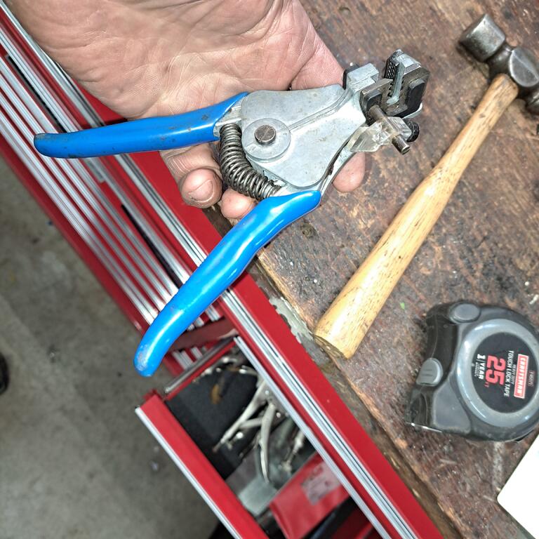

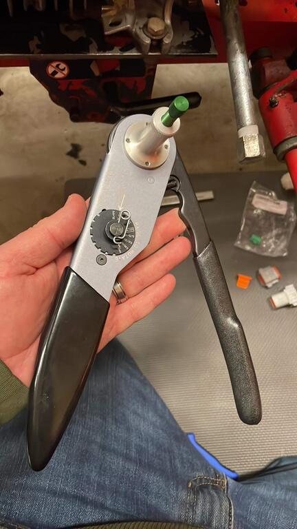

WHX?? 57,641 #24 Posted October 12, 2022 (edited) Guessing thats the crimper I need for these? For repairing the connectors on the horse hauler fuel station that got ripped out when a tire blew. I was going to solder them on but wouldn't be beyond having a set. What kind of power/ampss can Deutch connectors handle.? Looks like we have the same strippers Matt. These do work really slick. Edited October 12, 2022 by WHX?? 2 Share this post Link to post Share on other sites
Achto 32,251 #25 Posted October 12, 2022 3 minutes ago, WHX?? said: Guessing thats the crimper I need for these? Actually you need this style for those ends. https://www.amazon.com/TUBTAP-Crimping-Connectors-0-5-1-5mm²-Terminal/dp/B09GYFKT6F One of these will do the trick as well. https://www.google.com/search?q=blue+point+wire+crimpers&rlz=1C1GCEU_enUS821US821&source=lnms&tbm=isch&sa=X&ved=2ahUKEwiP17vZqtv6AhXLrmoFHYuFAG4Q_AUoAnoECAEQBA&biw=1920&bih=937&dpr=1#imgrc=uN7M3By97P-FQM I have this style if you need to borrow them. 2 1 Share this post Link to post Share on other sites
