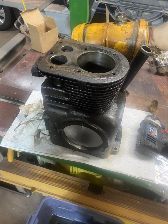

Snoopy11 5,731 #26 Posted October 11, 2022 48 minutes ago, Heatingman said: Just found a machine shop nearby that will bore the block. Guy said about 70 bucks. Not bad at all. You won't regret going that route... Don 1 Share this post Link to post Share on other sites
moe1965 774 #27 Posted October 11, 2022 Be sure to have your new piston to give the person doing the bore job you can't have that done until you have a new one 1 Share this post Link to post Share on other sites
Heatingman 977 #28 Posted October 11, 2022 25 minutes ago, moe1965 said: Be sure to have your new piston to give the person doing the bore job you can't have that done until you have a new one Right. Im gonna complete the teardown, evaluate, then order the oversized piston. But I want to find out if I need anything else too. Connecting rod, crank etc… Share this post Link to post Share on other sites

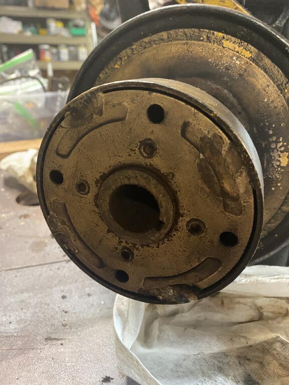

Heatingman 977 #29 Posted October 11, 2022 Is this a centrifugal clutch that was welded engaged and mounted backwards? this was being used to drive the home made mower deck drive set up. On this cub. mounted on the outboard side of the shaft that drives / gets driven by the starter generator. 1 Share this post Link to post Share on other sites
Handy Don 16,961 #30 Posted October 12, 2022 Not something I'd like to discover. Share this post Link to post Share on other sites
Heatingman 977 #31 Posted October 12, 2022 22 minutes ago, Handy Don said: Not something I'd like to discover. All sorts of oddities on this machine. Im just gonna get rid of it, and the mower deck. This machine will be for towing, or plowing, putting around only. 1 Share this post Link to post Share on other sites

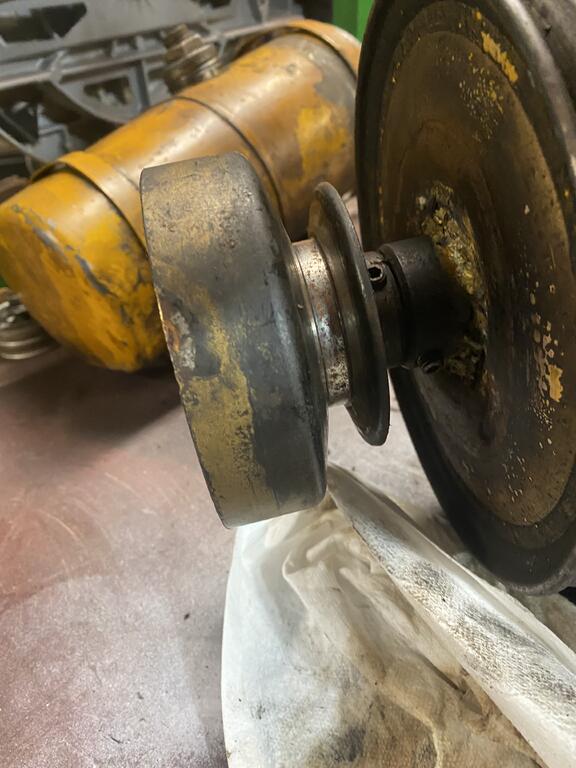

Snoopy11 5,731 #34 Posted October 12, 2022 14 hours ago, Heatingman said: All sorts of oddities on this machine. Im just gonna get rid of it, and the mower deck. This machine will be for towing, or plowing, putting around only. I do have a double pulley if you need it... Don Share this post Link to post Share on other sites
Heatingman 977 #35 Posted October 12, 2022 42 minutes ago, Snoopy11 said: I do have a double pulley if you need it... Don One with 2 sizes on it? What I really need/want is the pulley on the motor that gets driven by the starter generator. That or convert to a standard starter and alternator flywheel. Share this post Link to post Share on other sites
Heatingman 977 #36 Posted October 12, 2022 The pulley on this one for that was damaged like the hub sheared from the rest of the pulley, and what brazed back together. Share this post Link to post Share on other sites
Snoopy11 5,731 #37 Posted October 12, 2022 1 minute ago, Heatingman said: One with 2 sizes on it? Yessir, you can see it in this picture next to the green c-clamp. These pulleys aren't exactly cheap... Don Share this post Link to post Share on other sites
