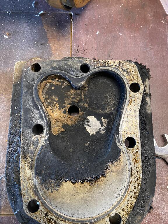

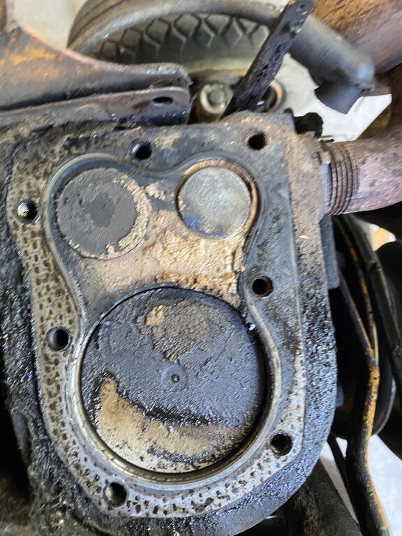

Heatingman 977 #12 Posted October 10, 2022 Does this look like blow by around the exhaust port? Share this post Link to post Share on other sites

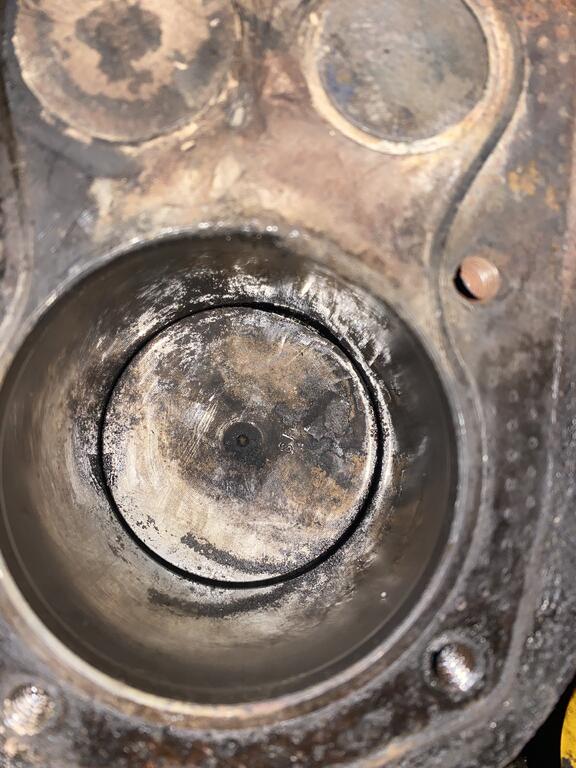

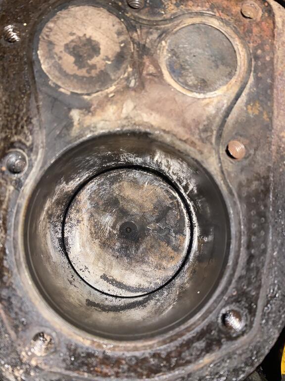

Heatingman 977 #14 Posted October 10, 2022 The valves both move up and down. And when in the down position, they will hold a paper towel in place on all sides. Again may some wear but not enough to keep from running at all Id think. Cylinder walls look OK, but I’ll have to measure for out of round. It looks well enough it should at least run. I’ll order a gasket kit and see if she’ll go. Share this post Link to post Share on other sites
squonk 48,322 #15 Posted October 10, 2022 Look at the piston edge closest to the exhaust valve. Top edge is eroded away. That engine was rode hard and put away wet. Example; Share this post Link to post Share on other sites
Heatingman 977 #16 Posted October 11, 2022 Cylinder bore is beyond wear limit at some points. Per the manual : original bore was : 2.938 max wear limit : 2.941 max out of round : .003 max taper : .003 Here is what I have, measurements taken near the top, the center, and near the bottom, in 3 indexes around the circle (exhaust, intake, middl) is what I am calling the index locations. Int Exh Mid top. 2.942 2.941 2.943 Center. 2.940 2.942 2.940 bottom 2.940 2.943 2.941 Is the motor just beyond useful life. And I need to scrap it, or machine the bore? Think it will run with a new gasket? I just want it to run. It has no useful implements, so its not like its gonna be used for work anymore. Share this post Link to post Share on other sites
