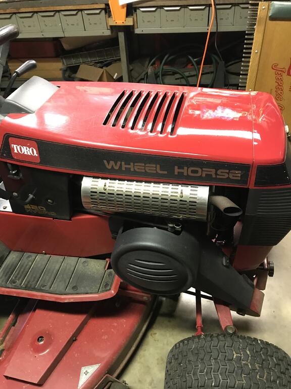

BellaB 7 #1 Posted October 9, 2022 Just picked up a GT314-8. The paint is oxidized. What is the best way to try and restore it without resorting to painting? 1 Share this post Link to post Share on other sites

lynnmor 9,064 #8 Posted October 10, 2022 I used a Harbor Freight polisher with the blue pad and the Groit's compound. There is a video on the website. What I like about this compound is that it is very forgiving and cuts very slow making it nearly impossible to do damage. This photo shows the front nearly complete and the rear not yet polished. 1 Share this post Link to post Share on other sites
