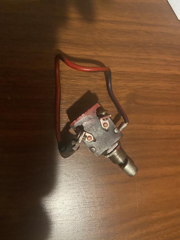

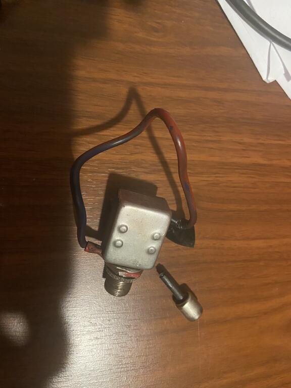

T-Mo-(Moderator) 4,889 #1 Posted October 9, 2022 This was on my Farmall Cub to kill the engine. I believe it's a momentary switch. When the button was pushed in, the tractor shut off. The button broke off and now doesn't work. Where can I find another like it? It has a 9/16 thread on it. I would prefer to replace it with one similar. Share this post Link to post Share on other sites

T-Mo-(Moderator) 4,889 #6 Posted October 9, 2022 The original was a push/pull type. The original starter would have been a switch on the starter with a rod going back to the dash that you pull. The original would have been 6V system, this one has been made over to a 12V system with a key switch that just starts the tractor and not to kill it. This switch that I need was the mechanism to kill the engine. I think I found a suitable replacement on Amazon. https://www.amazon.com/gp/product/B07591WVQV/ref=ox_sc_act_title_1?smid=A38KJROZ7L9QK1&psc=1 Share this post Link to post Share on other sites

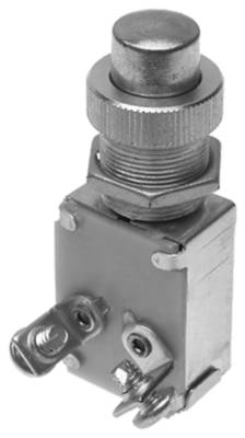

squonk 47,419 #7 Posted October 9, 2022 Napa Echlin STB 3 Normally Off Momentary On Share this post Link to post Share on other sites

squonk 47,419 #9 Posted October 9, 2022 Cheaper alternative Napa Grote 82-2151 1 Share this post Link to post Share on other sites

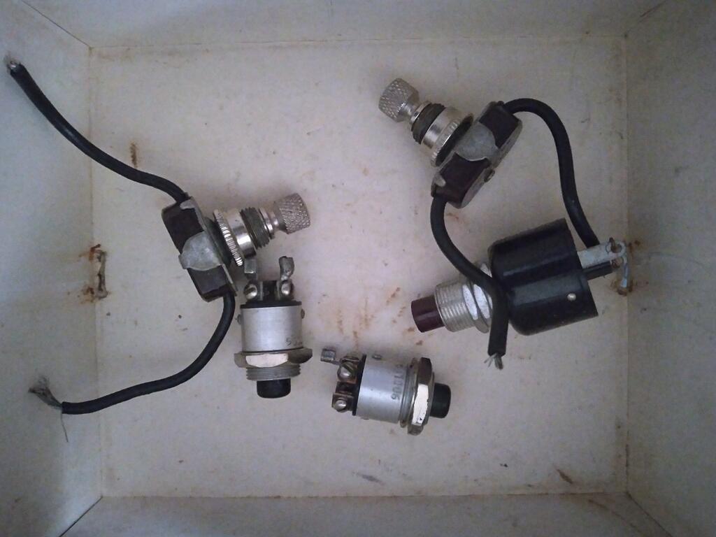

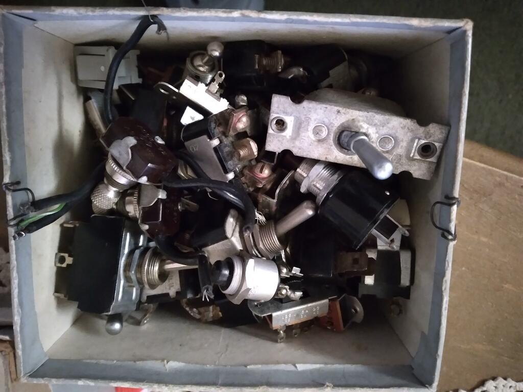

D_Mac 9,337 #11 Posted October 16, 2022 Picked this box of switches up at a garage sale for 5 bucks. Has a few push button switches in it. If you can't find one let me know. You can try one of these. 2 Share this post Link to post Share on other sites
T-Mo-(Moderator) 4,889 #12 Posted October 18, 2022 Found the switch at NAPA, I got it installed and it's working. 1 1 Share this post Link to post Share on other sites
