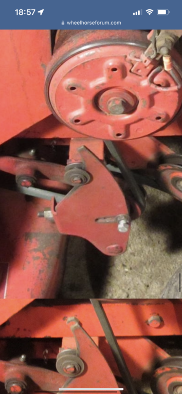

Wheelhorsegt-14 4 #1 Posted October 8, 2022 I recently bought a gt14. And it came with a 48” side discharge mowing deck. But I can figure out how to mount it to the tractor. And I’m also missing what looks like a second pulley system I attached a pic of what I think I’m missing. I found that pic here on another thread. I’ve looked at all the manuals I can find here but I can’t seem to figure out how it all goes. And where to find this pulley system. If anyone can help I’ll really appreciate it 1 Share this post Link to post Share on other sites

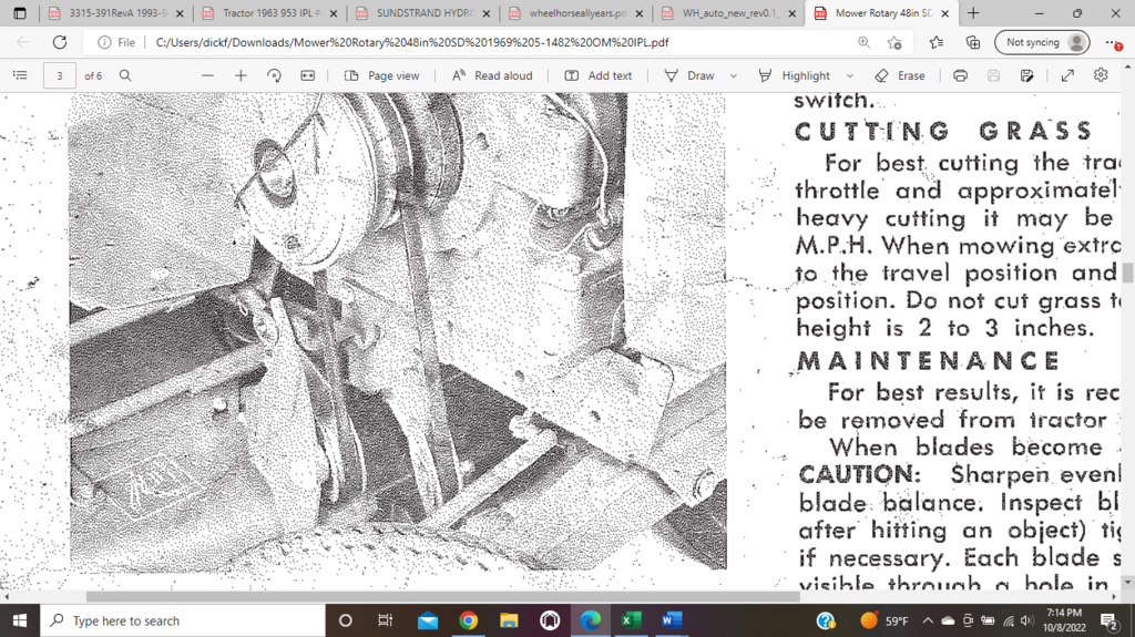

gwest_ca-(File Mod) 12,510 #2 Posted October 8, 2022 Welcome to the forum. Possibly this deck? Click on the fuzzy picture. Share this post Link to post Share on other sites
953 nut 69,810 #3 Posted October 8, 2022 The pulley system pictured here should have come with the deck. Share this post Link to post Share on other sites

JimSraj 585 #5 Posted October 18, 2022 The manual I have says that the parts you have pictured should have come with the tractor, but that was 50+ years ago. I can’t find the pivot arm but I do have a left side mounting plate, a lift stud, the little cam arm assembly. I haven’t been able to find the pivot arm assembly or the right side mounting plate yet. Share this post Link to post Share on other sites
