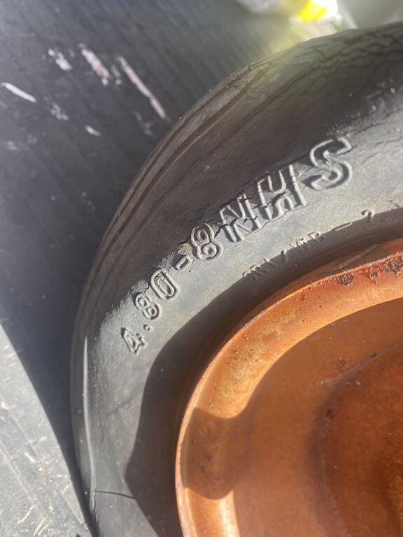

Heatingman 977 #1 Posted October 8, 2022 Got a dump cart a few weeks ago. Planning to mess with the tires tomorrow. The tires are shot. So I want to replace them. Tire size listed on the tires is 4.80-8 NHS What do the numbers mean? NHS I assume means “not for highway service” Share this post Link to post Share on other sites
Pullstart 71,215 #2 Posted October 8, 2022 4.8” tire section (width and height) and 8” wheel. It should be around 16” overall height. 4.8+4.8 (but those are subject to lies) on an 8” wheel. 1 Share this post Link to post Share on other sites
Heatingman 977 #3 Posted October 8, 2022 44 minutes ago, Pullstart said: 4.8” tire section (width and height) and 8” wheel. It should be around 16” overall height. 4.8+4.8 (but those are subject to lies) on an 8” wheel. So the tire should be around 4.8” wide sidewall to sidewall then the total diameter would be approximately that same 4.8 plus the rim plus the 4.8 again? Tire nomenclature has always been totally baffling to me. Ironically I worked at a tire shop the summer after highschool. Probably changed over a 1000 tires that summer. Everything from lawnmower wheels to tractor trailers. 1 Share this post Link to post Share on other sites
