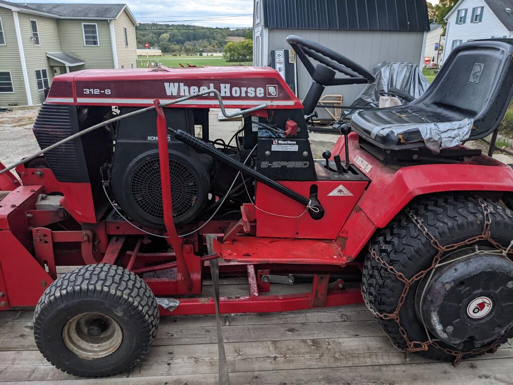

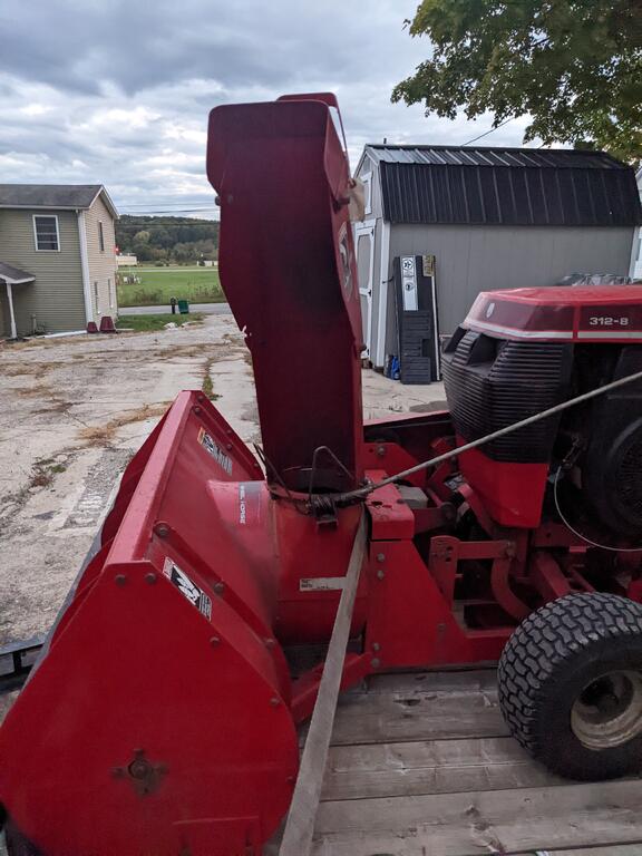

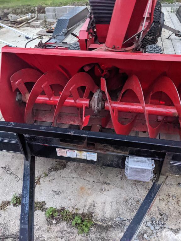

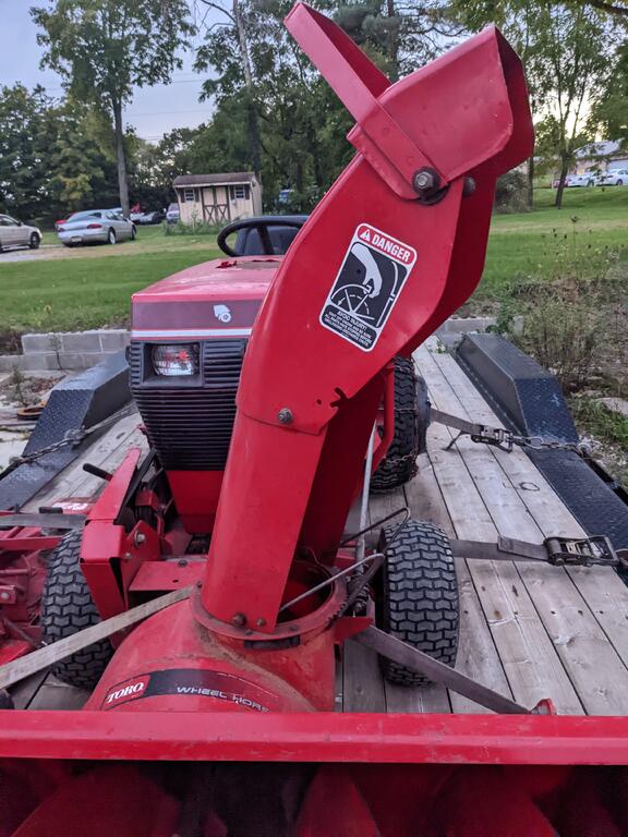

bswet1 39 #1 Posted October 5, 2022 Just picked up this 312-8 from an older gentleman local to me. Plans are to use it to snowblow the driveway this winter, fix it up and make it look nice, and basically run the heck out of it when I need to. I feel like I got a decent deal on it- I got the tractor, blower, plow, deck and bagger for $850. I am going to play with it a bit more this weekend and see how it comes out. Thanks for looking. 5 8 Share this post Link to post Share on other sites
Pullstart 70,766 #2 Posted October 5, 2022 nice deuce! I bet you’ll wear your left arm out before you wear it out! 3 Share this post Link to post Share on other sites
Handy Don 16,973 #4 Posted October 5, 2022 (edited) Welcome. As pullstart mentioned, using a two-stage on the "armstrong" lift is REAL WORK. Make sure you search for and get the OM and IPL (owners manual and illustrated parts list) from this site's files archive. Search using the model number of the blower. That'll show you how to correctly mount it, including the critically important load balancing spring. Edited October 5, 2022 by Handy Don 3 1 Share this post Link to post Share on other sites

Pullstart 70,766 #7 Posted October 5, 2022 Are those rear tires fluid filled? If not, it might be worth “loading” them for more rear weight. A lot of snow pushing/blowing people also attach a length of roller chain in a loop around the front tires for a blade like bit of traction while steering. 2 Share this post Link to post Share on other sites
bswet1 39 #8 Posted October 5, 2022 17 minutes ago, Pullstart said: Are those rear tires fluid filled? If not, it might be worth “loading” them for more rear weight. A lot of snow pushing/blowing people also attach a length of roller chain in a loop around the front tires for a blade like bit of traction while steering. Not sure. I haven't had the chance to play with it much. I pulled it off my trailer and parked it. I am going to give it a good once over, greasing, and cleaning this weekend. 3 Share this post Link to post Share on other sites
peter lena 9,951 #9 Posted October 5, 2022 @bswet1 welcome to the groupe ! something easy to do . if you would like , give that an aerosol penetrating oil spray down , all painted surface's , let it soak in a day , clean it off with a soft clean cloth , you have just fed the paint , and retained patina . notice the deeper slick finish? typically do that 2 times . that insures paint retention of lubrication. another thing is a thorough baseline service , all lubricants , thorough greasing , check that blower drive chain , for lubrication and adjustment , engine belt drive , drives that, just behind blower. change rear end oil , probably new shift boot . super lube oil on those , throttle / choke cables . verify all your electrical connections , eliminate corrosion , might consider a new seat , others will chime in , with ideas / input , good luck with it , pete Share this post Link to post Share on other sites

Ed Kennell 46,618 #14 Posted October 6, 2022 A dual stage blower, deck w/bagger, and plow, and a 312-8....you got a deal. Here's the but...IMO, the 312-8 is not a good machine to operate a twin blower. The 12HP is not enough power to efficiently run the blower and the manual lift will be a challenge. Changing this tractor from blower to deck w/bagger will not be something you will want to do two times every year. I would keep the 312-8 and use the deck and plow. Sell the blower or look for a tractor with a hydraulic lift and a minimum of 16 HP as a dedicated blower machine. Please don't take this advice as a negative. We are here to help and offer opinions based on our experiences. Again, you got a real deal. to the 4 Share this post Link to post Share on other sites

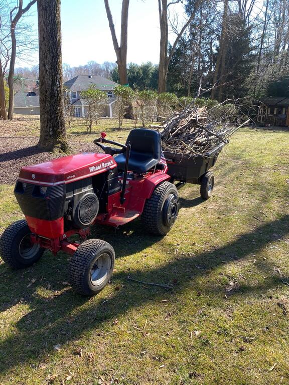

F. Marra 17 111 #19 Posted October 6, 2022 3 minutes ago, Ed Kennell said: Just curious Marra, Do you also mow with it ? What is the change over like? No, I dont mow with it. I do have a like new 48" deck that has barely been used. I work 6, sometimes 7 days per week so I pay the local landscaper to hit my lawn once a week just becasue I dont have the time. I do pull the snowblower off every season though and its fairly simple. I'd say it takes me around 30 minutes to attach the and detach the blower and tire chains. I made a makeshift crane and harness that attaches to my front tach and I carry the blower to the sheds with that. It is a heavy SOB. In the spring, summer and fall I use the tractor to pull a dump trailer for cleanup, and also pull a dethatcher, aerator. 6 Share this post Link to post Share on other sites

Ed Kennell 46,618 #23 Posted October 6, 2022 I gotta know...what's on the other end of the string that is tied to the lift lever? Share this post Link to post Share on other sites
bswet1 39 #24 Posted October 6, 2022 24 minutes ago, Ed Kennell said: I gotta know...what's on the other end of the string that is tied to the lift lever? Good question.... I will take a gander this weekend and find out. 1 1 Share this post Link to post Share on other sites
R Scheer 515 #25 Posted October 6, 2022 (edited) I'll disagree with Ed Kennell on the power. I've run the duece on my 312h for the last 30 years, and it suits my needs without any issues. It depends on how much area you're clearing, and the type of snow you get. More power would be nice, but I wouldn't underestimate the 312, just take it slow and it will do the job. Just my opinion. The blower is a beast however, I've arranged the shed so I can drive in and drop the blower for the summer, drive in and attach it for the winter. Manual lift will be interesting, if I remember right it's 350 pounds. I forgot my manners, welcome to Red Square! You'll have a hard time finding a more helpful group. Edited October 6, 2022 by R Scheer Share this post Link to post Share on other sites
