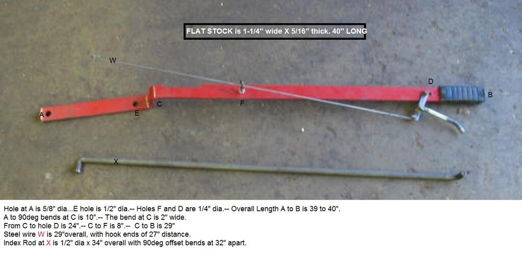

Searcher60 209 #1 Posted October 3, 2022 Thanks in advance, you guys are great! I need to make 2 standard tilt levers for dozer blades I have. Can you tell me if the steel is 5/16” thick x 1 1/4” wide? What is the overall length? How far up from the bottom is that offset 90 deg. bend, and how wide is the offset bend? Other than that offset bend, is the lever straight from top to bottom? Thanks again! Share this post Link to post Share on other sites
daveoman1966 3,884 #2 Posted October 3, 2022 The flat stock steel bar is 5/16" x 1-1/4" wide. Here are the other dimensions. 3 Share this post Link to post Share on other sites

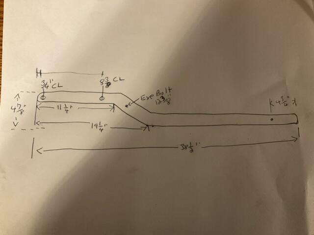

JCM 11,343 #3 Posted October 3, 2022 Does anyone have a similar illustration on the angle lever used with the 520-H with the front extension set up ? Share this post Link to post Share on other sites

Searcher60 209 #9 Posted October 3, 2022 (edited) 9 hours ago, JCM said: Does anyone have a similar illustration on the angle lever used with the 520-H with the front extension set up ? The hole measurements on the left, and eye bolt hole, are all from the left side very end, the one on the right from the very right end. All bolt hole measurements are to the center of the hole. I have a complete 520 dozer extension kit for sale, but the handle is expensive to ship due to offset and length. Edited October 4, 2022 by Searcher60 1 1 Share this post Link to post Share on other sites
Searcher60 209 #10 Posted October 4, 2022 The hole measurements on the left, and eye bolt hole, are all from the left side very end, the one on the right from the very right end. All bolt hole measurements are to the center of the hole. I have a complete 520 dozer extension kit for sale, but the handle is expensive to ship due to offset and length. 1 Share this post Link to post Share on other sites
