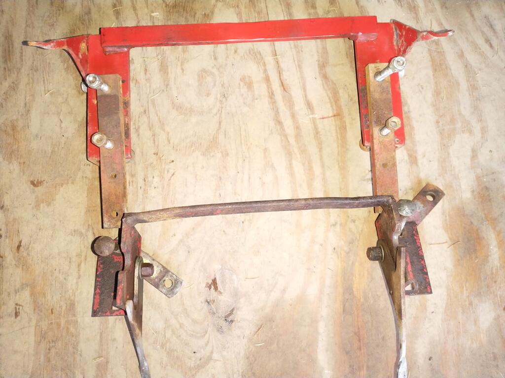

squonk 44,979 #5 Posted October 3, 2022 Tractors don't really care if it's a 42 or 48. Long frame plows are pretty much the same. There are some different bent angle levers. Where you run into issues are the axle brackets. I run a std. long frame plow on my 953. I had an axle bracket that the ears engaged the plow frame on the outer sides. Was a real pain to put on. I found another bracket that looked identical except the ears engaged the frame on the inside edge. Made all the difference 1 Share this post Link to post Share on other sites
ebinmaine 76,148 #6 Posted October 3, 2022 18 minutes ago, squonk said: had an axle bracket that the ears engaged the plow frame on the outer sides. Was a real pain to put on. I found another bracket that looked identical except the ears engaged the frame on the inside edge I don't think I knew there was any differences along the years.... Not a big deal. Just for curiosity. I don't suppose you have any pictures? Share this post Link to post Share on other sites
squonk 44,979 #7 Posted October 3, 2022 1 minute ago, ebinmaine said: I don't think I knew there was any differences along the years.... Not a big deal. Just for curiosity. I don't suppose you have any pictures? Next time I get "sent to the shed" I'll get one. 1 Share this post Link to post Share on other sites
squonk 44,979 #8 Posted October 3, 2022 2 hours ago, ebinmaine said: I don't think I knew there was any differences along the years.... Not a big deal. Just for curiosity. I don't suppose you have any pictures? I have no idea where that bigger axle bracket came from. It must have been on something I bought. 1 Share this post Link to post Share on other sites
gwest_ca-(File Mod) 11,875 #9 Posted October 3, 2022 Top one in the photo looks like the early hitch that bolted to the front of the axle housing. Are the notches in the sides or ends of the angle iron pieces? 1 Share this post Link to post Share on other sites

squonk 44,979 #12 Posted October 3, 2022 1 hour ago, gwest_ca said: Top one in the photo looks like the early hitch that bolted to the front of the axle housing. Are the notches in the sides or ends of the angle iron pieces? No notches. It's also a lot heavier. Share this post Link to post Share on other sites
