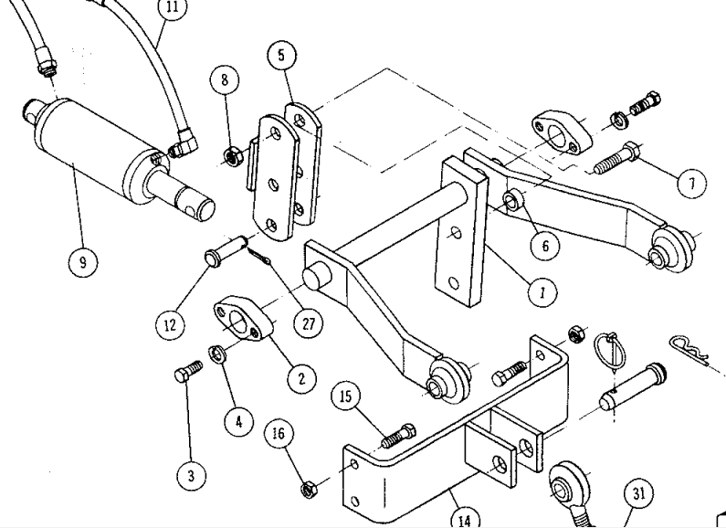

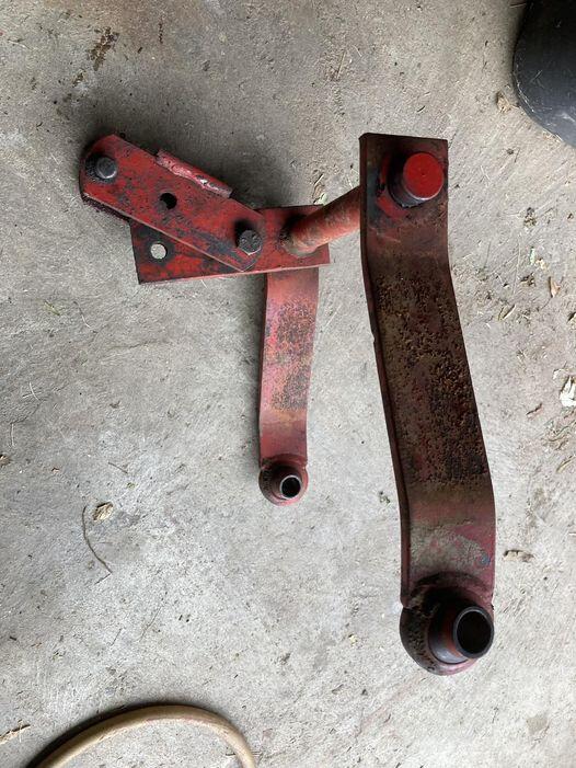

"Manic-Mechanic" 1,485 #1 Posted October 1, 2022 (edited) I am curious, is this second hole in the lift lift assembly (102100) to change positioning? I didn't see anything in the manual... There is no understanding why another group of holes is there between (102100) #1 and (102104) #5 Hitch 3-Point 1973-74 8-5421 OM #A-5340.pdf Edited October 1, 2022 by "Manic-Mechanic" Share this post Link to post Share on other sites
gwest_ca-(File Mod) 12,352 #2 Posted October 1, 2022 Just guessing here. It takes 2 bolts to mount the link solid so you have down pressure. If you removed the middle bolt it would give you a float capability for a rear attachment. 1 Share this post Link to post Share on other sites
"Manic-Mechanic" 1,485 #3 Posted October 1, 2022 53 minutes ago, gwest_ca said: Just guessing here. It takes 2 bolts to mount the link solid so you have down pressure. If you removed the middle bolt it would give you a float capability for a rear attachment. So, like running the finish mower ? (float) Not so for the roto tiller, plow and cultivator (down pressure) Well, it's not an easy bolt to get to! Lol! Best case scenario? Share this post Link to post Share on other sites
Handy Don 16,944 #4 Posted October 2, 2022 21 hours ago, "Manic-Mechanic" said: Well, it's not an easy bolt to get to! Lol! Clevis pin with an R-pin or head wire lock pin? 1 Share this post Link to post Share on other sites
"Manic-Mechanic" 1,485 #5 Posted October 2, 2022 10 minutes ago, Handy Don said: Clevis pin with an R-pin or head wire lock pin? Head wire lock pin could be easier, custom cut short. Share this post Link to post Share on other sites
