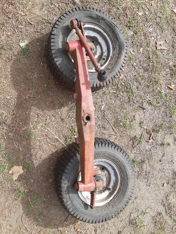

The Gman 476 #1 Posted September 30, 2022 Hey guys/gals, I need some brain power transferred to me. Parting out a 520 with swept axel but can't seem to get the steering joints free. The castle nuts are rusted up and the ball joint is real smooth and just spins. Don't want to lay the vise grips to the shaft unless I have to. Any help would be appreciated. Share this post Link to post Share on other sites

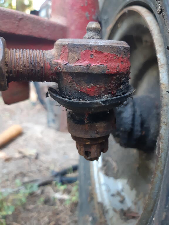

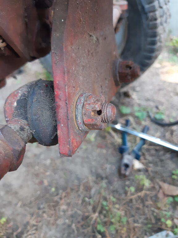

squonk 45,488 #2 Posted September 30, 2022 (edited) Soak the threads with penetrant. Large pair of channel lock pliers to force (squeeze) the taper on the tie rod against plate in the first pic and the spindle arm in the 2nd pic. Use an impact gun to spin the nut off Edited September 30, 2022 by squonk 1 Share this post Link to post Share on other sites

The Gman 476 #6 Posted September 30, 2022 Don't see any flats. I do have a nut buster if it comes to that but rather not. The axel is sold. Gonna soak.... soak..... and soak overnight. A little bit of heat and try again. Share this post Link to post Share on other sites
John2189 561 #7 Posted September 30, 2022 what if you put a c clamp on the ball side of the stud and the plate Tighten it up it will/should put the stud into a bind to keep it from turning ? 4 Share this post Link to post Share on other sites

The Gman 476 #12 Posted October 1, 2022 Success, Liquid wrench/heat...... repeat.......repeat. impact on/off/on/off/ Curse...threats... beg In that order. Channel locks/impact and off they came. Thanks one and all. 2 Share this post Link to post Share on other sites
