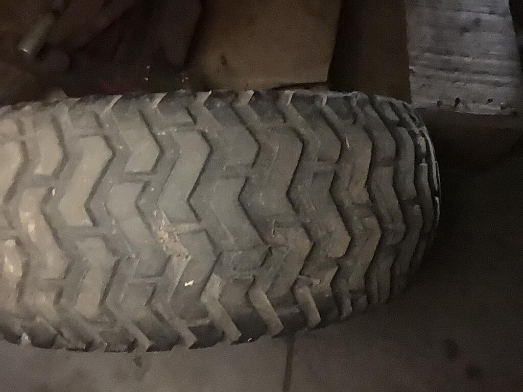

Pullstart 71,215 #2 Posted September 29, 2022 Any tire that’s not flat on the bottom should work for that duty, for quite some time. These 16x6.50-8’s we’re on a GT14 and they are in good shape if you’re interested.. Share this post Link to post Share on other sites

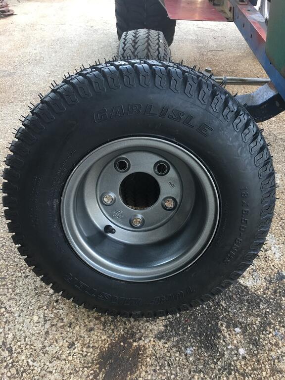

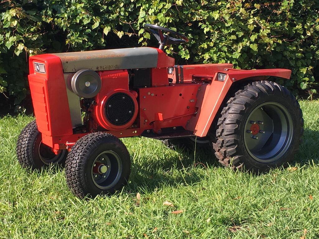

19richie66 17,932 #5 Posted September 30, 2022 (edited) I bought Carlisle 18-6.50x8 Turf Masters and am very happy with them. I did put them on a slightly wider wheel though as I converted to trailer hubs. Edited September 30, 2022 by 19richie66 2 Share this post Link to post Share on other sites
