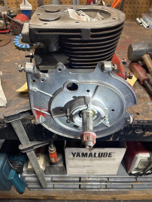

Wheelhorse#1 1,879 #1 Posted September 28, 2022 I have a k181 I’m rebuilding.Trying to remove the bearing plate. This one is stubborn as h@ll .I have tried heat.Tried pry bars, moving side to side wile pulling.Rubber hammer.Lubed it up last night and will try again when I get home. The shims are broken loose.I guess it’s holding onto the bearing and shaft. Ive done a couple and never ran into this problem. Can Anyone offer any tips,I know it doesn’t take much to crack the aluminum plate,trying to avoid that Share this post Link to post Share on other sites
squonk 44,628 #2 Posted September 28, 2022 Warm the aluminum area around the bearing. The aluminum will expand faster than the steel bearing. 2 Share this post Link to post Share on other sites
Wheelhorse#1 1,879 #3 Posted September 28, 2022 2 hours ago, squonk said: Warm the aluminum area around the bearing. The aluminum will expand faster than the steel bearing. Thank you.I’ll giver a go this evening. Share this post Link to post Share on other sites
peter lena 9,457 #4 Posted September 28, 2022 @Wheelhorse#1 in addition to a dissimilar metal penetrating oil soak , how about that rubber hammer or a soft dead blow , on either upper corner , left or right getting it to turn / slide on its mount ? would think its more effective without the breakage issue , might even use a wooden block as a strike point . no prying . pete 1 1 Share this post Link to post Share on other sites
Pullstart 68,181 #5 Posted September 29, 2022 Could you use a steering wheel puller on the stator bolt holes and the crank? Share this post Link to post Share on other sites
squonk 44,628 #6 Posted September 29, 2022 7 minutes ago, Pullstart said: Could you use a steering wheel puller on the stator bolt holes and the crank? If it's really tight you risk breaking the plate. A little heat and it should fall off. 1 Share this post Link to post Share on other sites
Wheelhorse#1 1,879 #7 Posted September 29, 2022 (edited) On 9/28/2022 at 8:28 PM, squonk said: If it's really tight you risk breaking the plate. A little heat and it should fall off. @squonkI thought about that.I have one but not the correct bolts,I’m sure It would probably work though. Heat eventually did the trick.Took about half hr and a few cuss words but it finally broke loose.I don’t believe this engine has ever been molested before. Edited September 30, 2022 by Wheelhorse#1 2 Share this post Link to post Share on other sites
