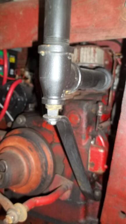

TJ5208 1,841 #1 Posted September 28, 2022 What angle of pipe do i need to have to have a exhaust system like this. Share this post Link to post Share on other sites
JimSraj 585 #2 Posted September 28, 2022 The iron pipe looks like a 22-1/2 and a 90 plus the nipples to connect. 1 Share this post Link to post Share on other sites
TJ5208 1,841 #3 Posted September 28, 2022 1 minute ago, JimSraj said: The iron pipe looks like a 22-1/2 and a 90 plus the nipples to connect. What about the bend in the middle. Share this post Link to post Share on other sites
Handy Don 17,484 #4 Posted September 28, 2022 (edited) 18 hours ago, TJ Salyers said: What about the bend in the middle. The 22½ is a female to female elbow - 45º (edited!) Edited September 28, 2022 by Handy Don 1 Share this post Link to post Share on other sites
TJ5208 1,841 #5 Posted September 28, 2022 1 minute ago, Handy Don said: Looks to be a 45º coupler I want to do this setup on my Raider 14 and I like how the exhaust goes straight out not at a angle. Share this post Link to post Share on other sites
Handy Don 17,484 #6 Posted September 28, 2022 (edited) 18 hours ago, TJ Salyers said: I want to do this setup on my Raider 14 and I like how the exhaust goes straight out not at a angle. (comment removed) Also, it'll need a support bracket -- you cannot safely support that from the block only. Edited September 28, 2022 by Handy Don Share this post Link to post Share on other sites
TJ5208 1,841 #7 Posted September 28, 2022 (edited) 3 minutes ago, Handy Don said: Note i edited my response. 22 ½, not 45. Also, it'll need a support bracket -- you cannot safely support that from the block only. I could make a support to the frame. Edited September 28, 2022 by TJ Salyers Share this post Link to post Share on other sites
JimSraj 585 #8 Posted September 28, 2022 That’s the 22-1/2 if I’m looking at it right. Looks like a 3” nipple out of the block, then the 22-1/2, then a 2” nipple into a 90 into another 3” nipple to the muffler. Agree on additional support. 2 Share this post Link to post Share on other sites
TJ5208 1,841 #9 Posted September 28, 2022 10 hours ago, JimSraj said: That’s the 22-1/2 Is that a 45 degree angle? Share this post Link to post Share on other sites
twisted metal 49 #10 Posted September 28, 2022 Yes it's a 45 degree angle. They only make 45 and 90 degree threaded pipe fittings. Share this post Link to post Share on other sites
lynnmor 9,042 #11 Posted September 28, 2022 46 minutes ago, TJ Salyers said: Is that a 45 degree angle? 22-1/2 is half of 45, basic geometry. Share this post Link to post Share on other sites

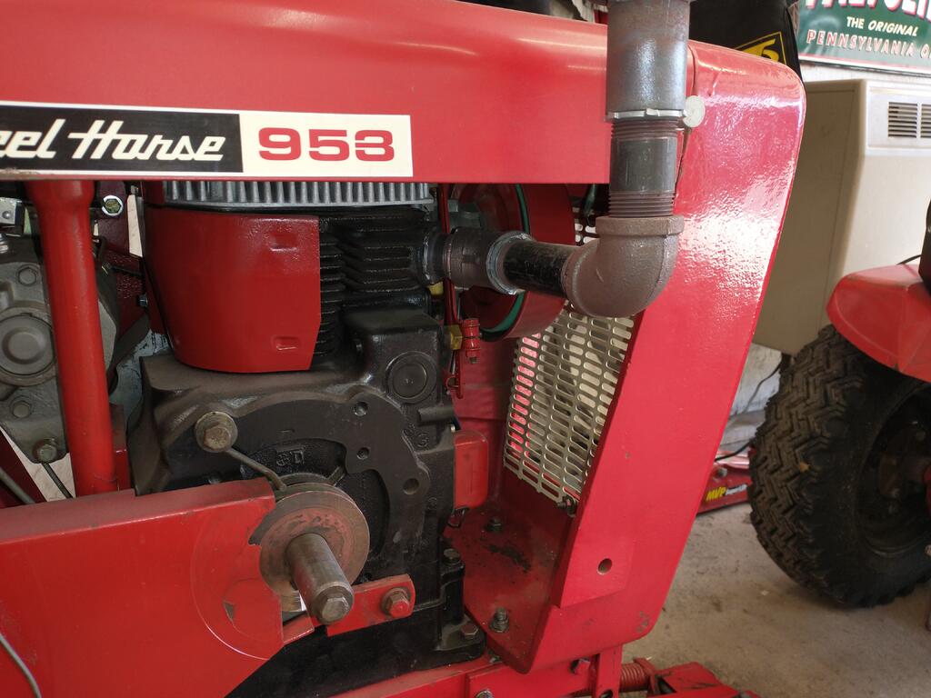

wallfish 20,619 #13 Posted September 28, 2022 (edited) This thread is confusing. Both the 22 1/2 thing and why anyone wants a stack. LoL The exhaust port coming out of the Kohler engine is at 45 deg, That pipe nipple exiting the exhaust port goes into a 45 deg fitting, Then to a 90 deg fitting to turn it straight up The angle the pic is taken might be at 22 1/2 deg Edited September 28, 2022 by wallfish 2 Share this post Link to post Share on other sites
squonk 48,141 #14 Posted September 28, 2022 Yup 45° +45° =90° If you managed to find a 22 1/2 the pipe would come out at a funky angle towards the front corner of the hood. Share this post Link to post Share on other sites
Jeff-C175 7,211 #15 Posted September 28, 2022 Just for completeness sake, the pipe thread is 1" IPS. You can brace to frame as long as it's not a shaker plate. 2 Share this post Link to post Share on other sites
953 nut 69,475 #16 Posted September 28, 2022 If you replace the 90 with a 1" X 1/2" X 1" black iron "T" and drill and tap a 1/2" pipe plug for 1/4-20 the brace can be put under the added weight. 5 2 Share this post Link to post Share on other sites

953 nut 69,475 #19 Posted September 29, 2022 10 hours ago, TJ Salyers said: Thats what i meant the angle towards the front of the hood i dont want that. If you want the stack a bit further back you could eliminate the short nipple and F X F 45 and use a 1" black iron Street 45 right off the engine. 1 Share this post Link to post Share on other sites

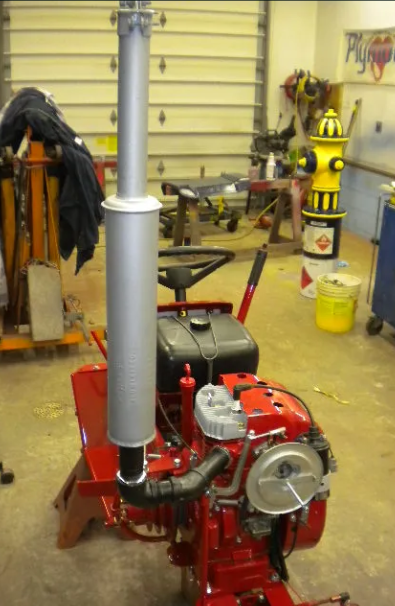

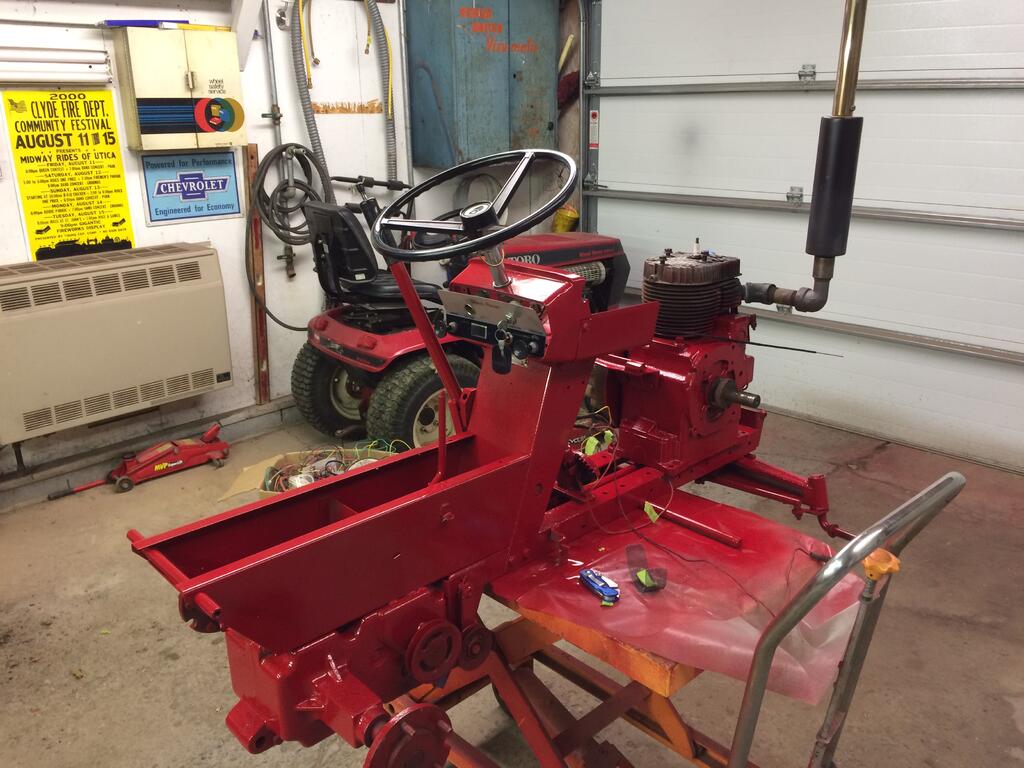

TJ5208 1,841 #21 Posted September 29, 2022 (edited) Would someone post some pics of there stacks on a 14 hp Kohler with the same setup as in post #1 or in post #19. Edited September 29, 2022 by TJ Salyers Share this post Link to post Share on other sites
TJ5208 1,841 #24 Posted September 29, 2022 (edited) 2 hours ago, squonk said: How does it look? Edited September 29, 2022 by TJ Salyers 1 Share this post Link to post Share on other sites
squonk 48,141 #25 Posted September 29, 2022 (edited) 17 minutes ago, TJ Salyers said: How does it look? Just like the other pic I sent. Just a different tractor and a smaller muffler. Edited September 29, 2022 by squonk 1 Share this post Link to post Share on other sites
