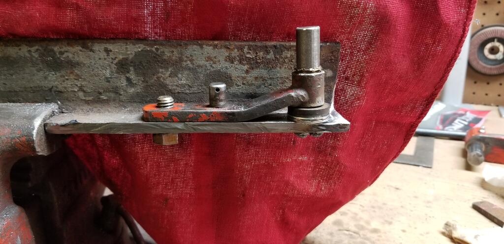

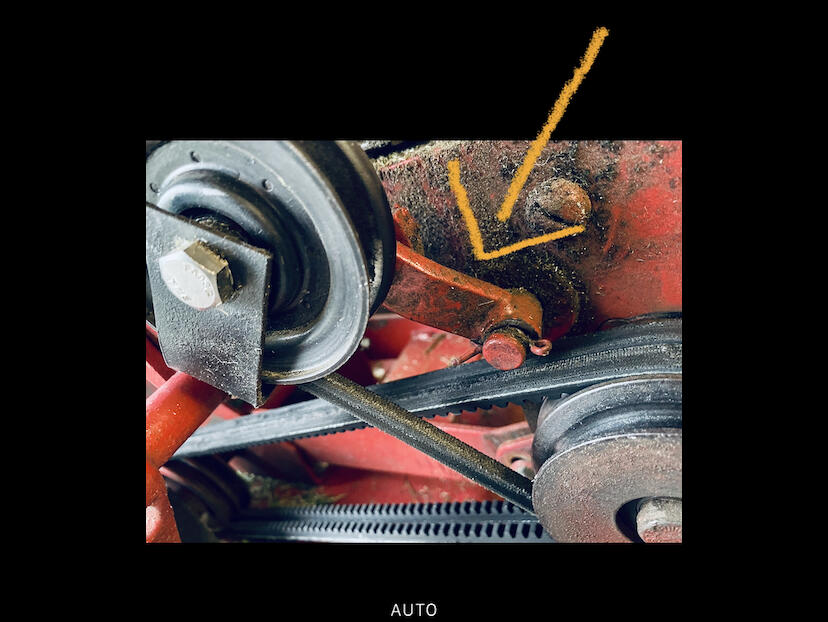

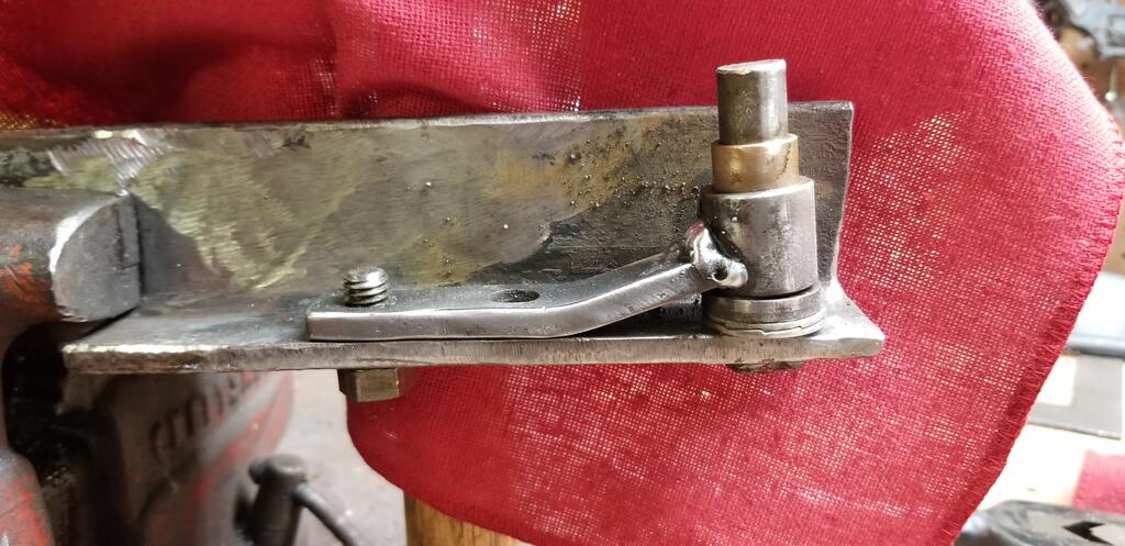

656_tractor 14 #1 Posted September 25, 2022 (edited) Hey guys. I’m getting to know this mower a lot better thanks to this forum. The metal part that goes to an idler pulley that turns my mower deck belts looks like it’s a bit worn out and slides or angles to the outside of the mower a little too much. I think this is miss aligning the pulley and it could be better aligned. Any ideas what thus part is called? I might want to get that spring maybe a new one too but may be tighter Edited September 25, 2022 by 656_tractor 1 Share this post Link to post Share on other sites
Pullstart 70,706 #2 Posted September 25, 2022 That looks like it could easily benefit from a brass bushing to tighten things up in there! Most springs on these tractors can be obtained at an ACE or similar hardware store. Just bring what you can to the store and look through their selection for options. 2 Share this post Link to post Share on other sites
656_tractor 14 #3 Posted September 25, 2022 (edited) Oh. I see yes that could be done.. the bushing. I think the metal part is worn out tho. And maybe they make it and i could replace that? Will do , on the ace hardwAre. Good idea! Edited September 25, 2022 by 656_tractor Share this post Link to post Share on other sites
Pullstart 70,706 #4 Posted September 25, 2022 You could try building it up and filing it back in, if you don’t have access to fabrication tools like welders, mills and grinders. PC7 is super hard and easily workable. 1 Share this post Link to post Share on other sites
Ed Kennell 46,590 #5 Posted September 25, 2022 That can be bushed to restore both worn parts. Bore out the lever to a nice siding fit with a standard bushing OD. Epoxy the bushing to the shaft. 3 Share this post Link to post Share on other sites
ri702bill 12,481 #6 Posted September 25, 2022 Not too much meat on the arm - need a very thin-walled bushing... Share this post Link to post Share on other sites
peter lena 9,942 #7 Posted September 26, 2022 @656_tractor have a picture or reference to that arm to mount point ? was thinking about a flange bearing conversion . set up has to be replaced anyway , break down function , would let you do a solid job . you can't do that pete Share this post Link to post Share on other sites

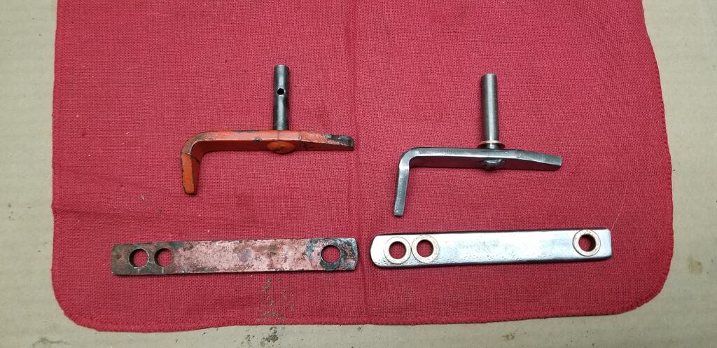

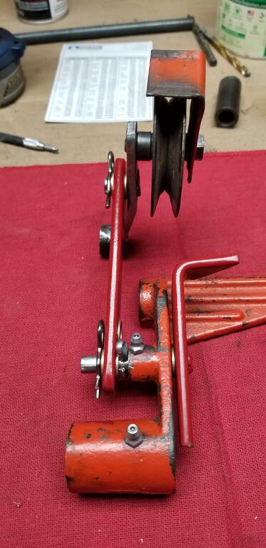

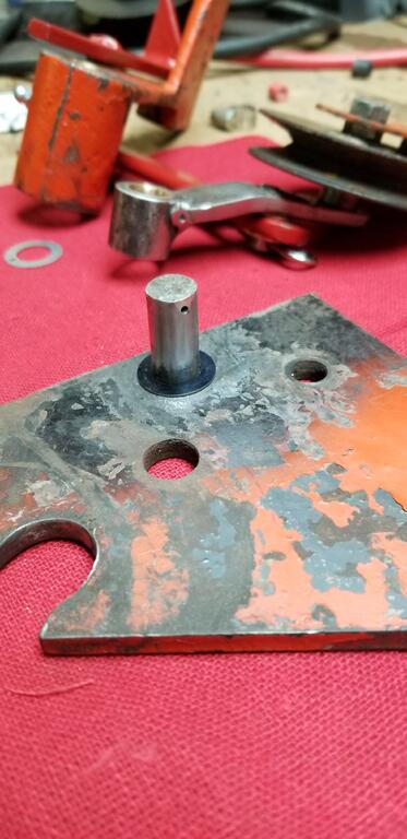

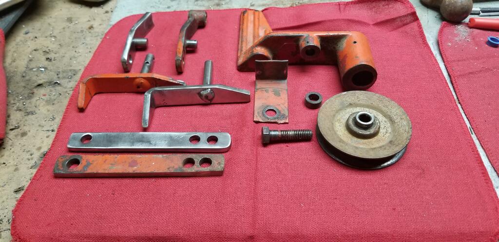

gt14rider 1,242 #8 Posted September 27, 2022 Made a jig to make arm, put bushings and replaced pins Share this post Link to post Share on other sites
