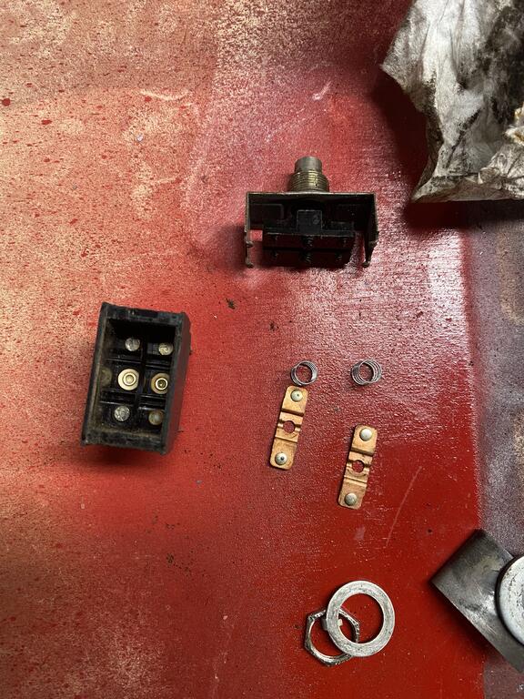

Heatingman 941 #1 Posted September 24, 2022 Pretty sure my pto safety switch is bad. Ive redone all the connections, and it even ohms out fine on the bench, but when under load it fails to send power to the ignition coil intermittently. If I use the seat switch for the ignition coil circuit, it works fine. Its a dpst normally open momentary button switch. Cant seem to locate one. Share this post Link to post Share on other sites
Heatingman 941 #2 Posted September 25, 2022 (edited) Did find Toro still offers the switch for the low low price of 105 bucks. Part 104680 I took the switch apart, cleaned the contact points, put it back together and got it working again. Edited September 25, 2022 by Heatingman 2 1 Share this post Link to post Share on other sites
