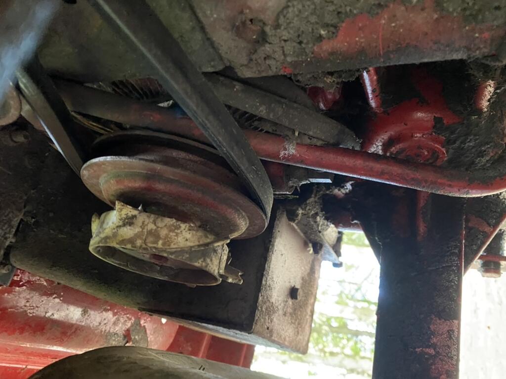

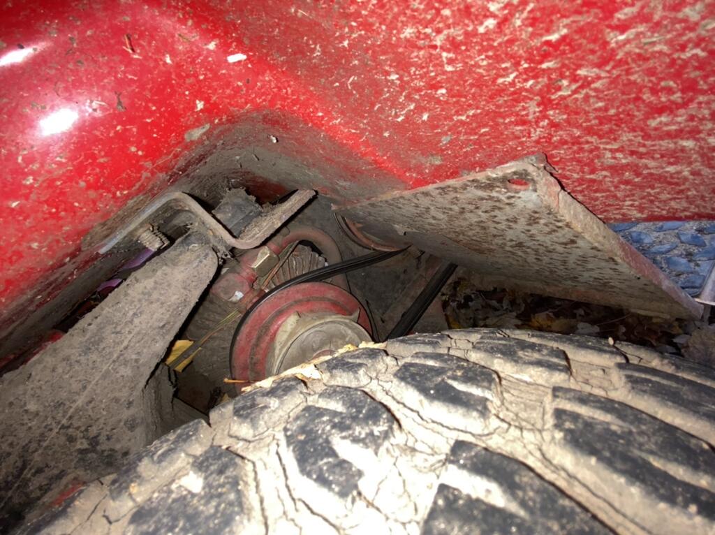

JerryLook 84 #1 Posted September 24, 2022 I was cleaning under the tractor today and noticed my hydro fan is missing most of the blades. I’m in upstate NY and don’t use the tractor in warm weather very often. Is this fan important for normal operation? I assume they wouldn’t have put it there if it wasn’t necessary. Is it easy to change out? Looks like if I take the rear wheel off I’d have good access to the fan. I haven’t cleaned this area since I’ve owned the tractor. It might have been like this when I got it. 1 Share this post Link to post Share on other sites

pfrederi 21,049 #3 Posted September 24, 2022 It is whats left of the cooling fan WH # 108393 Also you should clean the fins on the hydro... 3 Share this post Link to post Share on other sites
JerryLook 84 #4 Posted September 24, 2022 Awesome. Thanks for the info. And part number. Looks like the fan is about 25$. Not bad at all. Hopefully I can just pull the center bolt out and the fan will come right off. Share this post Link to post Share on other sites
Handy Don 17,316 #5 Posted September 24, 2022 56 minutes ago, pfrederi said: It is whats left of the cooling fan WH # 108393 Also you should clean the fins on the hydro... ... and YES the fan (along with clean hydro fins) is important. Hydros generate a fair amount of heat from the fluid friction inside. BTW the screw holding the fan is a righty tighty-lefty loosey! Share this post Link to post Share on other sites

lynnmor 9,012 #8 Posted September 25, 2022 Just one bolt in the center holds it. That bolt will be clamping down on the plastic fan so you shouldn’t make it extremely tight, so use threadlocker to keep it tight. Share this post Link to post Share on other sites

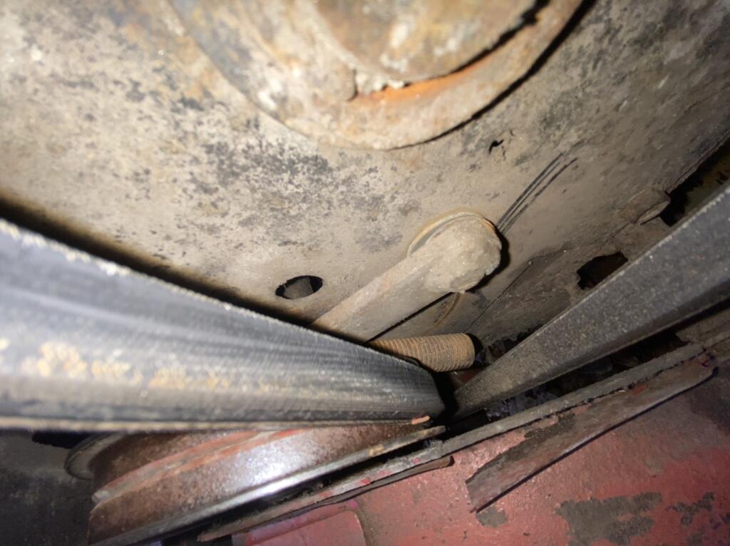

JerryLook 84 #14 Posted October 20, 2022 The spring for the tensioner pulley is broken. I noticed it while looking at the fan again. The mower still drives, but it would probably help to have a new spring. Does it hook into the hole below the dangling spring in pic number 2? Any idea what size spring I need? I’m missing half of mine Share this post Link to post Share on other sites

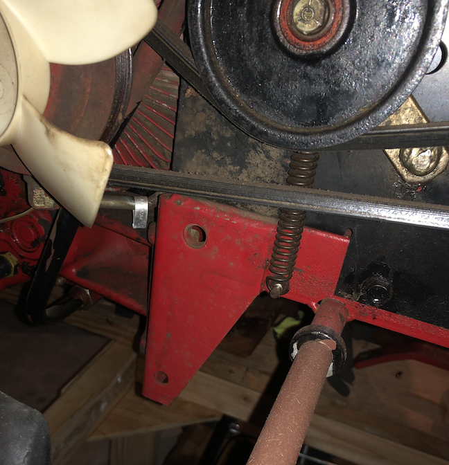

Handy Don 17,316 #15 Posted October 20, 2022 (edited) Mine attaches here to a bolt through the frame with a hole drilled through its end for the spring to thread through. (520-H) Edited October 20, 2022 by Handy Don 1 Share this post Link to post Share on other sites
JerryLook 84 #16 Posted October 20, 2022 Ok thanks. I’ll look and see if I have that same bolt. I was curious how much tension was on the spring. Looking at yours, it looks like it’s pulled pretty tight. I might have a spring in my stash that will work. Share this post Link to post Share on other sites
JerryLook 84 #17 Posted October 22, 2022 Ok I found a spring to replace mine. Also after seeing your pic @Handy Don I know how to get access to that area now. Thanks. My 416 does have the same stud your 520 has. I had to remove the tensioner pulley to get the spring off, and new one on. Do you guys oil the pulleys at all? There is no grease fitting on it. I was thinking about oiling it with some light motor oil. 1 Share this post Link to post Share on other sites
