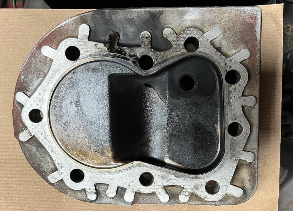

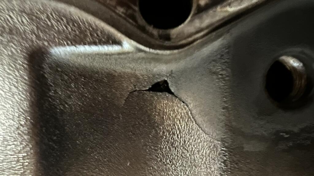

davidfindlay 51 #42 Posted September 25, 2022 I was lucky and the head came off easily. I’m guessing this hole shouldn’t be here… 2 Share this post Link to post Share on other sites
squonk 48,322 #43 Posted September 25, 2022 Nope that hole shouldn't be there. It's repairable if you can find someone who welds aluminum. I have that head available. PM me for details 1 Share this post Link to post Share on other sites
ineedanother 2,885 #44 Posted September 25, 2022 48 minutes ago, davidfindlay said: I was lucky and the head came off easily. I’m guessing this hole shouldn’t be here… No, and if that head gasket was leaking where it is damaged, it might have contributed to the failure of the head. 2 Share this post Link to post Share on other sites
Heatingman 977 #45 Posted September 26, 2022 11 hours ago, davidfindlay said: I was lucky and the head came off easily. I’m guessing this hole shouldn’t be here… You might try this: https://www.jbweld.com/product/j-b-extremeheat 1 Share this post Link to post Share on other sites
OoPEZoO 630 #46 Posted September 26, 2022 That is almost identical to the failure I had earlier this year. Also a blown head gasket......pretty sure it had been that way for awhile, but I had been choosing to ignore it. Tractor used to start acting up after about an hour of mowing. Pretty sure it was sucking air in and running super lean. Then one day.....it got real loud, real fast. Thats when it popped the hole in the head. All is well now with a replacement head, but still kicking myself for ignoring it as long as I did. t 2 Share this post Link to post Share on other sites
davidfindlay 51 #47 Posted September 26, 2022 I bought squonk’s spare head and I just ordered the gasket from Lincoln at A-Z just now. Thanks again for the help everyone. 1 3 Share this post Link to post Share on other sites
