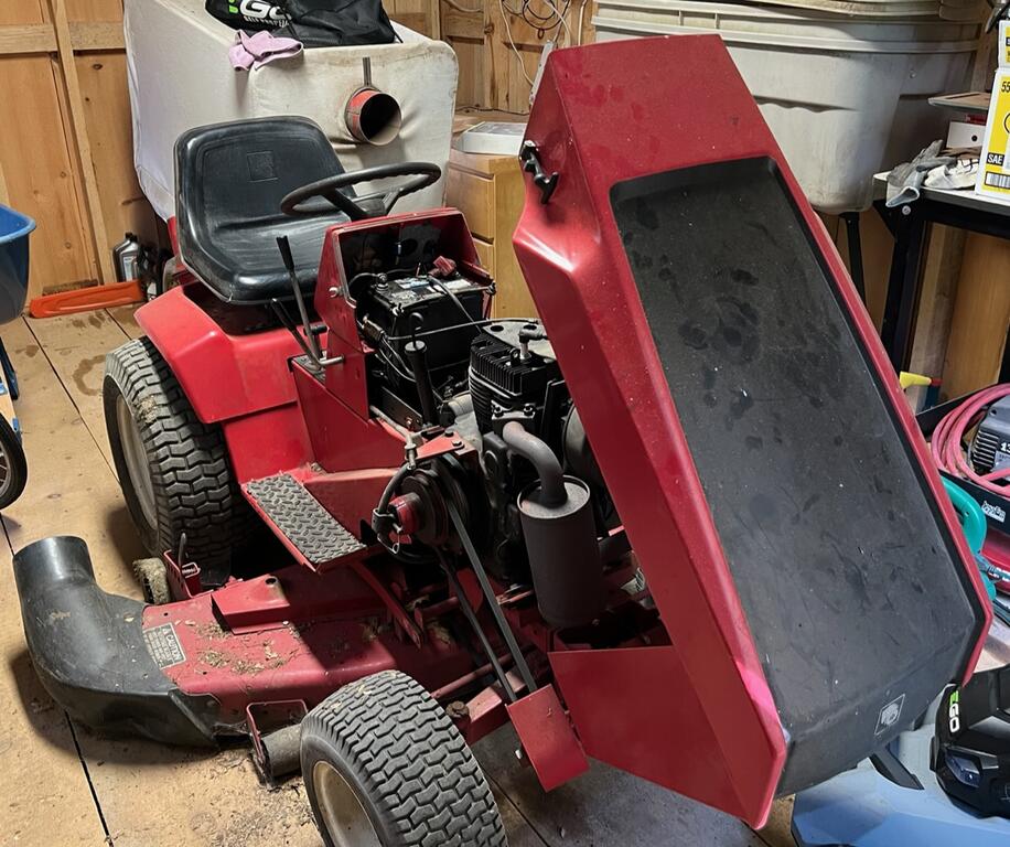

davidfindlay 51 #1 Posted September 23, 2022 (edited) My 1984 B Series has been underpowered lately and I just noticed this when I ran it with the engine exposed. Any suggestion as to what I can do about it? FullSizeRender.MOV Edited September 23, 2022 by davidfindlay Hadn’t finished typing 1 1 Share this post Link to post Share on other sites
Heatingman 977 #2 Posted September 23, 2022 (edited) You need a new head for that motor. With a breach in the head, you wont develop much compression, and inturn low power. If you can weld, that may buy you some time, but no guarantee. Edited September 23, 2022 by Heatingman 4 Share this post Link to post Share on other sites

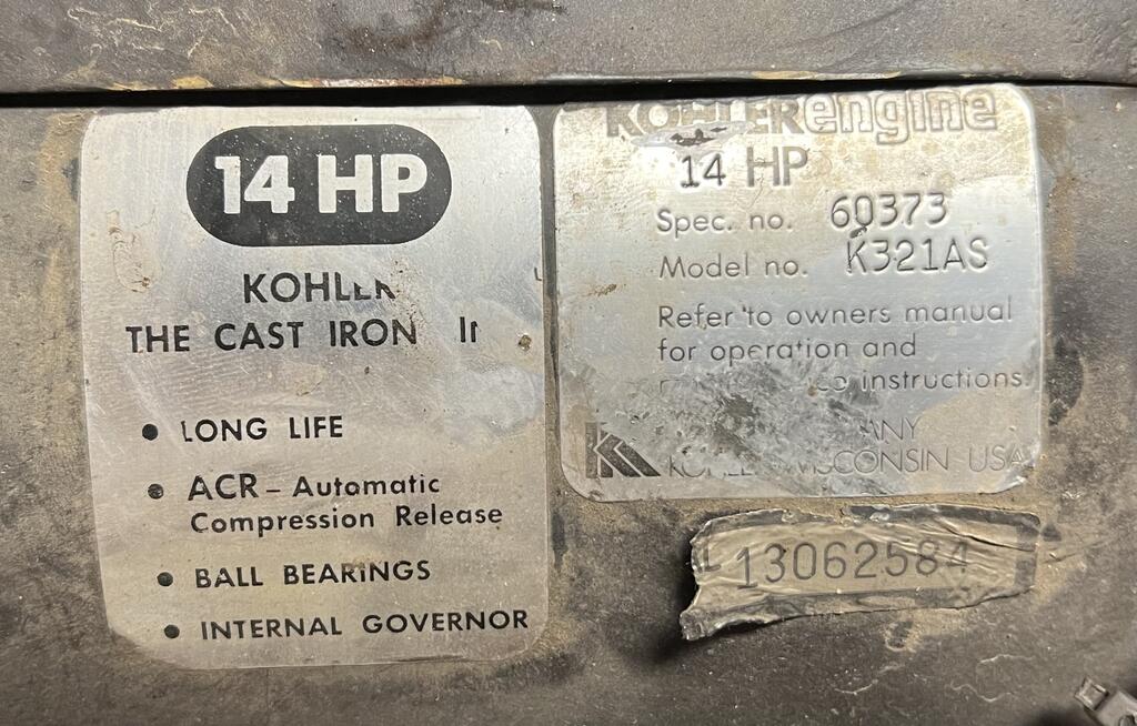

ebinmaine 81,139 #3 Posted September 23, 2022 6 hours ago, davidfindlay said: 1984 B Series That looks like a Tecumseh engine. Wouldn't have been used in either a B series which was 1974-77 with a horizontal shaft... Or a 1984 anything. Do you have model numbers of the tractor or engine? 4 hours ago, Heatingman said: You need a new head for that Could the head be warped enough and/or the gasket blown out to cause that? Share this post Link to post Share on other sites

davidfindlay 51 #6 Posted September 23, 2022 (edited) Thank you for all the replies. It didn’t occur to me to mention which engine it was when I posted last night, sorry. Edited September 23, 2022 by davidfindlay Image 1 Share this post Link to post Share on other sites
ebinmaine 81,139 #7 Posted September 23, 2022 3 minutes ago, davidfindlay said: Thank you for all the replies. It didn’t occur to me to mention which engine it was when I posted last night, sorry. That's not the same engine as what's in the video that my phone downloads... Irregardless to that. Have you had the head off? Check the cylinder head gasket? Hand planed the cylinder head? 1 Share this post Link to post Share on other sites

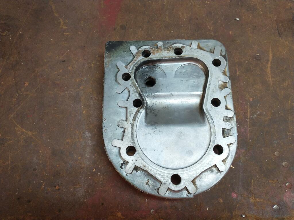

95 Truck 17 #25 Posted September 23, 2022 After watching video and seeing where the lighting show is taking place, then looking at head posted, you sir will need the head offered up. It looks to be cracked or burned thru. As some else said it will explain your low on power statement. 2 Share this post Link to post Share on other sites
