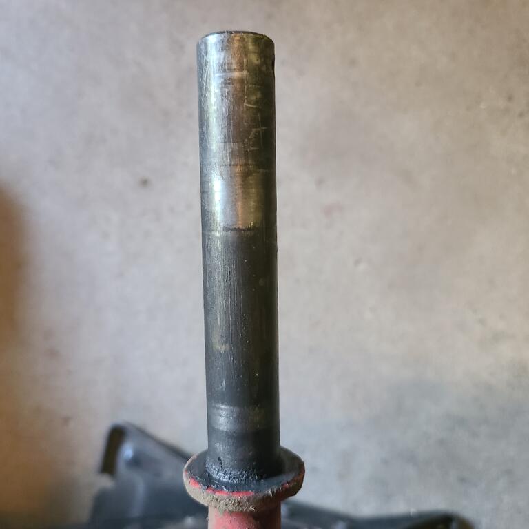

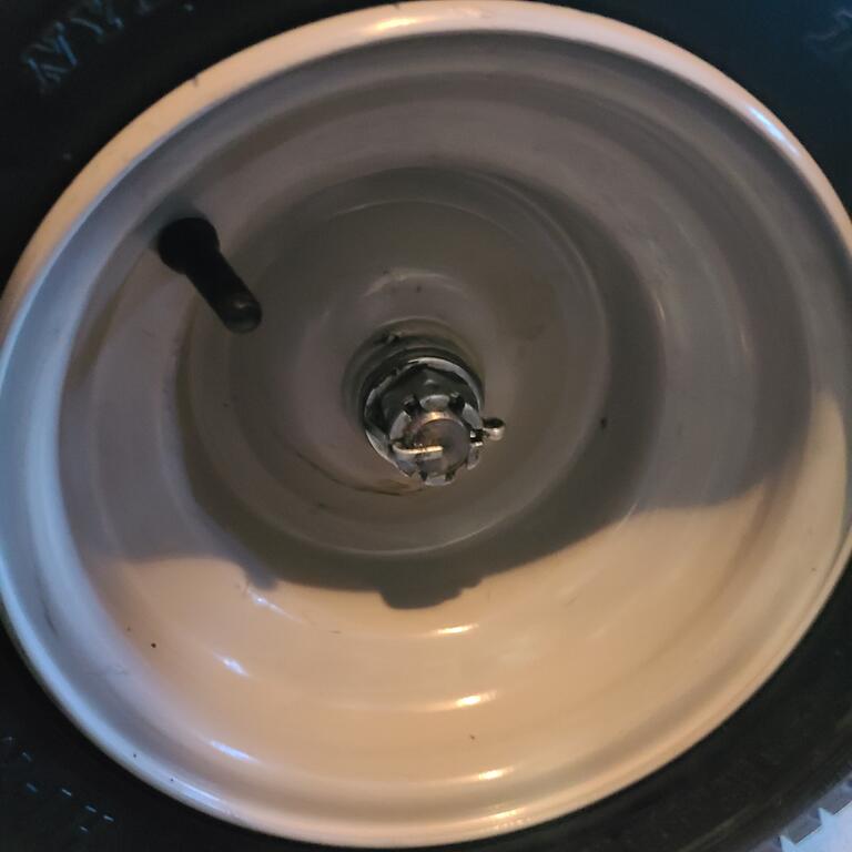

PapR's312-8 9 #1 Posted September 21, 2022 About a week ago I had decided to go with 8" rims on my 312-8. I had the idea to die-cut threads on the end of the axles then use castle nuts with cotter keys. I think it has gone well. Although my second nut seems to have an issue with the starter threads. I'll chase them out or get a new nut. Let me.know your thoughts. 2 5 Share this post Link to post Share on other sites
TJ5208 1,841 #2 Posted September 21, 2022 (edited) That is a neat idea. Good job. I always wondered why the put they smaller tires on the front. Edited September 21, 2022 by TJ Salyers 1 Share this post Link to post Share on other sites
ebinmaine 81,046 #3 Posted September 21, 2022 Nice looking work there. 2 Share this post Link to post Share on other sites
SylvanLakeWH 32,776 #4 Posted September 21, 2022 1 hour ago, ebinmaine said: Nice looking work there. x2! 2 Share this post Link to post Share on other sites
ri702bill 13,271 #5 Posted September 21, 2022 (edited) Welcome - nice work. Not the easiest thing to cut a 3/4" fine thread using a die by hand. Two things come to mind - it is almost impossible to get a clean die engagement if the end of the spindle is not chamfered or undercut first. ( you can afford to loose that first thread anyway) And, you need a sharp die with a decent cutting oil - along with steady hands.... Bill Edited September 21, 2022 by ri702bill added note 4 Share this post Link to post Share on other sites
Pullstart 71,482 #6 Posted September 21, 2022 and great work @PapR's312-8! 1 Share this post Link to post Share on other sites

PapR's312-8 9 #12 Posted September 21, 2022 10 hours ago, TJ Salyers said: That is a neat idea. Good job. I always wondered why the put they smaller tires on the front. Thank you. I do like the look as well of extra ground clearance Share this post Link to post Share on other sites
PapR's312-8 9 #13 Posted September 21, 2022 4 hours ago, ri702bill said: Welcome - nice work. Not the easiest thing to cut a 3/4" fine thread using a die by hand. Two things come to mind - it is almost impossible to get a clean die engagement if the end of the spindle is not chamfered or undercut first. ( you can afford to loose that first thread anyway) And, you need a sharp die with a decent cutting oil - along with steady hands.... Bill How right you are about the chamfer. It took a while to get it going. Once I did it went well. My die is from a Harbor Freight set. It has been hardly used so was quite sharp. I just used some motor oil I had in a old pump can. Seemed to be fine. 2 Share this post Link to post Share on other sites
kpinnc 19,036 #14 Posted September 22, 2022 On 9/20/2022 at 10:52 PM, PapR's312-8 said: I had the idea to die-cut threads on the end of the axles then use castle nuts with cotter keys. Those look great! Share this post Link to post Share on other sites
