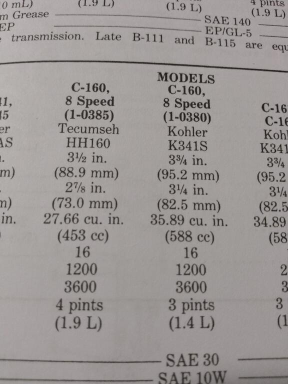

TJ5208 1,841 #39 Posted September 21, 2022 One reason I don't like Tecumseh they don't even make the horsepower there rated at. Compare both of the 160s and you'll see why. 2 Share this post Link to post Share on other sites

ebinmaine 81,139 #44 Posted September 21, 2022 10 minutes ago, TJ Salyers said: One reason I don't like Tecumseh they don't even make the horsepower there rated at. Compare both of the 160s and you'll see why. I don't see ... They both make 16. 3 Share this post Link to post Share on other sites
TJ5208 1,841 #45 Posted September 21, 2022 2 minutes ago, ebinmaine said: I don't see ... They both make 16. The piston displacements are way different. Share this post Link to post Share on other sites
ebinmaine 81,139 #46 Posted September 21, 2022 Just now, TJ Salyers said: The piston displacements are way different. Absolutely true. The Tecumseh is an overhead valve engine. It makes the same amount of HP with less displacement. It is less torque. But HP is identical. For the size ... the Tecumseh is pretty stout. 3 1 Share this post Link to post Share on other sites

Achto 32,923 #48 Posted September 21, 2022 Just now, TJ Salyers said: 4 minutes ago, ebinmaine said: The piston displacements are way different. While I'm a firm believer in "There's no replacement for displacement" It is not untrue that you can just as much Horse Power out of a Honda 2.2L engine as you can out of a Chev 5.7L engine. Torque may be a different story. 2 Share this post Link to post Share on other sites
TJ5208 1,841 #49 Posted September 21, 2022 Just now, Achto said: While I'm a firm believer in "There's no replacement for displacement" It is not untrue that you can just as much Horse Power out of a Honda 2.2L engine as you can out of a Chev 5.7L engine. Torque may be a different story. So this mean I'm wrong? Share this post Link to post Share on other sites
Achto 32,923 #50 Posted September 21, 2022 1 minute ago, TJ Salyers said: So this mean I'm wrong? Both the Techy and the Kohler produce 16hp according to the manufacturers. Torque may be different though. 1 Share this post Link to post Share on other sites
