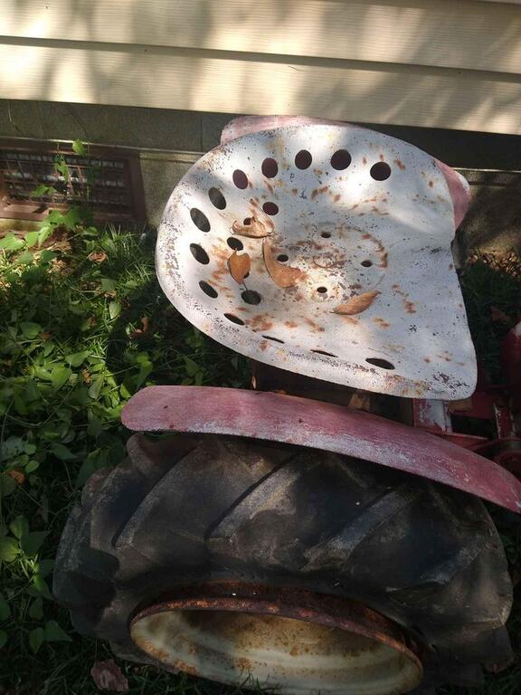

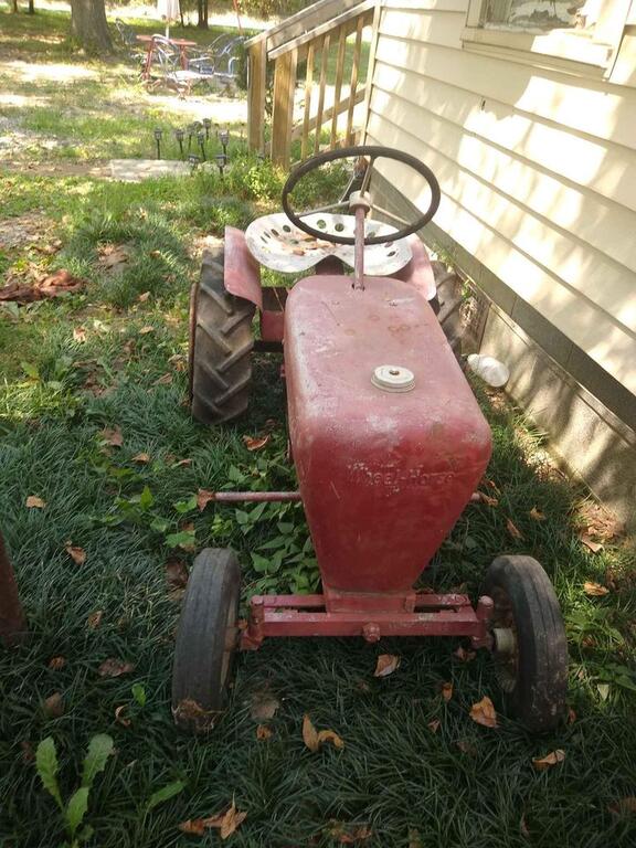

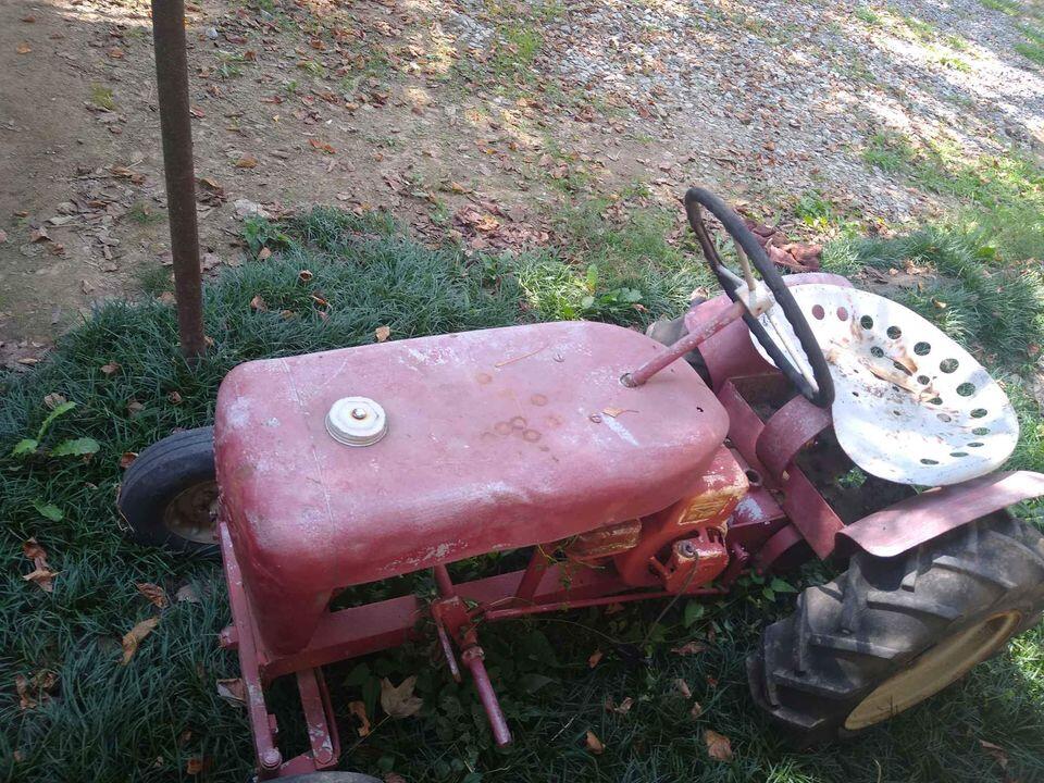

Sailman 1,307 #1 Posted September 19, 2022 Have a possible shot at purchasing this "mystery" RJ but confused on the actual year. Looks like some mixed parts. Any suggestions from you RJ experts would be appreciated and $$ value as it sits. 1. It has the "original" Briggs 2.5 HP engine but pull starter parts needs replacing. Also the "coil" is broken and needs repair or replace. He claimed it ran fine.....? 2. I don't see a motion control lever on the right hand side. But it looks like it has a gear box with the shifter missing. He used a long screw driver to engage the gears....??? He has no idea if it has a gear pattern. Didn't think early RJ had a gear box. 3. Doesn't look like it has a lift mechanism which is no big deal for me. Don't need it. 4. It does have the wheelhorse stamped in the hood and appears to have gas cap on top of hood. 5. I don't see any throttle or kill button. 6. Tires are dry rotted. 7. Looks like a brush paint job. I am not interested in a perfect year accurate. Just something I can get running for the grand kids. Looks like a mishmash of year parts. Whats it worth? May go by to see it tomorrow. THANKS! 1 2 Share this post Link to post Share on other sites
wallfish 20,576 #2 Posted September 19, 2022 It's an RJ58 There's a gear box trans with the shifter missing That 2.5 briggs isn't original. That would an RJ25 so he probably got his info wrong. K90 K91 or Clinton B1290 is original He's got an extra pulley added under the engine for some reason ? Missing the belt guard. These aren't the greatest tractor for young kids. Too easy to burn themselves on the engine. Plus they can pop up pretty good in third gear. A teenager - maybe 6 1 Share this post Link to post Share on other sites

953 nut 69,161 #4 Posted September 20, 2022 Go ahead and buy the RJ for yourself and then find a Lawn Ranger for the grandkids. Put a wanted ad in the classifieds for a "Grandkids Special" and you'll probably find a good candidate. 11 hours ago, Sailman said: He claimed it ran fine. Now there is an oldie but goodie line. I have had lots of sellers try to convince me that "it just needs a little tuning"! With the gear box being open like that it is bound to have water and dirt inside, gear box rebuild Engine is not correct and probably would be best to replace it in the long run Replacement tires ain't cheap Probably looking at $ 500 or more depending on your skill level to make it operable. The hood, fenders and seat look good in the pictures, Just depends on how much you want a project. 1 1 Share this post Link to post Share on other sites
