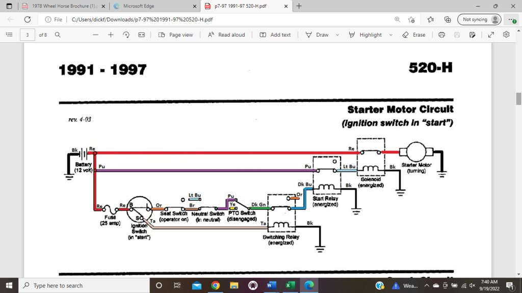

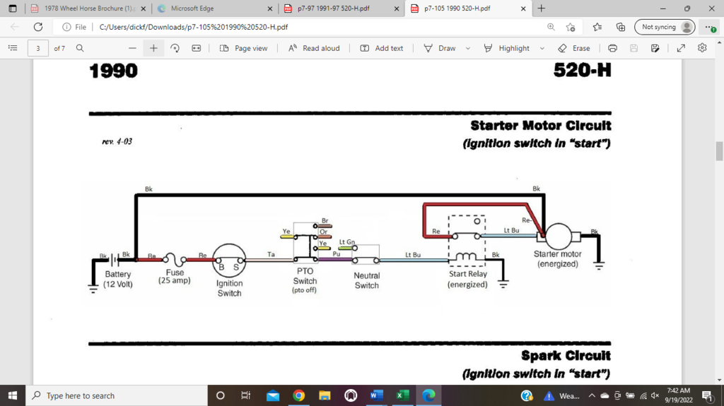

gwest_ca-(File Mod) 12,461 #6 Posted September 19, 2022 These wiring diagrams are from the 523 page Demystification Guide. Each major circuit has it's own diagram and that simplifies diagnosis but you need to download the file to get them. I do not know the difference between 1990 and 1991-97. Click on the picture in each link and the page that comes up can be enlarged for a preview. Pretty sure 1990 and newer had the special front axle. The starter diagram shows what needs to happen for it to work. 3 Share this post Link to post Share on other sites

gwest_ca-(File Mod) 12,461 #21 Posted September 21, 2022 Start relay should be #85 dark blue - should have power with ignition switch in start position #30 purple - should have power at all times #86 black ground #87 light blue - should have power with ignition switch in start position but power coming from #30 purple Conclusion - the dark blue and purple may be reversed 1 Share this post Link to post Share on other sites
Handy Don 17,319 #22 Posted September 21, 2022 2 minutes ago, gwest_ca said: Start relay should be #85 dark blue - should have power with ignition switch in start position #30 purple - should have power at all times #86 black ground #87 light blue - should have power with ignition switch in start position but power coming from #30 purple Conclusion - the dark blue and purple may be reversed Garry, I'm not familiar with the numbering you reference. Where is that documented? 1 Share this post Link to post Share on other sites

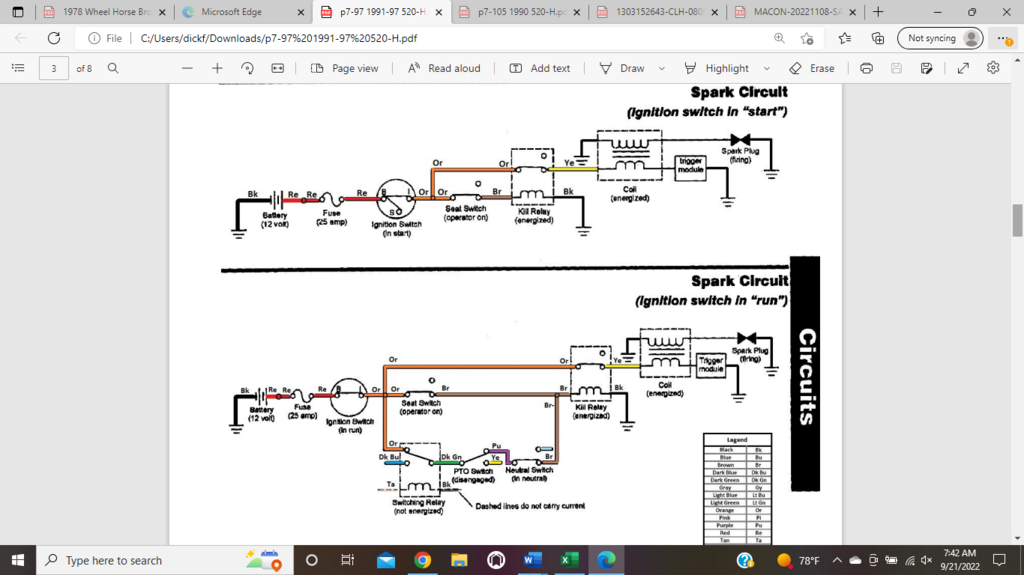

gwest_ca-(File Mod) 12,461 #23 Posted September 21, 2022 Click on the pictures to enlarge Share this post Link to post Share on other sites
Handy Don 17,319 #24 Posted September 21, 2022 (edited) 1 hour ago, gwest_ca said: Conclusion - the dark blue and purple may be reversed If these were reversed, wouldn't the Start Relay be energized at all times, regardless of ignition switch position? In that case, simply switching the ignition switch to "On" would put power through the blue wire and energize the Start Solenoid to crank the engine. And thanks for the Relay docs! Edited September 21, 2022 by Handy Don Share this post Link to post Share on other sites
gwest_ca-(File Mod) 12,461 #25 Posted September 21, 2022 The START terminal on the ignition switch only powers the coil in the switching relay which closes the contacts. Now the IGNITION terminal on the ignition switch powers the dark green #30 on the switching relay and since it is now closed passes power to the #85 dark blue on the start relay. The START key position requires both the IGNITION and START terminals to be powered at the same time for the starter to work. 1 Share this post Link to post Share on other sites
