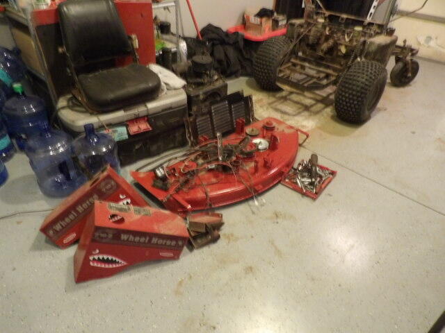

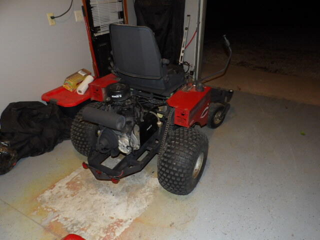

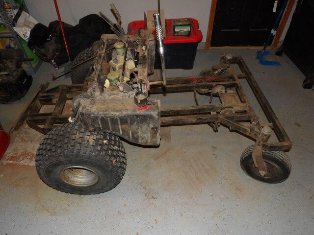

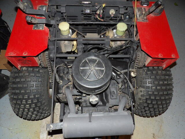

Snoopy11 5,731 #107 Posted November 22, 2022 Parts... Wiring of the tractor in a nutshell... I will probably pull the machine out and wash it down when the hose isn't frozen... Don 3 2 Share this post Link to post Share on other sites

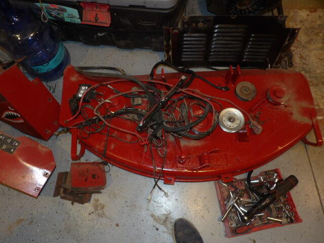

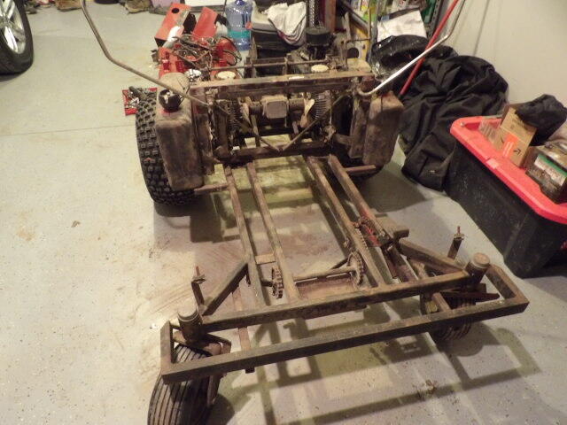

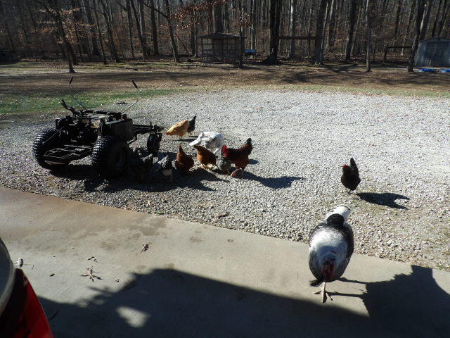

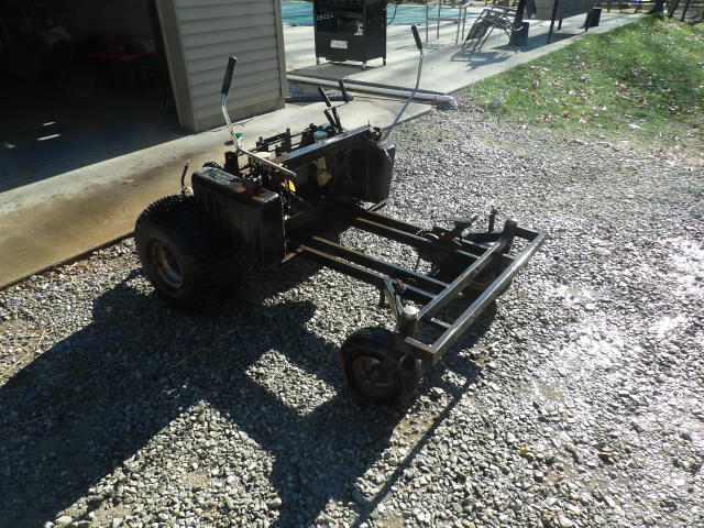

Snoopy11 5,731 #109 Posted November 22, 2022 This morning, I got the machine sanded, rinsed, and it is currently sitting out drying off. Amazing how much dirt and grime that got rinsed and scrubbed off... At some point, possibly later today, I will pull the tires off and coat the frame in Rustoleum high temp paint. Don 5 1 Share this post Link to post Share on other sites

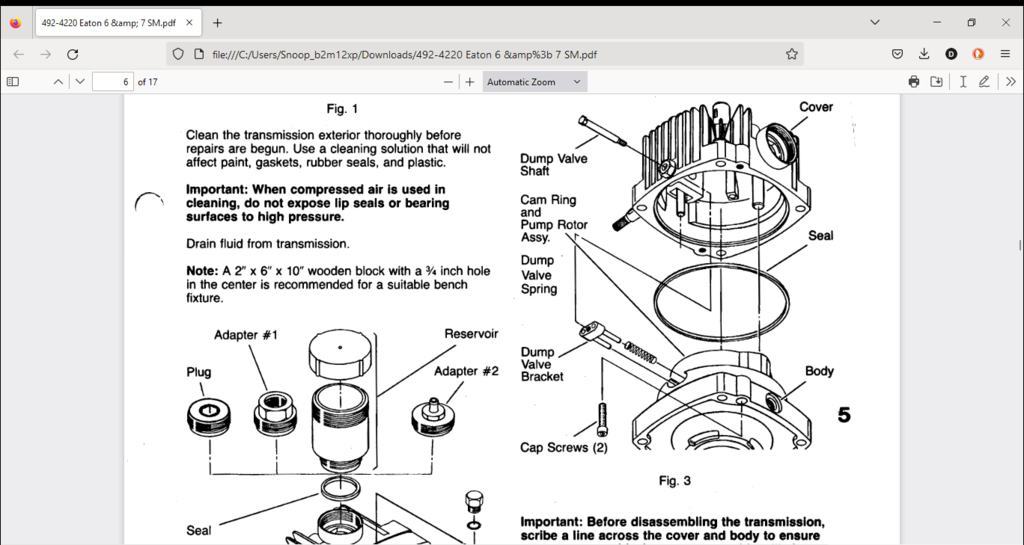

Snoopy11 5,731 #112 Posted November 22, 2022 (edited) The only thing I wish I knew about this machine was if there is a release for the hydro units so the machine can actually roll... my arms are getting tired of picking up the back end to roll it around... EDIT: I know from my other hydro units, they have a 'dump valve' After reviewing the Eaton service manual... it would appear to me that my hydro units indeed have dump valves that disconnect the transmission from the pumps so the unit can be pushed without running. Now, how exactly to use that feature on these Eaton transmissions, I have no clue... Don Edited November 22, 2022 by Snoopy11 1 Share this post Link to post Share on other sites

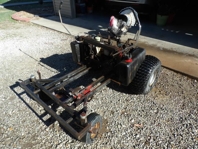

The Freightliner Guy 1,364 #113 Posted November 22, 2022 does ms or mr turkey have a bunker they hide in whenever thanksgiving is close? 3 Share this post Link to post Share on other sites
Snoopy11 5,731 #114 Posted November 22, 2022 Just now, The Freightliner Guy said: does ms or mr turkey have a bunker they hide in whenever thanksgiving is close? Their funny farm president pardoned them... Don 1 2 Share this post Link to post Share on other sites

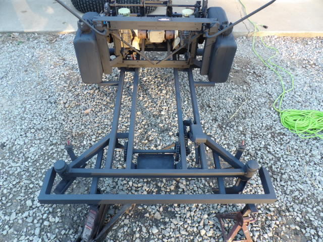

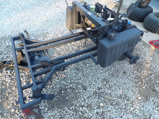

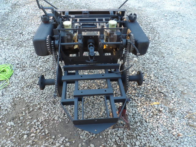

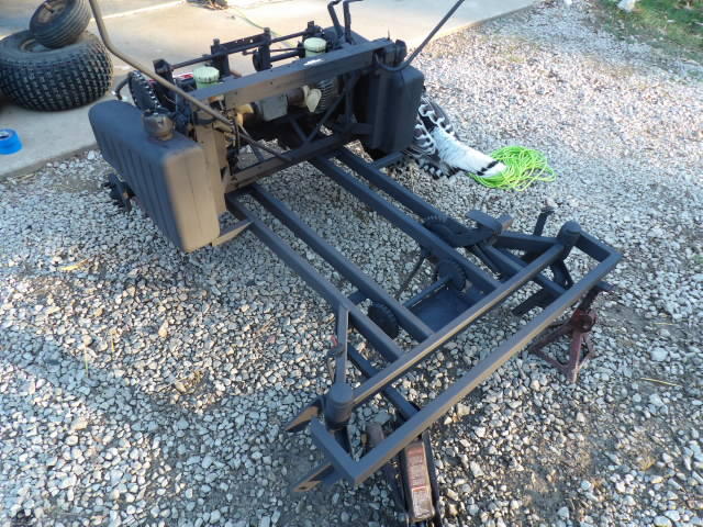

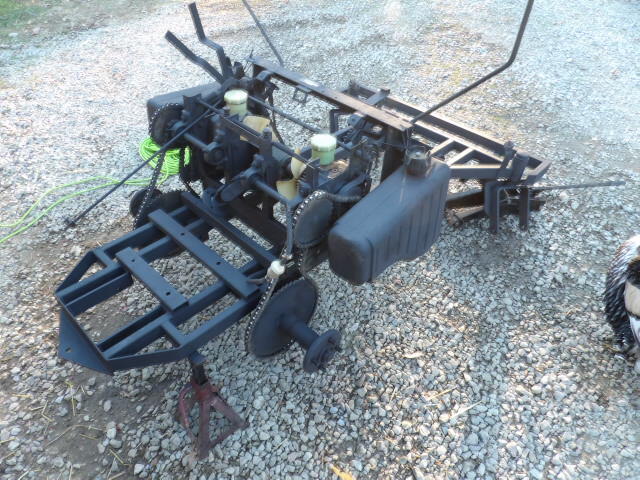

Snoopy11 5,731 #115 Posted November 22, 2022 Fumed the frame... and cooked dinner... Lil' bit of tractor porn... Zero rust on the machine at this point... Don 2 1 Share this post Link to post Share on other sites

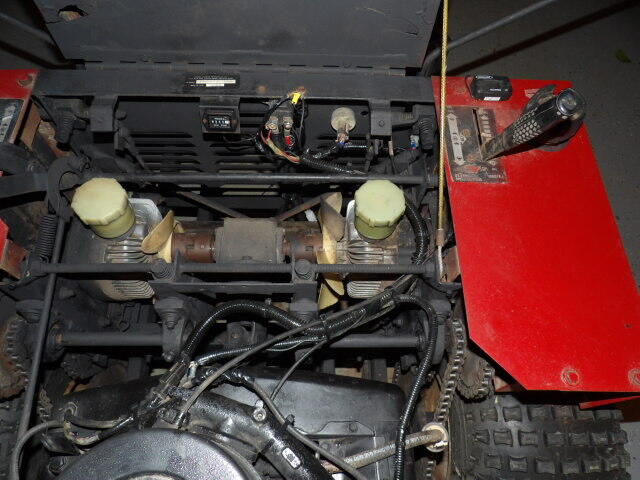

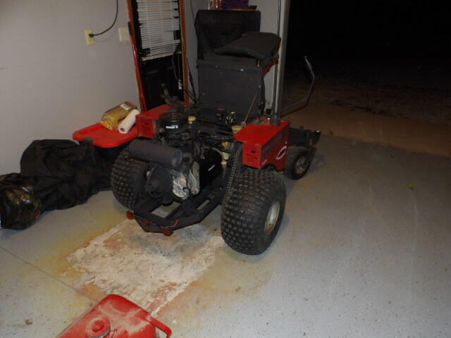

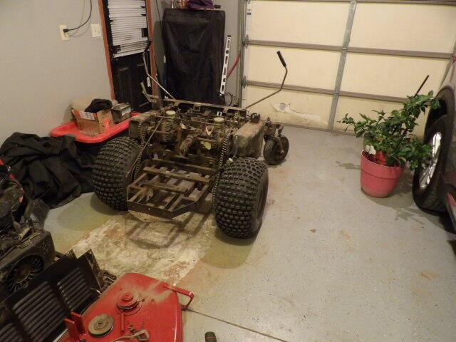

Snoopy11 5,731 #123 Posted November 24, 2022 Between last evening and this evening... Wiring is bossily clean... Don 4 Share this post Link to post Share on other sites
Snoopy11 5,731 #124 Posted November 24, 2022 Putting the driveshaft back on the engine was not quite as hard as putting a mechanical fan back on a Ford Ranger engine... but for whatever reason... putting the driveshaft on this machine's engine was much more painful. I plan to retighten the bolts on the driveshaft 1 more time. Wiring-wise... this machine had very... VERY crappy grounding. Basically, 1 ground in front of frame grounded the whole machine. Now, this machine has ground to starter solenoid bolt (which also grounds other items)... and a ground to engine. New ground to chassis wire as well. I won't get much done on this machine tomorrow... going to spend some quality time with the family. I still have to repack idler pulley bearings, grease all the points on the machine, put the new belt on the deck, mount the deck, consolidate the wiring for the lighting system, and button up other odds and ends. Then, once my 2 surprise parts come, (should come by the weekend, but we shall see)... I will have to work on that. Don 1 2 Share this post Link to post Share on other sites
